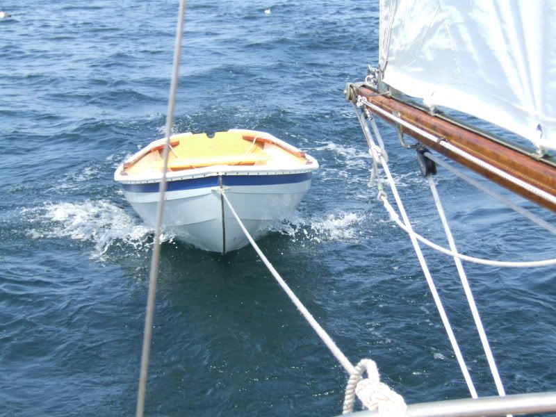

    I'm quite happy with the way my 8'-6' Puffin tows. It does squat but I've towed it through some very ugly stuff (over 6200 nm) and never worried about it joining me in the cockpit or flipping.
    The two models are both outside Hamilton Marine in Portland and the 10 footer has a much flatter run. It appears to be optimized for planing with an outboard motor.
    I think some tuck in the run to pull the stern down is an essential feature for good towing in rough water.

    Default Re: Want to build a dinghy, easy towing is priority..recommendations?
    Quote Originally Posted by preserved_killick View Post
    The Puffin is indeed very stable in all conditions.
    Here's a picture of the Puffin towing at a bit over 6 knots.
    The trim angle looks extreme but I've seen plenty of dinghies planing under sail with this kind of trim angle as well as outboard boats. I can pull the painter up short at this speed, it's a bit of work but it can be done. You can feel a significant difference in drag as you pull the dinghy to different places on the stern waves. I lose about 1/4 knot towing the dinghy at this speed. It's not significantly different from this flatter run dinghy I used to have.

    Rodger, that looks just like my dinghy! Tom3, fantastic photo! There's just something about prams that just don't look quite right to me, useful as they are. Is that your boat? If my boat looked that good I wouldn't care what my dinghy looked like!
    Is that your boat?
    Yes.

    I'm a coastal sailor as well, anchoring nearly every night and always tow my dinghy (6200 nm so far this year) . The times I've gotten caught have almost always come up so quickly that the last thing I would want to be doing is fooling around singlehanded trying to get the dinghy alongside to add a drogue or weight. Dinghy threatening conditions are usually a combination of wind, tidal action, and shallow water. They usually can be foreseen but I would find myself rigging for hard towing many times that it wasn't necessary. It would only take not doing it once in the wrong conditions to loose the dinghy or have it crash into my wind vane.
    My dinghy costs me less than a quarter knot towing at maximum speed and less at normal cruise. An easier towing dinghy might cut that in half but it's worth it to me not to have to worry about what's going on behind me in one of the nasty spots I encounter often.
    True enough and I followed your travels so you have good experience with your dinghy.
    Our first pram was 8' and worked well for a decade. Then we raised two kids in the last 20 years in our current 9'6" Nutshell which has handled the added load well.
    It's a small but able "boat", the minimum for safely sailing or transporting 4 with gear we find. I built it when my son was born, he's now 20. These days, with our 2 in college, my wife and I have dinghy to spare.
    Only twice in 3 decades of pram towing have I had to get into the boat. Each time was to bail it, once a deluge while sailing off Florida, another when the centerboard plug loosened on our present Nutshell.
    There have been a few episodes when the pram came knocking on the stern, that had to be addressed by lengthening the tether.
    These days our only off shore sailing of any length is overnight across the Gulf of Maine to the Cape. We do that quite a bit and sail that area for a couple weeks.
    I'm a stickler for light air sailing(I have a passion for it with our old boat), so I wouldn't be happy with any more drag than our dinghy gives, so I fall in the "planing" group.
    As I trim sails aft, the last "sheet" is the dinghy tether which I trim to get her on her lines and coasting pretty well on the stern wave, with minimal drag.
    I'm not sure mine isn't planing. At a S/L ratio of 2.3, it's in the planing regime and it isn't sucking itself under. I've seen plenty of sailing dinghies with a similar hull shape plane under sail. At light air speeds, the Puffin has a pretty easy moving hull shape. It's certainly easier to row than my older dinghy seen above.

    Another consideration when towing is to set the painter at a length so the tender is on the downhill slope of your wake. It takes some of the drag off and it can ride better. Towing it about three quarters of your waterline length aft would put it in a sweet spot in most conditions. Further aft if your moving at hull speed. A stout length of bungee tied into a sagging section of the painter can alleviate tugging when it's brought up short, too.

    If you don't care for the Nutshell's pram bow, the Shellback makes it a pretty pointy ender. Same good towing characteristics, large capacity, easy pulling and fun to sail, but it will squat at higher speeds.
    Here I have it on a short lead, but the nose comes down a bit if I let it out to surf the wake.
    I've never had issues with it at sailing speeds, but behind my skiff at 10 kts or greater it reaches for the sky and fills with water even when the slot is filled.
    I love mine and will probably build another if this one ever starts to degrade seriously, which at 15 years is just now starting to happen.
    ETA after reading the following post, the shellback rows 4 adults easily and I've seen 6 in one. The downside is, at 11'+ it needs a large deckspace or substantial davit to bring it aboard.
    I considered building a Shellback years after building the Nutshell. It's a better performer under oar or sail. It's has a more slender shape at the WL that gives it a better glide and track than the 9'6" Nutshell. But it's just a bit more tender due to that. Plus the Nutshell bow works well for our bow in situation at our dinghy dock. I'd still love the performance, I'd consider keeping one of each!
    You mentioned degrading. I'm curious what you mean. I scrimped on materials building the Nutshell and used Marine grade AC fir instead of a better quality finish material. It's held up well with 20 seasons of use/abuse. Dragging miles over rock beaches, I've worn the bronze shoe off the bow and a good portion of the oak keel. The fir will never have a "yacht" finish, and I store the Nutshell outside, year round.
    The biggest problem has been failure of the epoxy joint between the bottom and garboard planks just forward of the midship laminated frame.
    I thought this may have had something to do with the fir(I was sure to well fill the grain and joint at build), but I've seen the same failure with better plywood as well. This failure could also be due to the severe stresses the sail rig twists into this joint.
    I've made repairs to each side in this area, perhaps twice on one side. I went at them aggressively, knocking off a new flat with a plane, and epoxied on a long plywood patch, then faired them back into the joints shape.
    That has solved the problem, so far. All other areas seem to be more than up to it.
