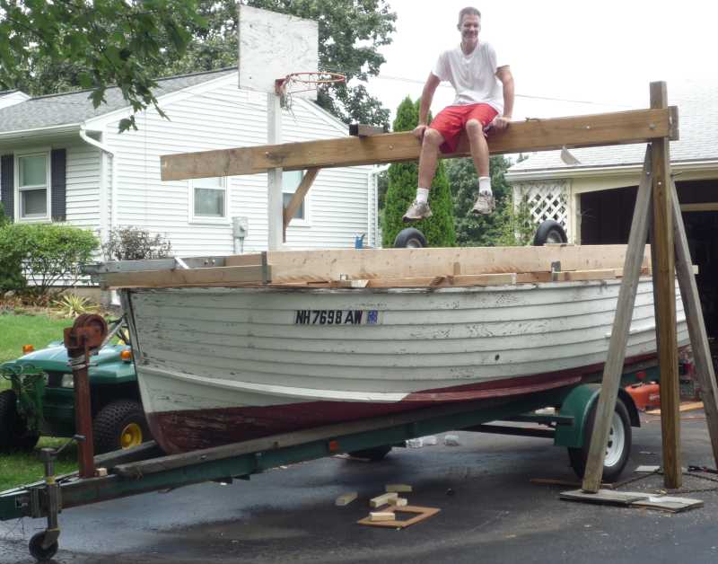

    I settled on building two gantries. I figured out I could store one more or less out of the way in the shop when this project was done. It will come in handy from time to time. Second one can be torn apart and recycled. I can use these to get the motor out and back in. I can roll the boat using them. Take the boat on and off the trailer and so much more. For the cost the more I thought about this was the only way to go. It will be so easy to lift and move the boat SAFELY by myself.
    I pulled the boat out of the shop to make room to build these. It was supposed to rain that night so I had to get the boat back inside and that meant I had to finish these that day. Building them was simple but it was one VERY LONG DAY!! Handling those big timbers had me dragging by about 3 pm. But I got it all done by 9 pm.
    In this photo, one is finished an standing upright while the second one is almost finished. it still needs it's casters installed. I put some temporary bracing in place to hold it together till I decided exactly where I wanted it. Once I got them up I put on the hoists and lifted the boat just off the trailer to see how everything worked and if the gantries were going to try to do the splits when they got a load on them.
    Everything went will with no surprises. I need to move the angle braces so they clear the hoists and I am going to add some plywood gussets at the top. Overall I am well pleased and think this is good set up.

    Love your gantries. I've been kicking a similar idea around for a couple of months but have been lazy - thanks for the motivation. I hadn't considered casters / wheels. Yours are quite big; were they expensive, source, etc.? Thanks!

    Large caster don't hang up on small item on the floor. They roll easier too, that is why I wanted larger ones. These are ball bearing units and yes, they are expensive. I bought these off Craigslist much cheaper but they retail around $40 each. You can find used ones on EBay though.

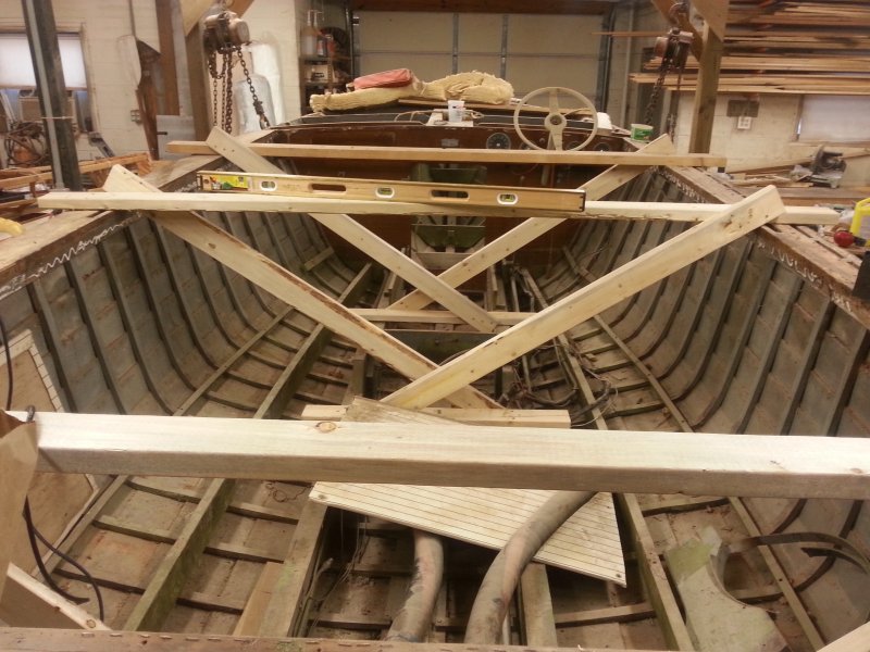

    Finally getting some time to work on the boat again. Finished my new book and just waiting on the final (I hope) proof copy. The one project I have been sort of dreading turned out to fairly easy, getting the motor out. One thing I learned is if I ever do this again, do it before the floors come out. It's much easier on your knees and ankles!!
    Up she comes. Stopped to see if I had missed anything.
    At this point I am starting to question if I have enough height to clear the boat and I didn't. Had to lower the motor. Tight up the chain on the motor and the chain holding the host to the gantry. Trying to gain everything I could.
    It paid off too. I had an 1/8" clearance. :-)
    This was a sight I have been waiting on for weeks now.
    Now to brace the boat a little better, it amazing how 'loose' these hulls are especially once the motor came out. Then finish the tear down and start replacing some ribs.

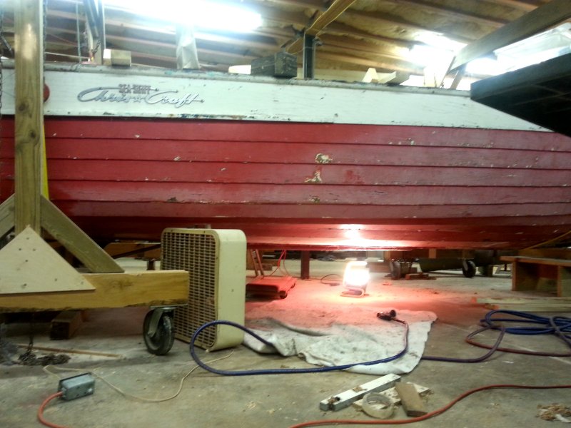

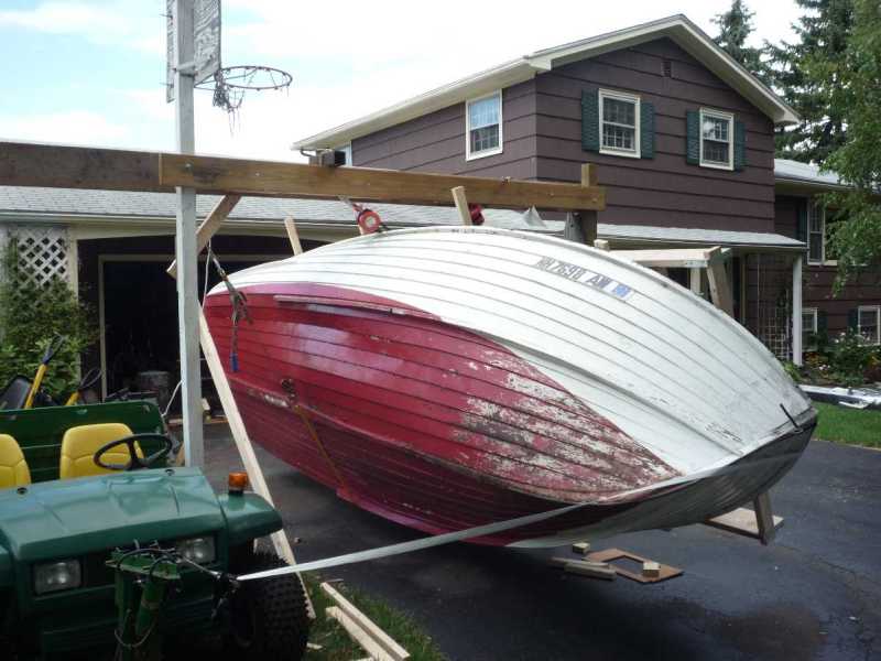

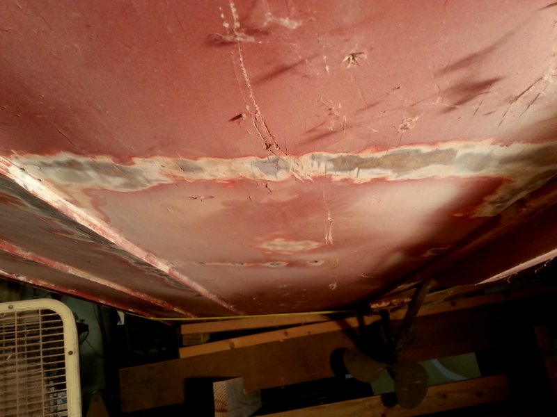

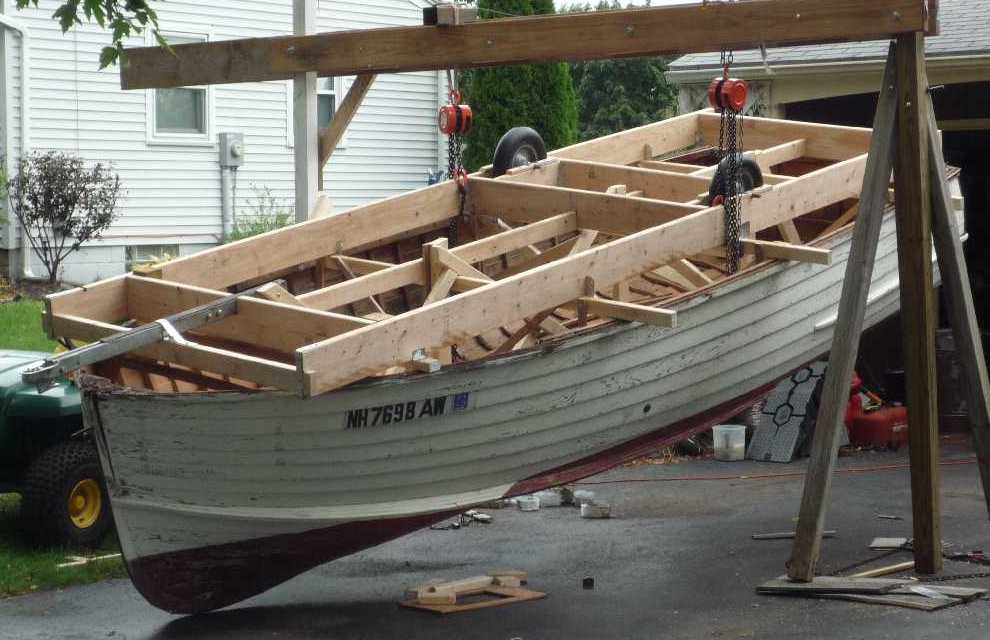

    I am finally back to work on the Chris Craft. I must admit this phase of the project has really intimidated me and I every time I come down and start working on it, I ended up staring at it, wondering how am I going to fix that bottom?
    The answer was just muster up some courage and dive in. So that is what I have one the last couple of days. I started by installing some bracing to assume the boat holds it's shape as I tear it apart.

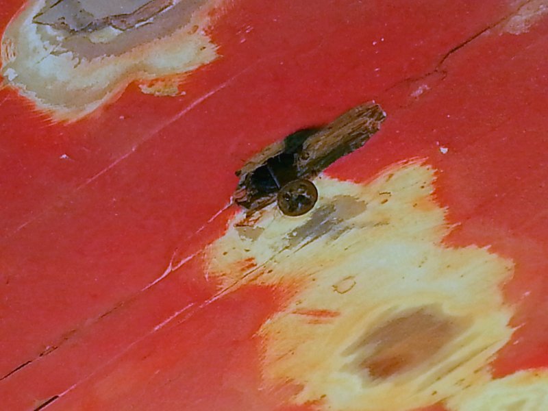

    With the bracing in place it was time to crawl underneath and try to come up with a plan. I could quickly see I was going to be spending a lot of time underneath.
    *I have found that an air powered angle grinder with a paint/rust removal pad is a good choice for the task at hand. It will quickly remove paint, filler and wood! And there is a lot of all three to remove.
    And here is a photo of the first (of many)screws coming out.
    I am still intimidated by this project. Still not sure what to do but at the same time I am excited to be back at work on it.

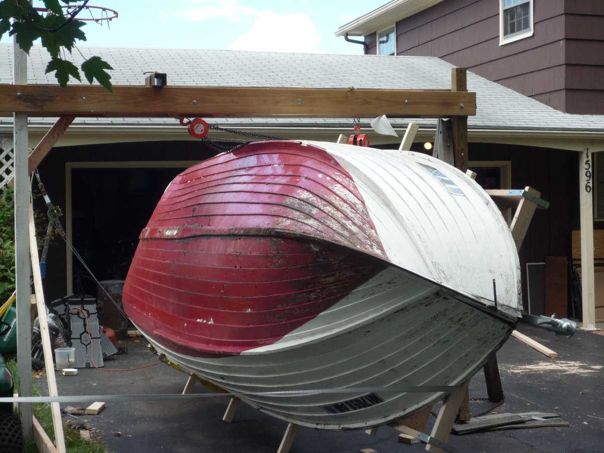

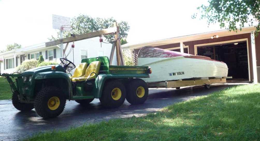

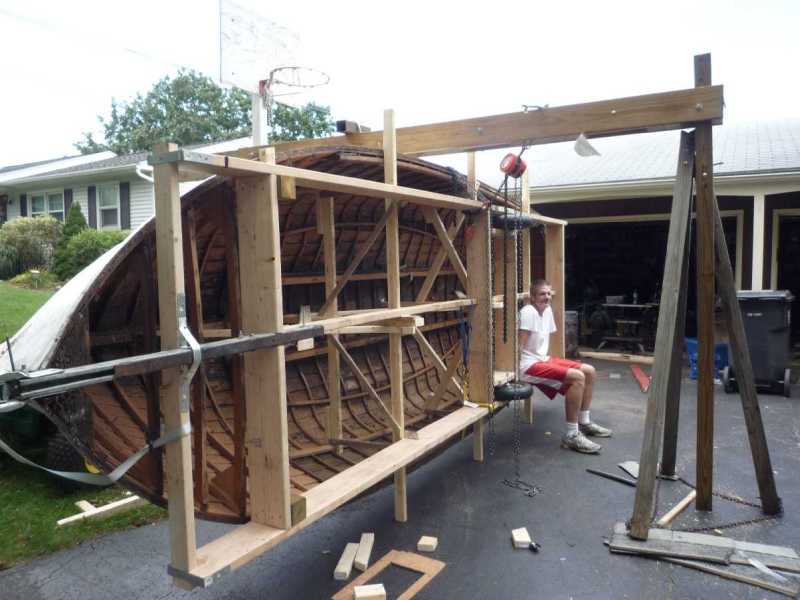

    I put the boat back on the trailer and pulled her out of the shop for a while. We had a really big project going on and needed all the space I could free up. We finished that and once I get back inside I was hired to make a couple of kayak for someone. Finally, finally, finally I started back on is this afternoon. I got this far and ran into a little snag.
    It is funny how much larger they look on their side!
    Took a break, came back and sat in the moaning chair and saw what I needed to do to get it the rest of the way. I have to make a trip to the hardware store and then I should be able to finish rolling it over in the morning.

    Oh my gosh! I hope you have help. That's a lot of boat to roll over. Be careful!
    Sep 2004
    Alabama
    609
    Default Re: 1962 Chris Craft Sea Skiff restoration
    4 chains hoist. Months of thinking and planning. I am working by myself because you can't depend on people anymore. Just got to keep in mind never to get under it or where it could end up if something breaks.
    I could use a hand tomorrow when it get ready to actually 'roll' to the other side. I have thought on that a lot and while I have a way, I would prefer a helper. Would be MUCH faster.

    Here's me flipping my Lyman Islander by myself (in 2012) using the basketball hoop and some lumber. Yes, I am at times insane.
    I put wheels and a trailer tongue on it so I can wheel it around.

    I see you used a come along to 'roll' her around. I have to admit defeat and put her back upright. I misjudged and got up up almost 90 degrees and she didn't want to go over the rest of the way. I didn't have a safe way to force it over, decided to out her back down and get everything I need ready and then next week I can flip her for sure. No sense being stupid just to save a few days of waiting.

    Way past due an update but nothing to exciting. Ran into some issues rolling it over and after thinking on it a while I decided to scrap the idea of rolling it over and just buy a good creeper. Mean time I have been busy working on it.
    First task was a thorough cleaning of the inside. Putty knife, shop vac and lots of work!
    Then I have spent a lot time removing paint, putty, cleaning screw heads, drilling out rivets, etc. Today I finally removed the first section of bad wood. Felt so good to past that milestone. So many things learned and will make it easier on the others.

    Lots of boat rebuild threads so I have not kept this up. Plus I got in over my head or at least it felt that way so it sat for a year while I tried to work up the nerve to tackle repairing all the damaged ribs I found. Once I decided it was fix it of scrap it I dove in and found it a lot of work but not nearly as hard as I had expected.
    Started back on it and messed up a shoulder climbing up and down getting under to boat to repair planking. Surgery and therapy and finally got back on it.
    Was making good progress when I started having an unexplained pain in the legs. Long story short they found a tumor in my spinal column. More surgery and then had to have another followup surgery to plug a leak in my spine. LONG recovery and months before I could get up and down the stairs much less in and out of the boat.
    After all this I am back at it and working like a dog. Plugging away and actually making great progress.
    Thought I would toss out a few photos of what I have gotten done
    My favorite photo of all. Never thought I would see all these marked off!
    I have to move her to a new shop, which I have to stop and build. If not for that I would say we were looking a Fall launch. Might still happen but I think winter is more likely.
    Just feels so good to be working so hard and exhausted ever night. :-)
