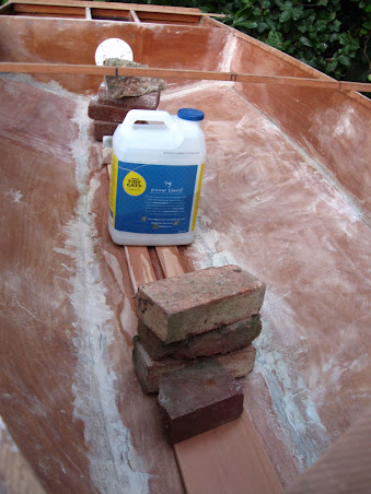

    I did start the keelson taking the bend of the hull, with hot water and a heat gun and a lot of weight.
    It will be a big help if it dries to something close to the right shape, because it's halt-inch western red cedar, and there just isn't much for the screws to pull down on.
    Through bolt it with small brass screws to hold it in place then screw it and fillet it in. Remove bolts and fill holes.

    ... That way I can sand the filler instead of the milled glass, and avoid putting tiny glass daggers in the air...
    I always filet with fumed silica. No daggers. And yes, if you don't want to bother with the moving parts of a kick up, a shallow blade rudder is the wise choice.
    That's a good idea, thanks.
    Do you glass over the fillets?
