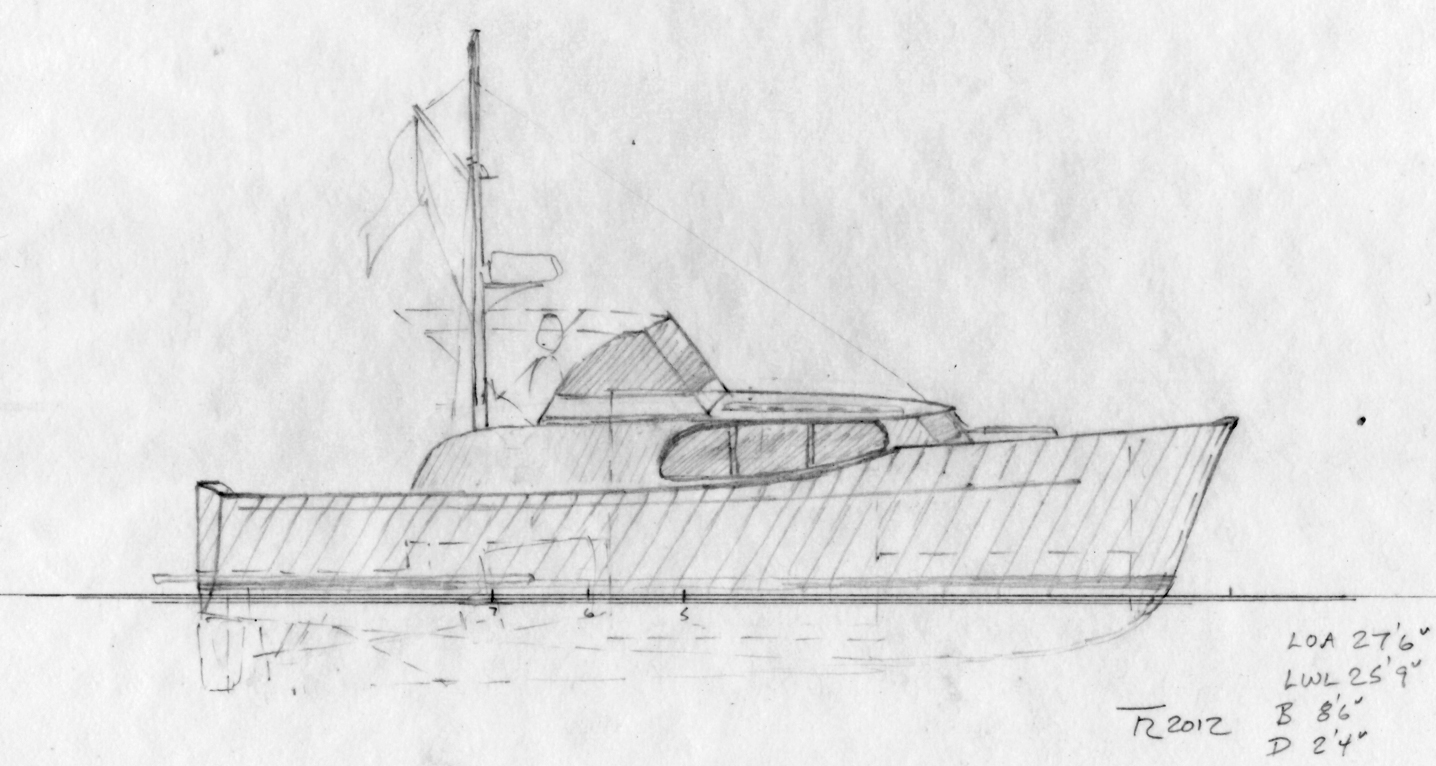

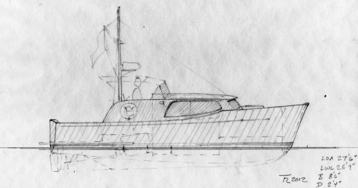

    Its just a shame that everything that makes this such a fantastic looking and balanced craft, cant be reproduced much smaller without completely spoiling the style.........challenge for someone.
    Scaling a particular "look" up or down is fraught with problems. People don't scale, that's the biggest problem. Big boats can be majestic, and while small boats have their charms, they are rarely majestic....so there's that major loss up front.
    I did take a couple of pokes at the "Little Cassiar" concept......in the first the house is too high, in the second the windshield is not right (too modern perhaps).

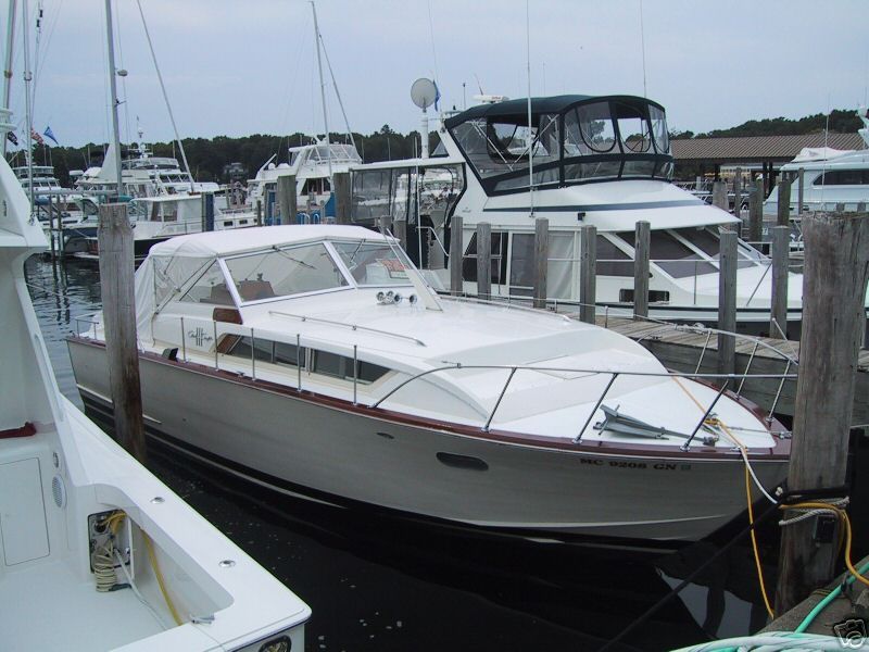

  13. #63
    Jan 2012
    Charlotte, NC
    43
    Default Re: When Powerboats made sense
    Wow you solved my mystery boat photo!
    I saw one of these in Michigan last summer and loved the lines. It didn't have a "Sea Skiff" name plate on it and the lines are so different from most Chris Craft cruisers.
    This one was in great shape.
  14. #64
    Apr 1999
    West Boothbay Harbor, Maine
    20,328
    That one in your photo is the one for sale in the link. Yours for whatever you can negotiate below $35K. Hint: if it REALLY is in good shape (surveyed by a competent), start with an offer less than half and make one more bid after they scoff at your first. Let them know the second is your last and final offer. You may be thought 'unreasonable' and 'ungentlemanly' but that route has worked for me several times.

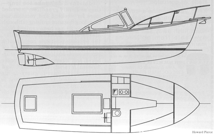

    Finally here's the smaller boat I mentioned in post #50......
    While not specifically a wooden boat she is of a type and arrangement that has been done in wood a lot. I just happen to have some hard data on this one. She is a lightly loaded semi-displacement hull very similar to a traditional Maine Lobsterboat, before they started inflating the beam. Designed in 1955 by Nick Potter the Dyer 29 is still available new built by the original manufacturer, there are over 400 of them out floating around today.
    The Dyer 28 is 28'6" overall, 26' LWL, beam 9'5", draft 2'6", and displacement is 6700 pounds. With a single 160HP Perkins diesel and 1.5:1 reduction she will burn 2.7 gph at 11 knots (1600 RPM), 3.8 gph at 13.5 knots, and 5 gph at 15 knots (3 mpg!)......Maximum speed with this power is 18.3 knots at 8.4 gph and just over 2mpg.
    Today this boat could be built at 5000 pounds with 4 cylinder turbocharged Yanmar (half the weight of the Perkins) and achieve even better efficency. But with the used market flooded with existing boats there is little incentive.

    And if I were shopping for a new design it would probably be one of Tad's, such as...
    Of course at the moment that's too big an if to contemplate but you never know when a suitcase full of money is going to fall out of the sky.
