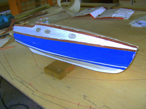

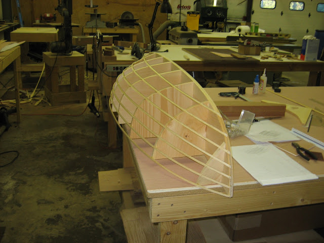

    I spent a lot of time working on the TS16 idea. I drew out all the frames onto pattern ply, and added another plank onto the sheer to form the cabinside/cockpit coaming. It was all looking quite well in my eyes. Another good point was that i could build up to 18ft in length inside my workshop, and anything above that would need me to extend,something that is in process,but was not at the time.

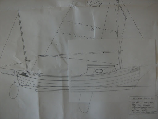

    Before i reveal my choice, these are the two boats that i have been looking after for the past few years. The Folkboat was the first boat i bought in Sweden. Important detail is the simple rigging,only 3 stays with a on/off adjustable backstay tensioner for inducing mast bend(only really needed in very strong wind). Bow profile on a Nordic Folkboat gets me everytime.I think the earlier boats had the better looking coachroofs,low,with small portlights.
    The Koster double ender came along a few years later, my love for the shape,especially aft, is what grabs me. But she has 10 stays supporting the mast! She is also considerably heavier than the folkboat,yet will sail remarkably well in light winds for her 3 tons,and can only be put down to her fair lines,she is not overcanvassed.
    So, i was asking a lot. I enjoy sailing on anything, but as an owner and more so as the builder,i need to have some kind of "connection" with the next boat,if it didnt "hit the spot", then it wouldnt get built. As Dave G said in an earlier post, i could quite simply go and buy a plastic boat,go sailing and have more than a pocket full of change left over. The same could have been said about buying old wooden boats,its does not make any "logical" sense to buy something that will be in a continous state of decay if its not looked after (sounds like the human condition), but everyone on this forum does it anyway.....but maybe for different reasons,to each their own. We need a smaller,lighter boat with glued construction, one that will allow us more sailing time,and with less pre and after-season maintenance issues. One of the biggest issues i have is having to haul the boats out before the onset of frosts,to allow the boats to dry out........some of the most pleasant days are in late autumn,and a glued construction will allow us to keep the boat afloat until iceing is an issue. More sailing time/less work.

    Ok ,ok... without wishing to be called Belzebub himself i guess im ready to tell you whos plans DID NOT turn up today! Despite my earler remarks on this thread concerning the shape of Wee Seal and Eun Mara,i did however say Iain Oughtred did draw a fine boat,and in my opinion,this one, does it for me......Kotik..
    This is the first Kotik launched,owned by Mikhail Markov (currently doing Raid Finland). What can i say? Simple rig, gorgeous stem and even better aft. I have Tom Painter to thank for posting the original photo (and also to blame possibly at some point in the future).
    I will be the first to admit that she is a little more boat than we was looking for, She carries almost as much lead in her keel as the whaler displaces! She is a wee bit deeper than we would have liked,but she is within launch and recovery capability at the local slip. All boats are a compromise.....but Kotik will give me the edge over Whaler when it comes to more adventurous trips. As much as i liked the Vivier Beniguet, i have to own up and say the plan price was off putting, so either im real tight, or she just didnt grab me that much; when i saw Kotik, i was in touch with Mr O and money was transfered,without question,without doubts,bargain! I have normally found, when something is right, you know it, and you dont find yourself questioning your motives,you just move in that comfortable feeling and knowing of , "its right". This is one happy-chappy!

    No doubt about it, Kotik is an aesthetic perfection. I'm still playing with WSII.
    Looks like 3s a crowd on Winkle...how's 'bout a shorter cabin trunk?
    Made a 1/4 scale bird cage too just to see how I like her...hmmm

    When I bought my set of Wee Seal II plans Iain mentioned the availability of the Kotik changes as a reasonably priced add-on. It's the "Mama Bear" choice in the Seal line (Wee, Kotik, Grey) and I thought quite lovely. After lofting Wee Seal I realized that the boat really pulling at my heart was Eun Mara, less fancy and more work-like. If Eun Mara wasn't there I'd probably be working on a Kotik too.
    Nice choice!
