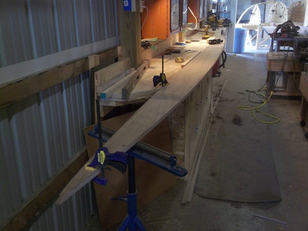

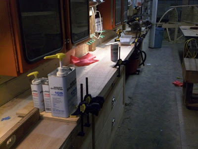

    I've decided to stick with the 6 strake design, as I spring battens on the boat they all seem to land near perfectly on the lap lines as drawn by Iain. Also, I've been on the web looking at a bunch of pictures and the planking just seems to 'look right' as drawn - my efforts are unlikely to result in any improvement. My only objection at first were some area's where there wasn't enough meat on 9mm material to get a full width lap, Iain shows leaving it overhanging a bit and then filleting in the rest to make a full width lap. So that's what I'm going to do, in the end these are underneath at the turn of the bilge anyway.
    James managed to make it look good.
    I also decided not to fiddle with clamping blocks, I grabbed a hole saw and just went at it.
    Extra 2x4 vertical supports for the molds have been added as well, I left these until now so as not to get anything additional in the way as I shaped the keelson.
    clamp up just a few and the rest spring through the lap lines and touch the molds on their own.
    Them's some cockeyed pictures.
    I didn't get any pics with more battens on, but I'm satisfied with the look.
    6 sheets of 9mm 7 ply picked up, I went with meranti.

    I got a can of 404 filler, 206 slow hardener (the 205 fast hardener was making me work too hard in the heat), and some 14g 7/8" bronze ring shank nails. I'll use the nails where I think fasteners are needed, likely on the plank ends and maybe on the garboard to keelson joint, although there is plenty of gluing surface there.
    With the delivery, I'm ready to start planking.
    I read with interest the discussion on Peters thread of the truss technique and I thought I'd try it.
    I like spiling - it's a pleasant task and works very well for me, that's very likely how I'll finish.
    But, I had the leftover battens from checking the planking layout and a bunch of scrap luaun ply laying around so I though I'd give it a try. I've yet to make a suitable spiling batten either.
    Do any of the builders of the AT, CY, or ST have a preference on the spiling batten. I was guessing what would work for the whole boat would be 3/8" thick, curved 3-4", 6-7" in the center, and taper to 4" or so at the ends.
    Anyway, I dug up my underlayment stapler and sure enough it was loaded with 3/4" staples.
    Here's what I came up with.
    I think the process is a bit fiddly and seems to take longer, it would be easier with lighter battens and using glue or smaller staples.
    I had to fiddle quite a bit with the garboards on my last build, these I would expect to fit dead on so it might be an advantage for this set.
    There are advantages to this method, but on balance I'm going to stick with spiling for the rest.
    Tough to see what you're looking at, but the 1st set is glued up on the bench.
    I'll do this for all the planks - spile, bring the batten to the bench, use it to gauge the rough shape, cut material about an inch over size, glue the blank - 12-1 scarphs, let it dry, then lay it out and cut it for the money. It seems to be what works best for me although I add an extra drying day in there.
