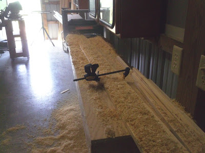

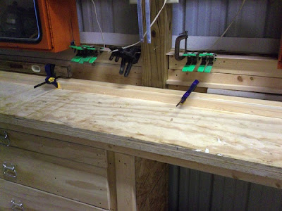

    Picked up this morning with the second set of battens dry, all are ready to plane.
    I ran them through on all 4 sides, they finish out at about 5/8th by 7/8th.
    They'll be planed down some more later if that turns out to be to stiff for the curves.
    Looking the other way as they come out. The bench is the same height so it can be used to catch really long pieces.
    And the overall view. There are some disadvantages to the long skinny layout, but I love the ability to run these long pieces.
    I end up with 13 battens, don't know how - not enough fingers I'd guess, thought I was making 12.
    3 of them are clear and straight grained, so I did end up with a few to keep. The others, I'll have to be careful with.
    "Any man who wants to can produce a good boat. It takes some study, some practice and, of course, experience. The experience starts coming the minute you begin and not one jot before."

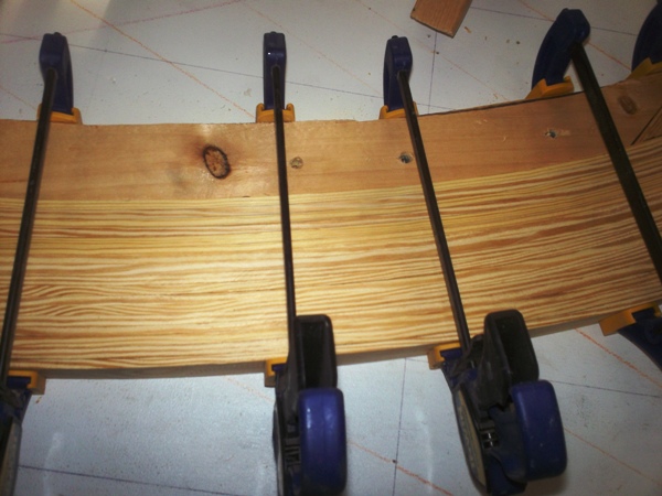

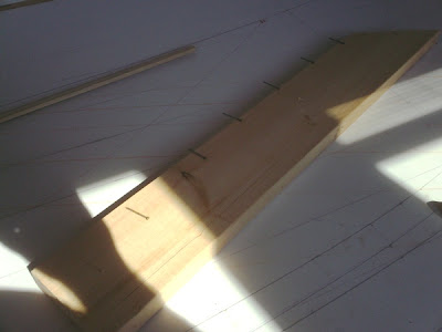

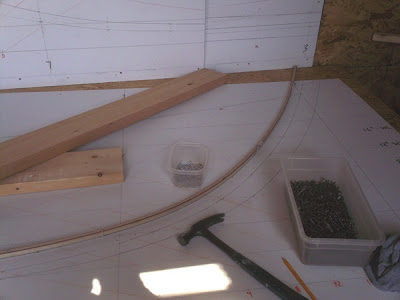

    Do to a limited number of clamps, I have to do 4 laminations, 1 at a time. I decided to work a few evenings this week so I can possibly start assembling this coming weekend.
    Laying out the apron.
    Old underlayment nails with sharp sides on the heads tapped in along the line.
    Tap the forming material in place, remove it and draw the line formed by the embedded nail heads with a batten.
    cut the 2x6 scrap forming material, screw it to the table.
    Dry fit the laminations to make sure they won't break.
    And finally glue them up. I like to wet all the parts with neat epoxy, mix in 406 thickener and recoat, wrap the whole deal in plastic, and clamp it up.

    And Peter, Do I have a moaning chair? Are you kiddin, things are much worse that that here, I'm planning an entire moaning suite!
    I've got the task chair in the above photo. It adjusts in height so I can roll it around and work seated at table hieght like on the saw horses there.
    The adjustable drafting chair at the pc below, so I can work seated at the bench. Both are work chairs though, and there's no crying in boat building.
    But...
    When I set up the building form, I left room over by the stove I'm fixin to pipe when it cools a bit.
    That's where the real moaning will happen.
    I've been toting this ole friend around since SWMBO determined that it was to be no longer permitted in the big house. I got it sometime after we were married, so it must be about 19 years old.
    So I gots the chair, the lamp, and the little stool (medicine table) - all sitting by the fireplace.
    Furnishing for an entire moaning suite! ...whenever I get around to it.

    One more small step done tonight after work.
    pulled the apron from the forms, bandsawed 1/8" off both sides to get the epoxy off, ran it through the planer to take it down to 1 1/2", and put it back on the form - it will be used as the form for the stem.
    dryfitting the lams for the stem.
    You can sorta see the apron looking a little darker after planing.
    The apron is 6 - 1/4" lams and the stem 11 or 12.
    And then glue up the stem, wrap it in plastic and clamp it over the apron.

    still laminating, got the aft apron done today.
    layout on the lofting
    dry fit
    glued up - the apron and stem from the bow are laying there too, you can see I got a bit of springback on the apron, I'll have to use the stem when I set it up to make sure I get a good layout and fit later when I install it.
    I'll still need to cut the rake on the stem and laminate 1 more piece on it but that'll have to wait for another day. I finally broke down and ordered a few blades and a guide roller set for the bandsaw.
    I've been breaking up samples of the glued parts and have no issues at all - happy, happy.
    Here's a cross section of the offcuts from the top of the apron and stem.

    I also managed a bit more on the boat. The keelson is shaped on both ends, the rake drawn on the stems, stems fitted pretty good, and finally enough head scrating done to figure out the bevels in the area where the apron marries to the keelson - it changes in this area from a flat with 2 bevels on the apron to a point on the keelson.
  43. #93

    Beveled the keelson today.
    roughed out with a 2" chisel
    smooth with a plane
    50 grit on a block across the grain
    both ends are left a little on the heavy side, I'll fit them when I have the actual planking material so I can get the best fit.
