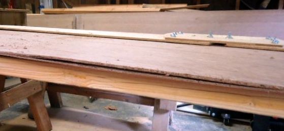

    Ah, the joys of boat building. I had just spiled my first planks ever, garboards for a 16' Melonseed. It was one of those tasks that when reading about sounds complex but no so bad in practice. Reminded me of plotting fixes in celestial nav. I was pleased, somewhat surprised, when the planks actually fit on the molds, and where they were supposed to.
    Arghh, the agony of boat building. While beveling the garboards the Hydrotek 6mm Meranti B1088 marine ply began separating and revealed an 14" run of delamination:
    Has anyone else had this problem with Meranti, or am I just lucky? Of course it was already epoxied on, so removing it didn't seem to be a good option (but probably the correct one.) I shot the void full of CPES and saturated it with epoxy, clamped and hoped for the best.
    The plywood had been stored in an unheated garage for 9 months, but I would hope that marine ply could handle some dampness if its designed to used in the ocean.

    Hard to tell from the photo what is going on.
    Bad luck is bad luck , on the other hand , I am not a believer in coincidence.
    Seen any other de lams in your stock?

    Is that a delamination of the glue line or did a core veneer shear itself apart?

    Bummer. A close up photo of the endgrain would be good. I have had some el-cheapo 6mm chiense WBP ply in storage for more than 2 years and found that it had been leaked on after a tile slippage on the roof.....however....although there was some minor warp in the sheet,the gluelines have held,cant say i expected that. Alas BS1088 as a standard does not seem to guarentee good ply,though i believe Hydrotek is a well known supplier of quality sheets? You may have been unlucky, but i agree with you when you say they should stay together even if being in a damp shed for 9 months.

    The separation is between the middle glue lines. I have 3 sheets of 6mm and 4 of 5mm from the same order and only the one sheet is showing any delamination. Of course that one didn't show it until I cut a plank out of it and I started planing. Here is the sheet that the plank was cut from.(the separation occurred gradually, it didn't look like this until the next day:
    When I saw the separation appear on the top (bottom) edge of the plank I thought I was dealing with a small localized problem. And being in a self-induced rush I HAD to get the bottom on within my scheduled time frame, so now I have the bottom w/skeg already on. A classic case of ready, shoot, aim...but now how do I deal with it? Nothing will come off without great difficulty if at all, so it looks like I'm in the repair mode already. I am, or was, planning to cloth and epoxy the garboards and bottom so it will be sealed, but I need to do something about the delams.

    The designation "BS 1088" is a statement of quality signifying this ply meets a certain set of established standards. The standards have been discontinued by the BS organization but they have remained in common use and anyone who claims his ply meets the standards should be willing to warrantee any that is obviously defective.
    Your ply does not meet British Standard 1088. Ply that is BS1088 shouldn't delam even if you boiled a piece for 24 straight hours. The largest void it can contain is .020" total. The manufacturer should be willing to refund or replace. That is if the manufacturer is known.
    Ply that carries a label like Shelmarine, Joubert or Bruynzeel is a better bet to warrantee their stuff because they have a name to protect.
