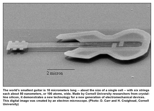

    Also, from my perspective, the whole field is kinda coarse and sloppy. I'm more used to 3D printing on the atomic level:
    This marcoscopic stuff looks to me like Picasso painting with a paint roller.
