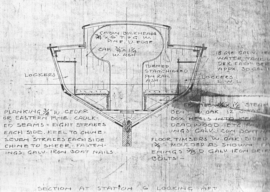

    Ooof!........not for the faint of heart or the quick and dirty builder. This is a fine example of a vee bottom boat that's more complex to build than a round bottom one.
    This is the build method I can think of this morning........
    You are building this boat right side up. Loft using all the offsets provided, 14 molds plus the transom. Make the ballast, set up the keel, stem, and transom, then set up all your molds and run the ribbands. You will have lofted the chine log and have notches cut in the molds to accept the log, temporarily fastened to the molds. Bend in the first set of ribs (on this coast frames are sawn and ribs are bent) between the molds, fasten them to the chine log (I'll come back to this in a moment). Then go back and start removing molds one at a time and bending in the rest of the ribs. Probably start at the ends and work towards the middle (biggest piece last). I hope you have a good source of straight-grained green bending stock, there are some hard turns here. After all frames are in get the clamp in ASAP, and you will have added cross bands as you removed molds. From here proceed as usual with fitting all those little wedges and planking the hull as you remove ribbands.
    Ed Monk (among others) was against running the chine log bolts through the frames. It seems a poor idea to put a hole in the frame at the point of highest stress. Monk ran another stringer inside the frames and bolted the chine log to that (I assume with blocking between), clamping the ribs between them.......
    Section from Maid of Kent Construction Drawing

    Tad, Thank you Sir. Your build outline is very helpful and I am grateful for your knowledge and pointers. The warnings over how complex this undertaking may be are duly noted. Whilst I didn't seek a modern cruiser SA/D ratio, I must admit that under-canvassing may become a problem in certain circumstances. Two years ago, I just missed buying a Westsail (WETSNAIL?) 32 in Bali. The guy said he was selling because he was tired of having to motor around in the Java Sea. Even the Atkins admitted that their Eric, upon which the Westsail was based, was super safe but not the right boat for all men. I will think long and hard on this before I commit myself.
    The drawing you attached to the first response is part of the drawings I received from Pat Atkin. This section shows a rabbeted chine. She also sent another drawing which showed a 2 part chine log, which i would probably opt for as a simpler alternative. I note your reference to Ed Monk and Others re an extra stringer to avoid weakening the frame at the bend point. I will try to look up his work on Google. Maybe I need to think that issue out carefully too!
    Somehow the magic of this Little Maid seems to have caught me. I love the lines and the fact that it's a schooner really has me hooked. I could probably afford a more logical choice of vessel, but I am not sure that I will end up making the sensible pick.

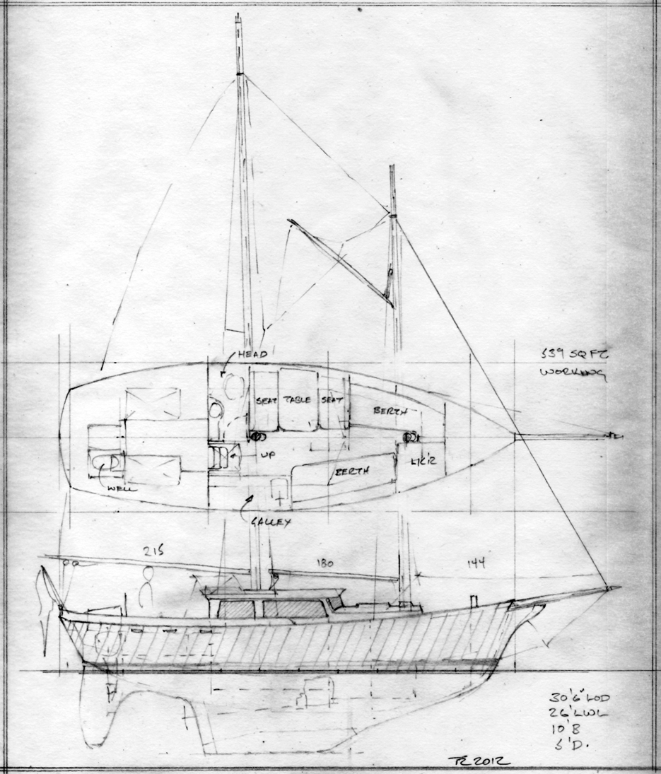

    But it actually suits her character and adds useability in the form of standing headroom in the galley. In a place (PNW) where it's always raining this is huge......
    The Maid of Kent is undercanvased, but that is because she is small and light and can't carry much more sail than that.
    Can't carry "much more" in what? Perhaps full sail is what she will carry in the usual 25-30 knots of San Francisco Bay, but in our usual 5-8 she can carry a great deal more.
    The biggest negative for your purposes is that she carries a schooner rig. The schooner rig really is not very efficient until you get up around forty feet and above. The Maid of Kent, for that reason, does not sail to windward as well as would just about any other rig choice on a boat of that size. You'd do much better with a cutter rig, or even a ketch, than a schooner in a boat under 40' or so.
    Chris shouldn't have it because it "is not very efficient"........Well then I guess we should all be sailing the latest plastic whatzit? We're told they are terribly efficient, it must be so.......But efficient at what? Take a pair of identical Maids, schooner rig on one ketch rig on the other, identical sail area......reach/reach race course....who wins? Best skipper every time.......
    Thank god we don't all want the "most efficient" thing, that some are interested in other attributes.......
    And I don't think there's any good reason to say schooners under 40' are "are not very efficient". I don't think size has anything to do with it. How well a particular boat works has to do with many things, the rig is only part of it.

    Quote Originally Posted by TR View Post
    The purpose of the schooner rig is to break up the sail area so it is easier to handle. There is no point to the drawbacks of a schooner rig until the sails get large enough that breaking them up so they can be handled by a small crew is advantageous. A small schooner like Maid of Kent is a nice looking fun boat to sail. It isn't a serious cruiser, which is what the man says he intends to use it for. The top hamper slows it down. Frankly, the foresail in a schooner that size is near useless. The complexity of the rig makes it more work to sail without any payback. One could theoretically rig a gollywobbler on a Maid of Kent, but at some point the boat isn't big enough to carry the crew to handle all those sails at one time. Fun? Sure, but I don't think that if somebody is going to build a boat in that size and weight class for ocean cruising, even in lighter aired seas, that it's really a practical choice. The fact that someone has made a long voyage in one design or another doesn't really mean anything except that they are competent seamen. More small boat long voyages have succeeded because of the sailor's skill than the boat's abilities.
    And, as for "standing head room in the galley," for what? I'd prefer to sit and cook, particularly underway, and save the windage at that. The doghouse precludes the only place a rigid dinghy could be conveniently stowed on most boats this size, BTW.
    But your mileage obviously varies.

    Default Re: Atkin Little Maid of Kent Design Query
    Quote Originally Posted by Bob Cleek View Post
    Bob, I'll differ on this as well, but only slightly I think an important reason to opt for the schooner is the ability to balance the boat (under working sail) at any angle to the wind. I don't think "handling" sails of only 200 odd square feet is an issue (If one means setting and furling). With three smaller sails you don't reef just hoist and lower, similar to a ketch. It's a bit different than a cutter because the sails sails are spread further fore and aft....And some will say that's a bad thing
    It does....... judging from my inquiries, after a separate head, the most important feature in any design is standing headroom..........
    I think that in actual practice, you'd find that the main on Maid of Kent would require reefing fairly routinely if huge weather helm is to be avoided. She doesn't have the headsails to balance that main if not reefed. You can't be flying a big overlapping genny in any kind of wind that would require dropping the foresail.
    As for an enclosed head and standing headroom... I don't think the latter is worth the space on any cruising boat and the former is a luxury that cannot justify sacrificing a broad expanse of cabin top and a clear view ahead nor incurring increased windage. I'd have to agree with L.F. Herreshoff on those two points. Particularly the enclosed head these days, with the holding tank requirements on MSDs. "Bucket and chuck it" is really the way to go in a small cruising boat. An enclosed head on a Maid of Kent would take up maybe 15 or 20 percent of the cabin space. I can't see spending that for what, ten minutes a day sitting on the crapper, not to mention the expense and hassle of maintaining the MSD system. I realize others disagree, of course.

    Tad,i agree outboards can be an easy solution,but i guess it depends how much you want to rely on the auxillary. I do like having a large slow turning prop powered by diesel...i think i have had a 30 odd hour continous run under engine,but i could never have done the same with a petrol outboard,even a fourstroke,it would be too expensive around Europe. Anyway,i believe gas/petrol is pretty cheap around Indonesia,so maybe a good Hi-Thrust long legged outboard would be a good option for Chris....it would certainly save some initial expense,though im not sure about long term .Keeping the prop in the water has always appeared to be a challange in sloppy water.
    The specific consumption (g/KW/hr) of a diesel will (AFAIK) always be lower, and if one were building a boat to make longish trips under power I would recommend the diesel. But for the average (is there such a thing?) weekend cruiser who puts 10-20 hrs on his motor per year, the vast expense of a diesel (installed cost) is not worth it. This has become true because 4-stroke outboards are more common and thus reasonably priced, small ones burn little fuel, and they are very reliable. And you can take them home for the winter, keep it warm and dry and not corroding away. I've been using a 5HP Mercury (badged Nissan) for years, every day, it just keeps going. I have three others, a Seagull, 2-stroke Yamaha, and a Honda 2, that all come and go, rarely operating what I consider properly. And I have done long trips with the Merc, not 30 hours straight but certainly 12-14, usually towing other boats, and the fuel used was surprisingly small.
    Keeping the prop in the water is the reason for the inboard well, coupled with a long shaft it will be under the boat instead of behind it.
    (Tad,took a cruise by you page recently,loving the Wedge Point 27......if really frustrating as been drawing something very similar,but a few feet shorter! How accurate that weight in cruise trim? Seems really light. PM if you wish)
    When designing for unknown individual (mostly amateur) builders, all the designer can do about weight is indicate his wishes. The result will be different, how different we don't know. The Wedge Point is built the same as the Berry Point 26, she's at 3600 with a heavier motor, thus I believe the Wedge Point could operate at 4000 pounds, but it's only a general hope at this point. For instance the Nomad 16 is being finished up right now, I went by for a visit and found about 300 pounds of electricals have been added. I had no idea this would be the case, and this is to a 1300 pound (design displacement) boat.........Not many people understand the rigor required to build a really light boat, and to keep it that way.....But it is the key to efficient operation. The Wedge Point is supposed to have a honeycomb cored roof, many won't do that as it costs considerable money, so another 100 pounds is added. The weight of the plywood alone can vary hugely between species.

    Chris.....If you get over the schooner thing, Mark Smaalders has made a good attempt at simplifying the construction of small traditional cruisers.......http://smaalders.net/yacht_design/homemod.htm
