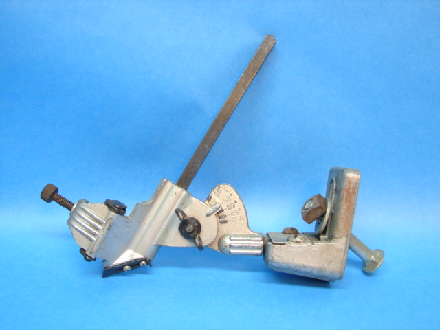

    Quote Originally Posted by Stiletto View Post
    I use a bench grinder too, how small do you go down to with yours?
    Hard to say, I've not yet gotten so zealous with the sharpening that I've taken all that much meat off any bits. They usually only take a soft touch up on the fine wheel. I have a jig that I use to check the evenness of either side of the bit, but being away from home I can't take a photo to show it.
    However, it's basically just a vertical piece of stainless steel plate that I repaint with a cheap spray can of paint every now, with a V cupped base that I can sit the bit in (so that it centres in the base regardless of the size of the bit) and then just scratch a fine mark with one edge of the sharpened bit on the paint and turn the other edge to see that both edges line up into the same scratch mark.
    When the paint gets so scratched you can't pick the one that you are using just respray it.
    This may (or may not) give a better idea of what I'm trying to describe:
