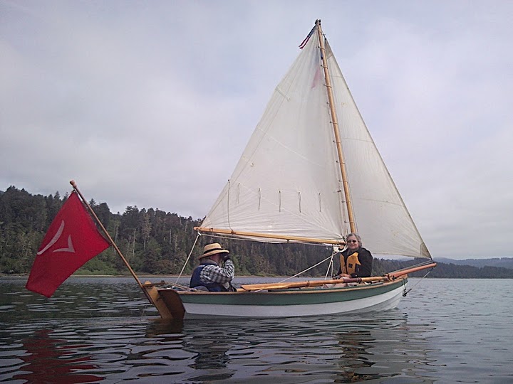

    What is the danger of leaving oars in the locks on the gunwale?
    Aug 2005
    SF Bay Area- Richmond
    12,233
    Default Re: Boat Soup
    Bob is, as usual, correct. I also tried various mixes of boat soup for floorboards and thwarts in my dory skiff, and have switched to varnish. Particularly in hot climates, the varnish works out much better in most cases than oil coatings that may get sticky or semi-liquid when out in 100+ degree temps.
    I also carry oars on the gunwales, what the Aussies call "torpedo style". The two gripes I hear are:
    1. The danger of having the oarlock horn itself always in place, as folks can get injured falling on them when climbing in and out of the boat.
    2. Leaning on or bumping the oar when trying to get to the high side, or when leaning over the rail to balance the boat when heeling. The oar can either come all or part way out of the locks, depending on how they are set up and what oarlocks are used.
    Both are good reasons, but I still keep mine on the gunwales. I've been saved a few times from whanging into riprap, docks or other craft by being able to just slide the oars out and row. You can also slide one out for a few strokes to help with difficult / botched tacks.
    Rowing off lee shores with the sails up is also much easier, as there isn't an involved or complicated oar storage process when you switch to sail power -- just slide the handles forward into the ring oarlocks in the forward position and awaaaay you go...
    Thorne, I had long assumed you were sitting under some type of red parasol in your picture but now I see the truth!
    You don't have all the facts, p-dawg.
    What other facts do I need to know?
    1. Boat is moving.
    2. Oar is stowed on gunwale.
    3. This is inappropriate. QED.
    I can't recall any old picture of oar and sail boats being used in this manner. For centuries boatbuilders have sought to minimize the danger of boat members becoming fouled and damaging the boat. Hence, boat joints always have the featheredge pointing aft; molding and trim are always raked aft.
    But here you guys are voluntarily circumventing this age old dictum. Now with Thorne, I can understand since he is from the Bay Area, wears zany hats and if I am not mistaken, even is a "reenactor."
    But this should not serve as an excuse for you.
    p-dawg
    Oh, "boat soup" is great if you like your boat to look like it is a carbonized survivor of the eruption of Vesuvius. Oil for the interior of a small boat is much preferred in my humble opinion. Our man yeadon is correct in this opinion.
