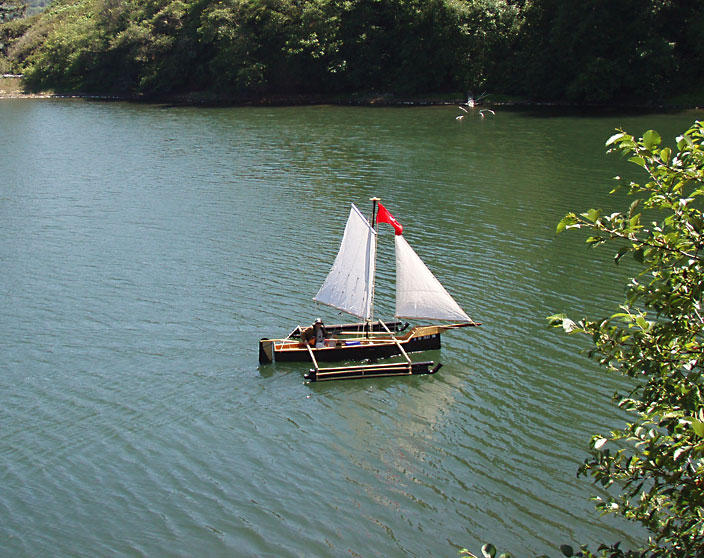

    Quote Originally Posted by SteveClausen View Post
    WTF is that? It's a joke right? Like putting skis on a couch for a goof.
    Nope, serious as a heart attack, you should have seen him try to sail it. He loves stays, even when the mast doesn't need them, and prefers to use stretchy cotton line. The boom hung up in the stays on every tack, combined with other lessons that our forefathers learned centuries ago. Built completely from the cheapest Big Box Lumberyard materials, as the whole "marine materials" thing is a rip-off in his perspective. This is why I have the perspective I do on "quick n' dirty" builds, particularly ones "designed" by the builder.
    Here's another boat by the same builder, aka "The Floating Coffin" -
    The following year he put two of the plastic-sewer-pipe amas on it that you see in the canoe-thingie above, and they finally allowed him to sail (somewhat) to windward.

    I respect that builder. 1. He has actually BUILT AT LEAST ONE BOAT. 2. He's not on a boat forum sneering at someone else.
