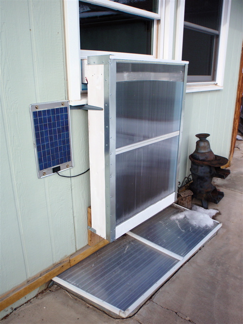

    The champion breaker-popper in my shop is a 1500w electric milkhouse heater w/fan. If it comes on when I'm running a drillpress, etc. the breaker (20 amp?) flips. Mostly I used ceiling-mount quartz radiant heaters, that don't pull as many amps and don't have thermostats. But when I added a greenhouse, I cut a port and installed a 3-speed fan, to push hot air from the peak of the greenhouse into the shop. That works beautifully in winter, getting the shop up to 50-60°, plenty warm for gluing or painting.
    There are quite a few designs for homebuilt solar hot-air collectors. Here's a small one that fits into a sash-type window. A 10w PV panel drives a couple computer cooling fans to move more air.
    (The thing below the collector is a window-well cover built of greenhouse scrap.)
    It makes sense to collect heat and move it with air, rather than converting it to electricity and then back to heat. The greenhouse thread as a whole might be helpful for designing a shop to use various forms of solar energy.
    http://forum.woodenboat.com/showthre...e-Update/page2
