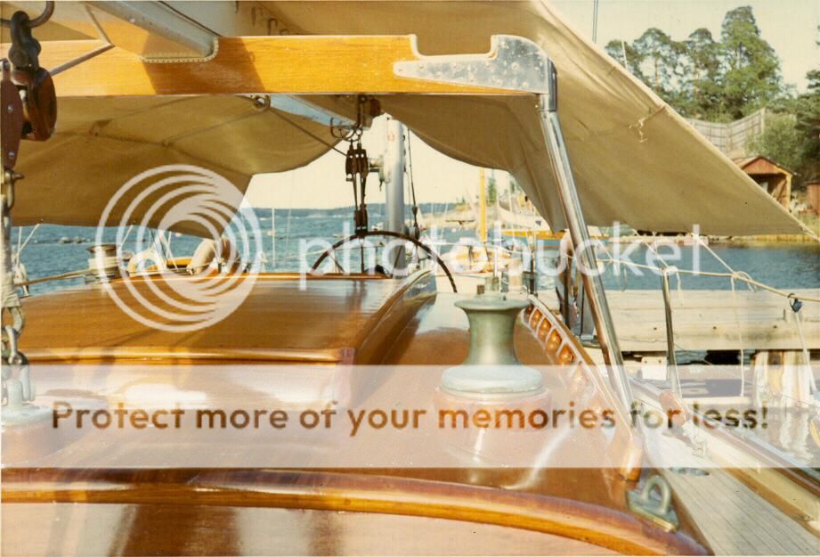

    21' Antigua Sloop,modified by me, in 1978. The boom thingy held the lifelines and the green awning,which could go horizontal or vertical, for keeping those beautiful sunsets outta yer eyes. Sculling bracket, (engineless, mostly) and OB bracket on the rudder. (what part of engineless?)and my not yet wife.3 years living on this lil stinker.
