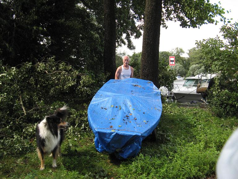

    Mirror complete ~ 60 kg so without spars, rudder etc. the pulley system would be OK.
    But surely a couple of standard galvanized blocks with 4x tackle from the DIY and a few metres of rope would be cheaper?
    Puffin was suspended in slings between poles and a short jetty for several years and it was no problem for me to raise/lower her with a 4x tackle. My slings were old car seat-belts from a junkyard. They are virtually indestructible.
    If you make a flat cover or buy one, put some hoops under it to prevent rain water sagging into the hull. I simply wrap a polytarp over the hull. It holds for about 2-3 years, but for the price of that new flat cover, I can buy ten polytarps!
    I hope work is progressing well!
    Gernot H.

    Quote Originally Posted by 62816inBerlin View Post
    If you make a flat cover or buy one, put some hoops under it to prevent rain water sagging into the hull. I simply wrap a polytarp over the hull. It holds for about 2-3 years, but for the price of that new flat cover, I can buy ten polytarps! Gernot H.
    I'll second that, especially regarding shedding the water - I used a polytarp for years - well, a silver one actually, which might be five dollars extra (Queensland weather requires it) - in the shade if you have any though.
