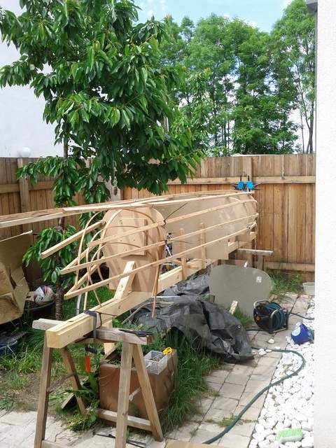

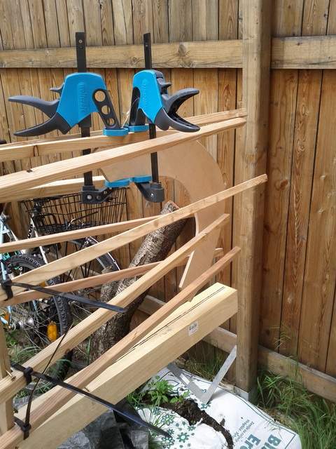

    We do not have any plans. We could probably go with one of the plans from gilpatricks book on strip canoes that I bought. Other than that there is so much information that I can't justifie 55$ for plans.
    We spent 16€ on wood, 35€ on a wallpaper steamer, 16€ on sinew and will need some more money for skinning if we don't go with the 1.60€\m2 pond liner.
    We will sell the boat off on our homepage if it is a success and try another with more budget next time. Got the oak for free though.
    Maybe somebody here got a design hor you, then I'd be interested too
    The boat will be 90cm wide, 4m long, 35cm deep and very flat bottomed.
    We just hope it swims that would be a success.

    I have found a Plan now. There is the "Laker" in gilpatricks book. It can be built 4m instead of 490cm by omitting 2 stations.
  36. #36
    Default Re: Skin on frame canoe

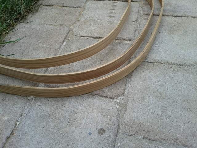

    We got no time left this semester. The kids tried some bending. They are not really very patient steam bending did not work really well. We also do not have good wood for steam bending. 8mm fir worked some times. They also tried dry bending some 4mm spruce which worked very well. Anyways we have to do it next semester. Then I will cut up the wood for them and we will make some small craft with plywood frames. Maybe the Ruth can be modified to make it a little shorter?
    I will try to get the thing together anyways. I omitted another station and set up 3 stations on a 4m 75mm square. Used the 20mmx20mms larch stringers I had cut and now I will bend in lots of 4mm spruce ribs. Let's see if it works with the cheap wood and bad building I am doing. Will add some pictures when I am not writing on my mobile.
