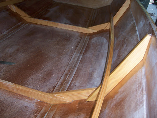

    The original plan calls for dory-style frames set every foot along the length. I'm keeping the dory frame construction but doing away with all but three of them in keeping with the anticipated use of the boat.
    The frame construction is pretty straight forward. The front and rear frames required sanding at a bevel angle to lie correctly on the bottom. I glued up the lower three pieces of each frame first.
    Detail of the frames. These will be under the seats so most of the frames will be out of sight.

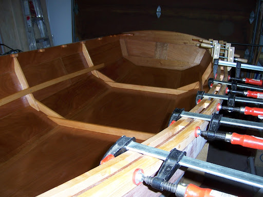

    Before installing the upper part of the frames, I wanted to clamp the rub rails in place to ensure a fair curve on the shear strakes. Since these are vertical, and there is a pronounced curve to the shear line, the rub rails must bend in two directions to fit. The original plan called for 1 3/4" x 3/4" rails, I'm going to use 1 1/2" x 3/4". There is no hope of using oak or ash without steam bending, but I can get Douglas fir to take the curve. Yes, I know it is soft. Yes, I know it is prone to splintering. I am going to use a dinghy bumper over it so it should be just fine, and I rather save the weight.
    I pre-radiused the outside edges of the rub rails. Hey, every little bit helps when you are trying to bend this stuff.
    With the rub rails clamped on temporarily, I glued the upper sections of the frames in place.
    Final gluing of the rub rails took a jillion clamps, but I got it to work.

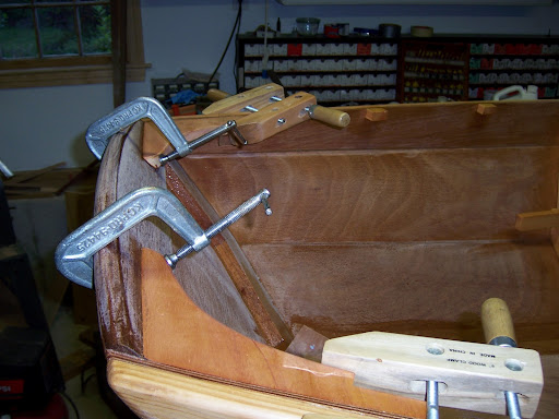

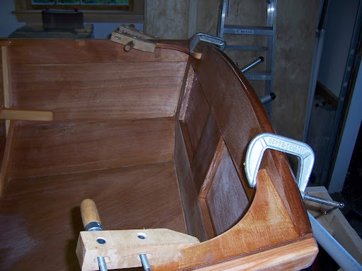

    Here are the bow knees being glued in:
    And here are the stern knees:
    The inwales are clamped in place temporarily.
    If the inside of the boat looks a little shinier, it is because it now has a coat of varnish.
    To get the length of the inwale exactly right, I cut the end off the inwale and kept cutting right through the knee, so a line-to-line fit could be achieved.
    Now the inwales can be glued.
    Time to turn it over and give the bottom a coat of one-part polyurethane.

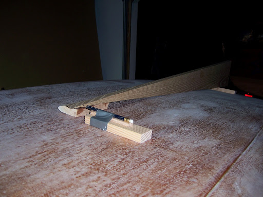

    Next up is the installation of the skeg. The size was taken more or less from the plan and cut from a piece of white oak. A pencil on a spacer block was used to trace the correct curvature.
    After tracing the curve, I cut to the line on the bandsaw.
    Gluing it on required the assistance of some idle bricks and a worn out battery. You never know when you might need stuff like this.
    When the skeg set up, I gave it another coat of paint. I'm rolling it on with a mini foam roller.

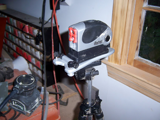

    In order to set the waterline correctly, I borrowed a laser level from a friend. Isn't technology wonderful?

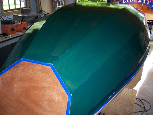

    Using the laser level it was a simple job to mark the waterline, after the boat and the tripod for the laser were moved around a few times, of course.
    A couple of coats were all it took to give good coverage with the Racing Bronze. Those inflatables at the dinghy dock won't be able to keep up now.
