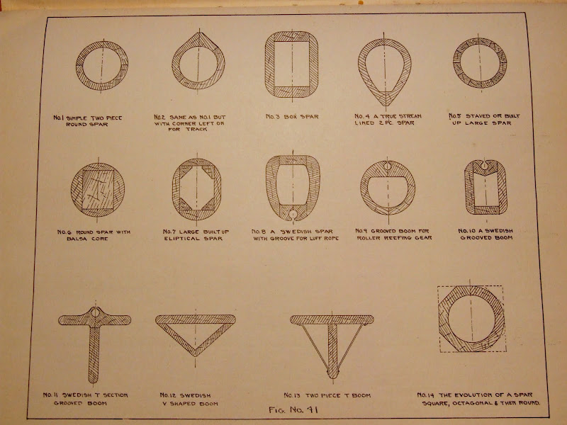

    Fred, I'm sorry that you have so many challenges finding proper materials. What you need is a handplane to cut your scarphs with, and then you can make a proper birdsmouth spar using shorter pieces of wood glued together to make your staves. This is a tool you could even make yourself, actually, but I bet you can find one even way out there. You don't need a whole lot of power tools, but a simple plane is essential, and will help you get the best out of the short lumber you have readily available.
  26. #76
    Jan 2010
    Sweden,Scilly Isles, Siberia
    2,891
    Default Re: A fishing, cruising, racing birdwing SCAMP
    Fred, although a birdsmouth hollow section mast would be ultimate,dont think for a moment that a square stick with rounded corners wont work. It may be a little heavier and a little stiffer maybe,but much of that depends on the timber it is made from to start with. Everything from dinghies to my friends 25ton 55ft ketch have been built with wooden box section spars.
    As far as i know, there are no Sea-Gods that are offended by squarish masts.

    Sorry Fred, I was blissfully ignorant of your circumstances in the islands. A good hand plane is a great thing to have but it better be extra sharp to use or you will need the patience of a saint to use it so make sure you look for a good sharpening stone as well. I use a little Bosch power plane with 1/32" increments of adjustments. I can't help but wonder if it wouldn't be worth the wait to get your hands on one. I love mine and have become very skilled at using it. I am very spoiled when it comes to tools and have always had a table saw when building boats so it's hard for me to relate to your situation. I my opinion you still need something to rip the wood along its length in an orderly manner. I would want at least a skill saw that could be used with a fence to get the job done but I'm just thinking out loud here.
    At the risk of receiving the wrath of James, let me also throw this into the think tank for mast building. I have become accomplished at sheathing bamboo with expensive hybrid materials and epoxy. This does two things. It protects the bamboo from the marine environment and doubles or triples its strength. You still have to protect the epoxy with a good UV protective vanish but it then makes for an incredibly strong, weather resistant stick. Composite bamboo can even be bundled together (in the Chinese tradition) to reach strengths exceeding those of a normal wooden mast at a weight similar to or less than wood (in my opinion). I have also seen bamboo split and then epoxied back together again around a mold to make a very light and strong mast. The problem with this line of action is that experimentation is very expensive especially when using expensive materials like the hybrid cloth sleeves and epoxy that I use on my bamboo. It's easy for me to envision a crab claw sail like the locals use only much stronger and much more weather resistant but the costs would likely be prohibitive. Makes me wish I could fly over there and experiment with the local bamboo and the hybrid sleeves in order to make such a high tech/ low tech sailing rig. One thing about the hybrid sleeve material, it is very light and ships easily but like I said, I spent a bundle figuring out what sizes to use and how to keep the bamboo rotating as the epoxy set. I love to experiment. It is my passion but there are usually a bunch of failures before success is reached. Don't know how deep your pockets are so can't tell you this would be a good course of action or not but you could probably buy a nice table saw and have it shipped in for what you would spend experimenting with composite bamboo. Wish I could give you a better solution.

    Fred it looks like the Fijians call this tree VaiVai: Albizia saman. Lots of local names.
    http://en.wikipedia.org/wiki/Albizia_saman
    Scamp' are extremely stable, I'm sure it could manage, even with a heavier mast. You can have a light mast by building a hollow spar or by removing material from the halves. Besides lug rigs do best with really stiff masts, especially needed if its unstayed. It also slows roll speed and makes the boat less twitchy.
    Some options for arrangement, depending on what you can get?
    Ed

    Thats an interesting mast building technique. I dont see any advantages over the Rabl box mast, except for the fact that its got an areodynamic tear-drop section and a luff tube! If the latter are important,then this looks like a good system. Cutting any long lengths witha circular saw to any degree of accuracy is a challenge. Im positive you will find a good compromise solution to the issue. Cheers

    That looks good Fred, suited to your tools. The lug rig will be crossing accross the back of the mast, so maybe put plenty of leather on the yard and boom where it touches, as its more acute.
    I've got the luxury of a Festool tracksaw for long straight cuts, but without the track, you can easily make a straight 'track' with some plywood or doorskin to run your saw down to get straight cuts. The plywood sheets will have factory 8ft straight edges and 90 degree corners.
    http://www.youtube.com/watch?v=CH5dW-QcgeI
    Find a fishing reel on the island and pull the line out taught for over 8ft sections, to give you a straight line to mark, if you have to mave the jig along.
    Scamp is a very heavy displacement boat for her length and has very large reserves of stability. I wouldn't be worried by a solid mast in the slightest if it comes to it or a hollow mast made of heavier material than spruce. I doubt Scamp would bat an eyelid.
    If its tight straight grain that won't move after its cut - just a 3x3, or more complex, take two 2 x 2 and alternate the grain and end for end them, to minimise warpage (if from same tree) and glue it with epoxy or resorcinol. Then saw the tapers and plane/ sand it round. A hollow mast is lighter for sure, has to be a bit larger in diameter to be as strong, and uses less wood, so in someways the cost of material to buy is lower too.
    If you don't have many clamps to hold this mast together, a clever techinique is to gather some used punctured old bicycle/ motorbike inner tubes and cut them into thick long strips. You wind the inner tube along like a coil under tension around the glued up mast and the elasticity holds it together.
    If you need to sand it along the grain, another solution, is to find some round gutter pipe of the same or slightly larger diameter than you mast, cut it in half and glue the sand paper to the inside. Attach a handle with countersunk screws and you can 'long board' the mast round efficiently.
    If you want to make a round mast you can make a 'spar guage' from a bit of scrap wood and two pens that will give you the marks to plane down to, to go from a 4 to 8 sided shape.
    Consider cutting sheave holes when/ if it ever square, as it'l move less when the holes drilled.
    Varnished tear drop hollow mahogany spars will be a thing of beauty. Do the P.mahoganies vary in weight/ density?

    A teardrop section is a very wrong shape for a lug rig. You want round. Why can't you cut strips with your circular saw and make a birdsmouth spar just like it shows on the plans? You can cut the notch with your saw set to 45° and making the right guide jig, can't you? Or what about clamping your circ. saw upside down though a piece of plywood to make a jackleg mini tablesaw? Scarph your strips to length using the proper 12:1 scarphs and stagger the joints.
    I think Ed is giving you bad advice with all those alternative and unsuitable options. You should strive to build the mast to the size and dimensions as listed on the plans.

    A round mast might be optimum and a tear drop mast for a rotating mast, but if Fred can't make it for whatever reason, then a teardrop mast will work fine. This is a 12ft boat for pleasure and just getting out in. The mast is there to hold the sail up. That's the bigger picture James. There's a ton of turbulence caused by turbulence in a lug rig already.
    Marjai showed an eliptical mast section is better to windward, just more windshadow as the windforce comes round to the beam. Scamp has plenty of sail area to push it and has heavy displacement and stability to cope with some extra weight.
    As standard without shrouds, the mainsheet will put alot of its tension on the leach, pulling the top of the mast aft as the boom is sheeted in losing drive, a more eliptical mast section will counteract this usual tendancy, a deficiency with unshrouded rigs like yours. You need drive as the lug rig can't point like a sloop and Fred will be sailing on the sea not smooth water, drive is more important.
    You don't want sailing optimum either otherwise you'd sail your Rowan, sloop rigged and shrouded and be able to sail faster, closer winded, with less heal and more sail control.
    Fred's building a boat on an small island with very limited tools to get to the next beach or go diving from, this isn't the next America's Cup'er.
