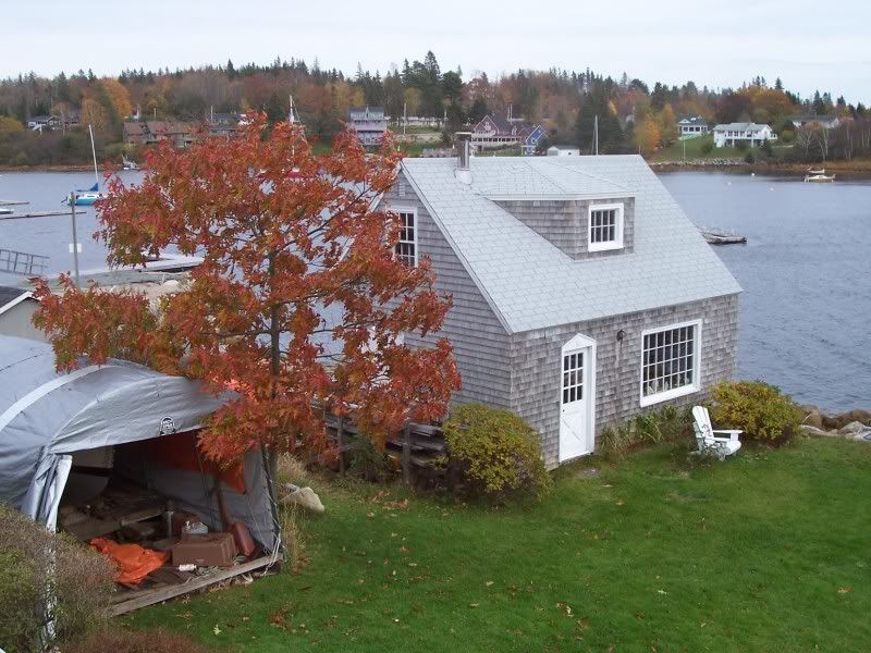

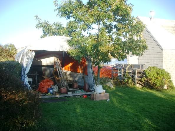

    The actual boathouse, right, is full of, well, boats - so the Maid is outside. She's been there for the past 6 years with work slow and steady, (weather and other projects permitting). Before being in the tent she had sat unprotected outside for a few years after the new hull was damaged by a falling tree.I have posted the whole story on abacoforum.com if anyone's curious. Search "Endor".
    Decks are fibreglass over thin marine ply over planks. But of course that is very slippery, so we'll have non-skid material atttached strategically. This is better, if less traditional, than the old crushed walnut shell in the piant my dad used on his schooner years ago...Better to not fall in though!
    The only other "Maid" I've seen pics of has no forward doghouse. We do, as the interior is slightly different. The mast is on a tabernacle, allowing it to be folded down back over the cabin. Therefore, there's a bit of engineering under it to do. This design also allows for access forward with no obstruction, and a tiny marine head plumbed in. My dad rescued a beautiful old doghouse from a boatyard complete with little "jail-house" bars to protect the glass on top and bronze fittings...

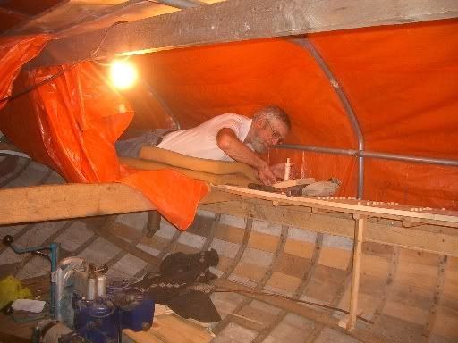

    My dad bought the empty undecked hull after it had sat for years in a builder's yard after a tree had fallen and crushed the port side. It came with a little Saab 8 hp. diesel with constant-speed (variable pitch) prop. The repairs needed were extensive, but he also replaced the garbord planks with heavier ones as well as some new ribs, knees etc.
    Here he is...
    Here the older wheathered planks can be seen. I guess althogether this boat has been 12 years since the start, lol, including several years outside. So, will she still be a "new" boat when finally launched? lol, Sure, I guess...
    Cheers
    John Peer

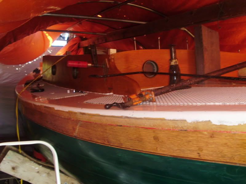

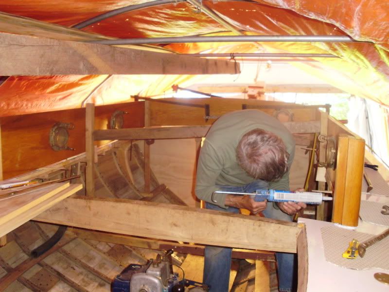

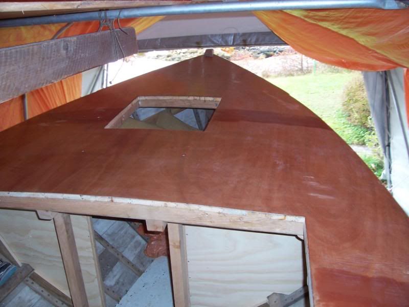

    Well here it is spring '10 already, and a launch date is set for on and about June 12th. Work has continued although my dad, as always, has been sidetracked with different projects...as well as some interesting travel.
    My folks picked up a little Siren 17 for use on the Saint John River - perfect for there, a small cuddy with enough room to sleep two and a surprisingly big cockpit for such a small vessel.
    Anyway, on the Maid:
    The hull is fully caulked, with a first coat of paint.
    My dad built the bowsprit over the winter...
    The cabin is now assembled and bolted to the deck, roof to follow
    She'll go in without the bulwarks and rub-rail finished, just to get the hull in the water (and out again if necessary!)...and the engine tested and run up.
    Here's some pics from this past weekend (May 24)
    John Peer

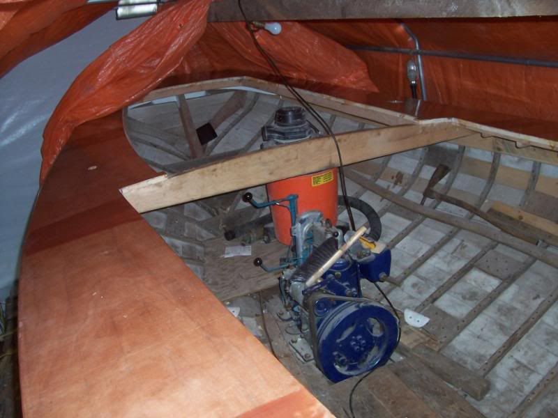

    We will be putting the rub rails on actually tommorrow after all...they're soaking in the cove for a few days and we'll be firing up the steam box first thing in the AM (Earl, if you're around, drop down...just park at the fish plant site and stroll into the yacht club, can't miss us)...the tent is off and the boat is open for the first time in 7 years...sure is nice to see her from a few feet back.
    Here's a profile view...bear in mind that there is a few inches of bulwarks not on yet, or the rub rails.
    And no cabin top of course, that will actually not go on until my dad has finished the interior work. Anyone that has tried to build in 4'6" headroom will get why.
    More caulking today on the transom...in fact she was opened up a bit too far so we fit a couple splines, and left one seam (well above the waterline) until we see how she swells...
    Decided not to paint the bronze thru-hull fittings for the exhaust or head, like how they look nekkid... ;-)
    Used "cetol" for the cabins btw, rather than varnish.
    Will likely end up painting them in a year or two anyway...white most likely.
    The "plan" is, for Friday or Sat - we'll leave her on her cradle for a few days at the top half of the tide, keeping the water below the little Saab as much as possible with the pumps...
    Cheers
    John

    ...anyone wanting to build a MOE - my dad would be glad to share what he's learned....
    It floats.
    This is the last pic I took before my cam died...but more tomorrow on the next high tide.
    Yes, she leaked a bit as the tide came up...but it didn't seem to take long before the pine swelled up and closed...At high tide we still had some leaking along the top of the garboard plank, but way less than I thought we'd have...I had like 5 pumps on stand-by...
    ...managed to keep the water below the level of the Sabb engine, except a bit of the flywheel...but it's brackish fresh water anyway...
    We'll see tomorrow...high tide is about 0900, so up at dawn to man the pumps (if needed)!
    She floated fine (on the cradle), and we were tempted to float her off about an hour after this pic, but we decided to stick to the plan even thought the leaks slowed wayyy down to almost nothing - pretty good for 12 years after the fist plank was fitted! (see history above, lol...it shouldn't take YOU that long!)
    J
  31. #66
    Default Re: maid of endor
    ...one more pic someone sent me, lol...
    She's pretty well afloat here, almost. By now, after just 2-3 hours the seams really seemed to have closed up...this was wayyyy faster than I'd hoped. My dad wasn't sure how long it would take...thinking it might take a day or two.
    We shall see. Some of the seams above the waterline of course still need to "close up"...don't go sailing yet! Still, I'm well pleased for my dad, as cautious as he remains - I can tell he's well chuffed!
    The plan is that these upper seams will close as the lower ones swell up...plus the boat is open to the rain for a few weeks anyway...(except the engine will be covered).
    The transom had seams that were so far open (about 1/4 inch!!) that my dad fitted "splines" of oak in them at the last minute...except the top seam, where any "slack" can be found as the bottom 3 seams swell....
    Cheers
    J
  32. #67
    Also, don't forget, and I expect most of you regular types kniw this, lol...there is still a 3-4 inch bulwarks (railing) to be fitted along the edge of the deck, don't worry.
    As for the cabin tops...my dad decided that he would leave those off while he completes the interior, at the wharf, over the next month or two....although he'll fit a "rough" plywood temporary top...
    Years ago, with his schooner "Peer's Fancy", he had similar "rough" cabin coverings that went on every winter, and someone once commented, from shore, "She's a beauty, but the cabin's could use a coat of paint!"
    J
