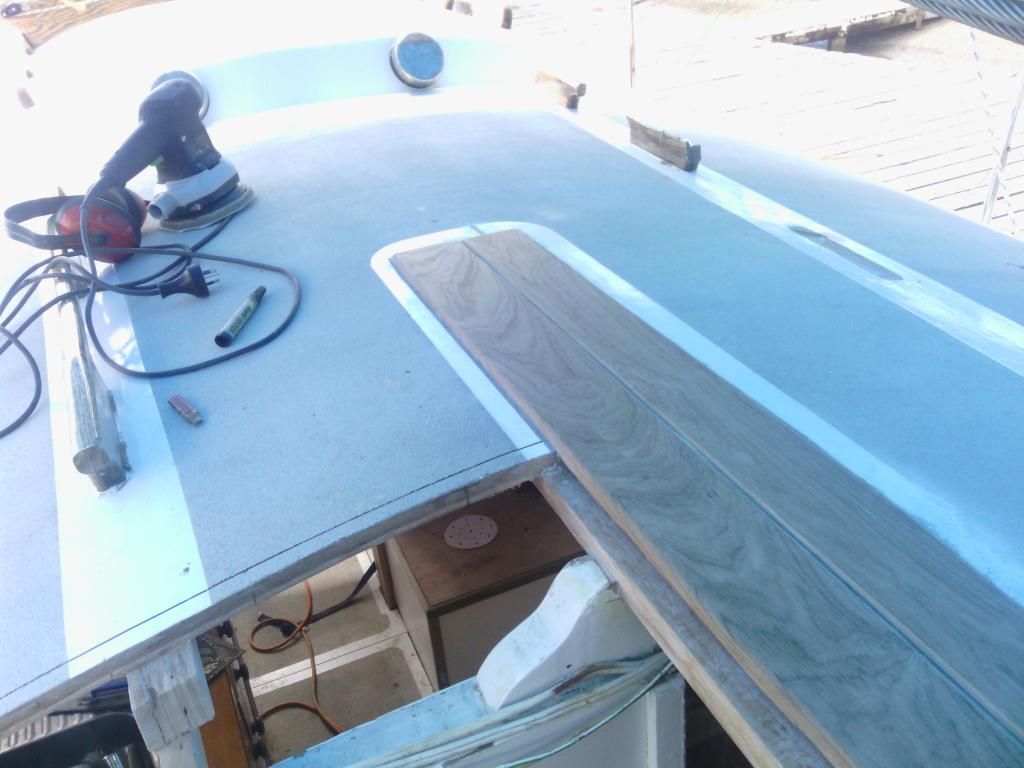

    Still dragging the fixed propeller around a year later! At least it is also dragging my race handicap down.
    Another build thread here inspired me to detail the next major undertaking I am hoping to start before Christmas.
    I need to get the mast down and rebuild the spongy mast step.
    As part of this I need to attach it to the step as it just sit in a Stainless shoe at present.
    Towards the end of last racing season I was concerned that after adjusting the rig tension it would go soft again.
    The mast is deck stepped with a kingplank that runs the length of the cabintop, and a laminated ringframe and bulkhead under this below the mast.
    I didn't keep tightening, but finally found the cause was the plywood cabintop that the shoe is attached to is spongy.
    So I need to drop the rig, and attack the cabintop to remove the rot.
    I've got a length of Teak to insert into the cabintop for the mast to sit on. The teak plank will sit on the kingplank so there is no plywood in this high load area.
    I do need to get the opinion of the local safety inspector to make sure I comply with section 14 of the Kiwi Cat 1-5 regs.
    I'm thinking a rod that goes through the deck and is attached to the bulkhead. The other end will have an eye for a bolt that pierces the mast sideways.
    That all sounds like far more work when written down.
    I am wanting to go to a regatta in Nelson in Mid January!

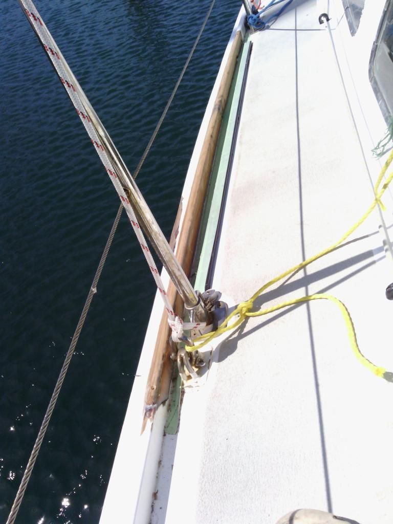

    Default Re: A bit of fill and antifoul will sort it out.
    Hopefully a shot of the offending area.
    It doesn't look like much really, but the rigging last night during the rum race was pretty soft.
    We won the race and the rum, but I was far happier when we got back on the mooring.
    It was a lot windier than I allowed for and we had way too much sail up in the end!
    That was the last sail before the work starts.
    A shot of hopefully the last version of the mainsheet/traveller connection. I just need to replace the dyneema loops periodically.

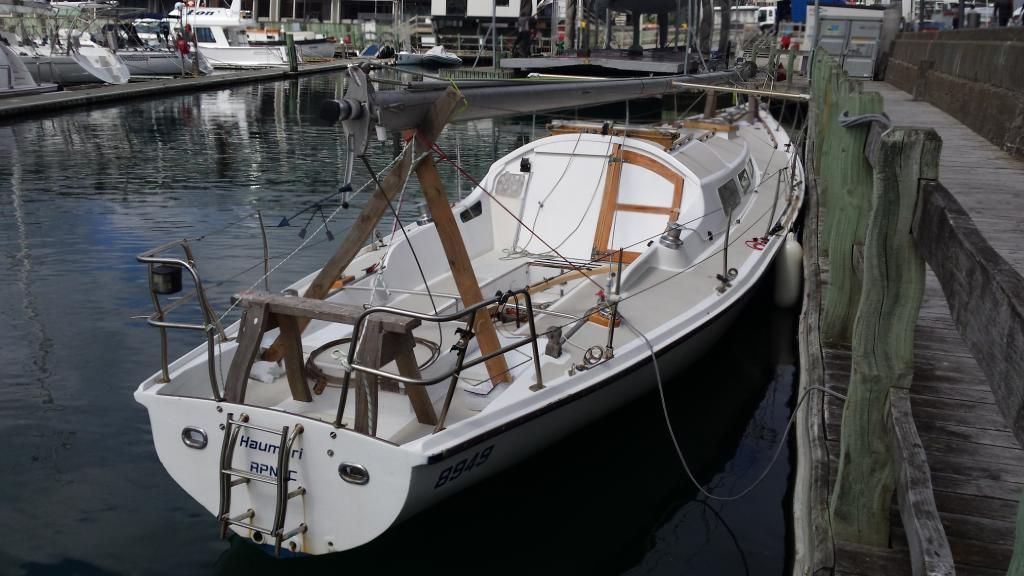

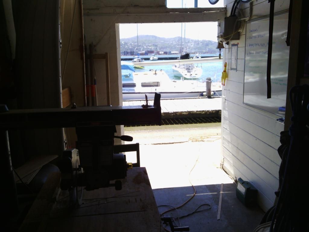

    Mast is now down on deck. Had pretty good weather for it considering how changeable it is in Wellington this time of year.
    Surprising amount of prep work required, and also how much things have changed in the 3 years since the mast went up the last time.
    Some of the rigging was difficult to remove cleanly without making quite a bit of work to put back, so there is a bit of gear dangling off the mast.
    The riggers did an excellent tidy job of securing it on deck, so I can build a tarp tunnel to work underneath.
    They did comment that the shoe the mast sits in does not have a drain hole to let out moisture, so there is a grubby wet spot under the mast that is an excellent place for rot to start!

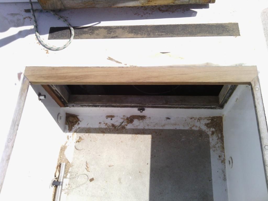

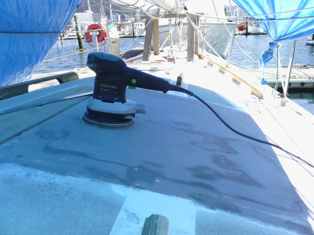

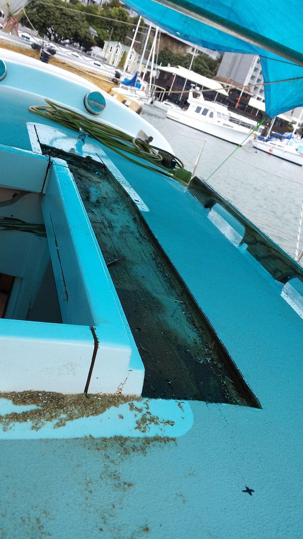

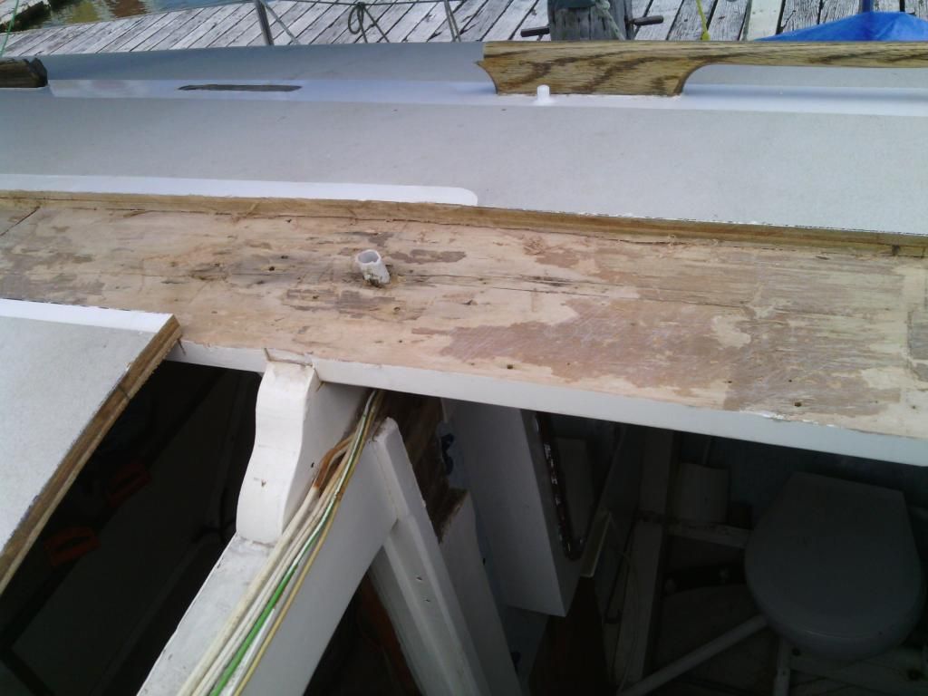

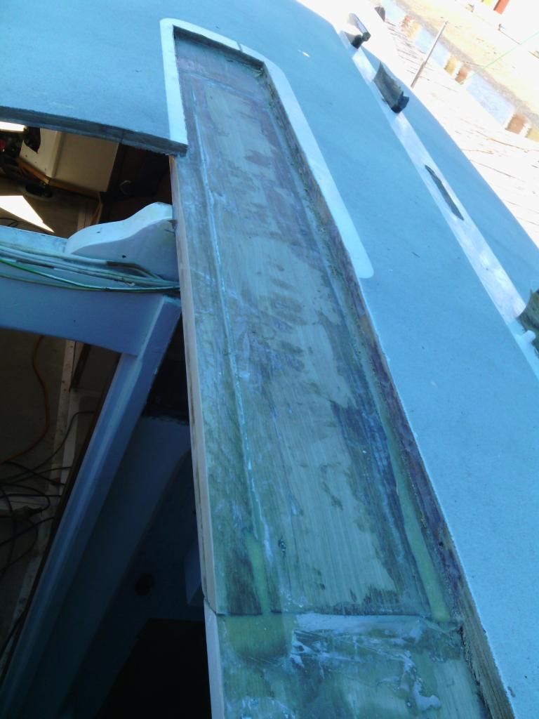

    This is the view once the mast was removed.
    The buildup of dirt telling the story of pooling water.
    Most of the ply removed from the deck where I'm going to insert some Teak.
    The kingplank underneath needs a small section replaced, which may get interesting getting it under the edges of the ply and on top of the ring frame underneath.
    That sharpie pen cross is one of my mast locators. The front of the shoe is 700 mm back from that cross, and a line drawn through that one and another aft gives the centreline. I need to try to not lose them in my destruction!
    I bought a second hand 5 Kw generator to run powertools on the mooring this week. It was cheap, but wouldn't generate power when fired up.
    Gotta love Youtube. 20 minutes of looking online gave me the answer, which was to flash the field wiring with a drill.
    Unfortunately I didn't get that figured out until tonight, so I had another day using a battery skilsaw and handtools.
    The ply was spongy on the portside around the rear of the hatch, so I have removed the hatch surround all the way to the cabin side.
    I got a bit further than this shows but the 25 knot southerly came in and it got a bit boisterous on the mooring.

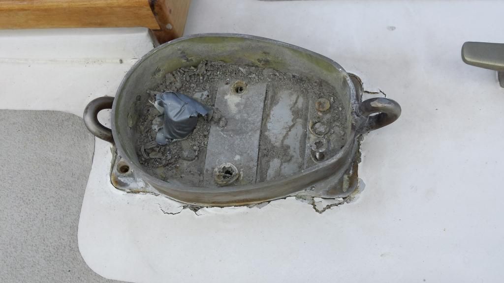

    I was now sitting with no gears and no dinghy to get ashore!
    After hailing the crew about to go out for a sail, I retrieved my dinghy from the mooring and proceeded to strip the Morse engine controls.

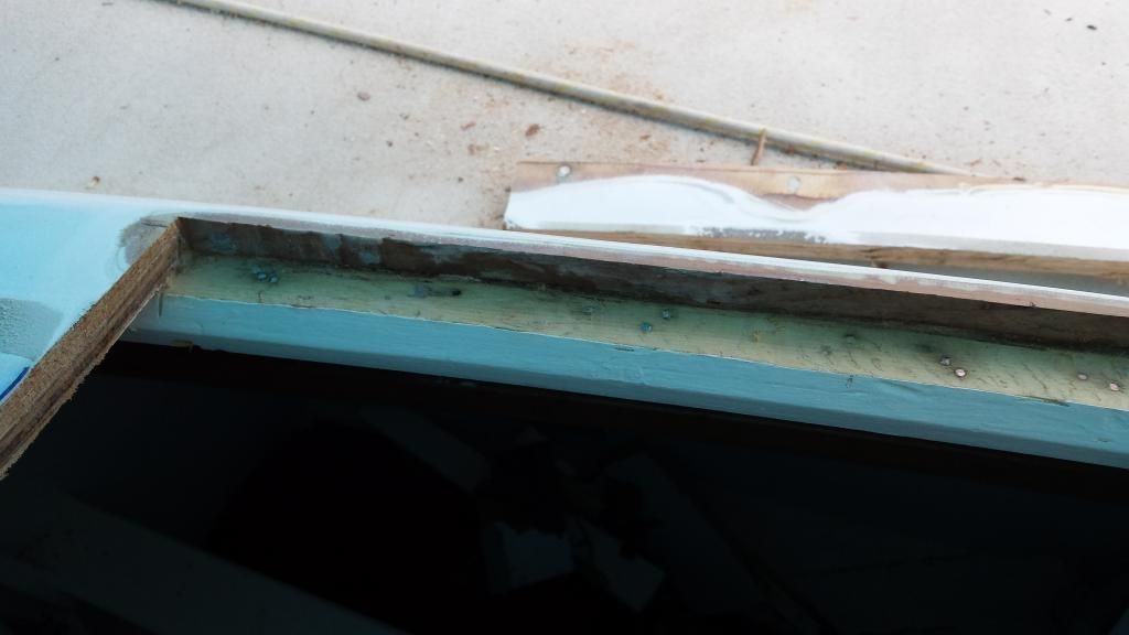

    The stud holding some of it together had sheared off. When drilled out it proved to be junk metal, and was replaced with a stainless nut and bolt through the housing.
    Unfortunately I lost 2-3 hours work sorting it out completely, but it will have been why I was still in gear not neutral as I presumed, when I hit the wall getting on the mooring the last time.

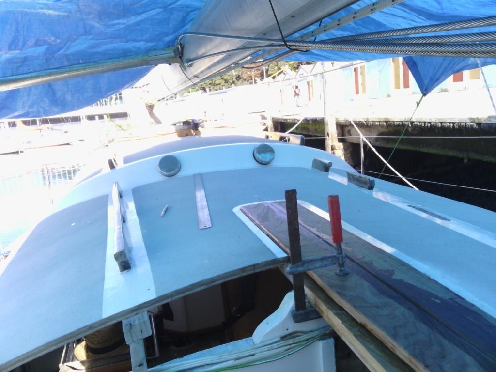

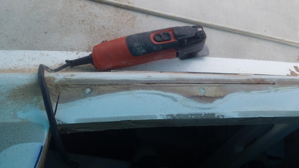

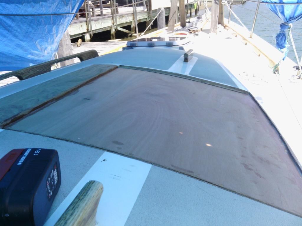

    So, I sanded the paint and glass off the edge of the cabin top to reveal the end of the plywood I am replacing, then cut it away with the Fein multitool. I still wonder how some of these tasks were achieved without this great little tool. Hard yakka being the most obvious answer.
    With that gone I have a good landing for the 2 layers of 9 mm replacement plywood I will glue in.
    I still have to cut some rot out of the kingplank and scarf a new piece in there, replace a section of handrail backing that give the first layer of ply something to shape around.
    Then cut the edge back with a router 20 mm so the next layer of ply will overlap onto the original ply.
    I can then start the rebuild part of the job.

    This is the cable penetration that caused the moisture to get into the timber, along with the screws holding the mast shoe down.
    I cut the rotten king plank back to good material and scarfed in some Tasmanian Oak recycled floorboards I had left over after running them through the thicknesser.
    The floorboards were not thick enough or wide enough, so I laminated them in place using the tongue and groove that was on them already and plenty of epoxy. I realised while doing it that a solid piece would not have been able to be inserted without a lot more deck being cut away.

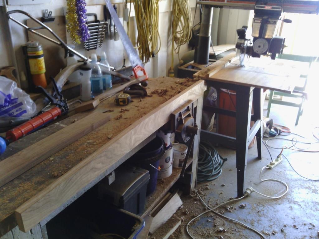

    The next day I shaped some teak to insert into the slot left in the deck.
    I glued it down with epoxy and will caulk the join to the plywood after leaving a nice groove around the teak and the groove between the 2 teak planks. The teak ended up at 25 mm thick sitting on top of a 28 mm king plank. This is sitting on the laminated ring frame visible in the shots.
    The planks being shaped in the boatshed workbench. Haumuri is tied up about 5 metres away.

    Up to New Years Eve now.
    I sanded the teak and cleaned out the grooves that will take the caulking, so this is now ready for replacing the plywood hole.
    The edge of the teak has a 20 mm deep slot that the first layer of 9 mm ply will slot into with plenty of glue. This will give me a good anchor to bend the ply down to the cabin edge.
    The black line on the cabin top shows where I will cut the top layer of plywood back so the joins in the 2 sheets are offset by 20 mm. The original construction has some joins like these and some scarf joins, so Jack couldn't decide which was required either.
    This shot also shows the missing handrails that were supposedly White Oak when the timber was purchased. They have melted away like an icecream with rot, so the timber must have been Red Oak. This basically means that I can't trust Oak from a timber merchant to be what I ask for so no more Oak.
    I will replace them with Iroko, but still not happy with the extra work.

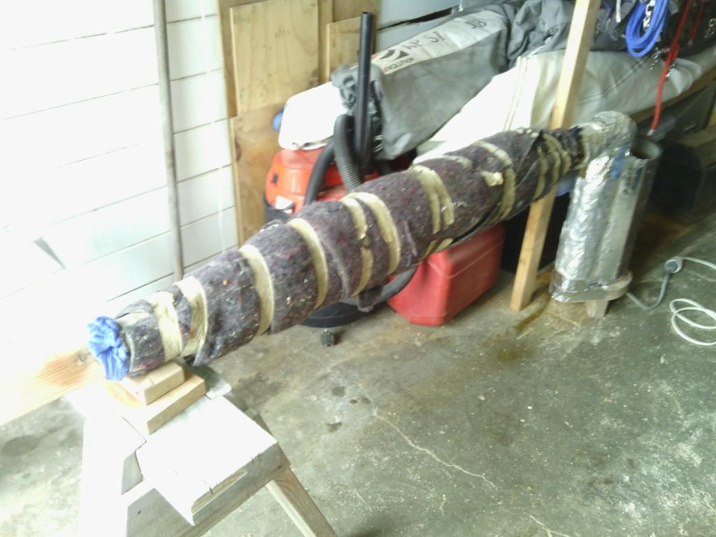

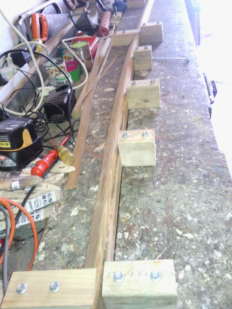

    On New Years eve I also fired up the steamer to replace a section of toerail that had rotted out.
    When I got Haumuri the paint on the toerails was shabby and I replaced a couple of sections and repainted it all.
    There is still some rot lurking within it I'm sure, but will keep doing bits as it bursts out of the paint.
    I took a pattern of the curve of the toerail and transferred it onto the workbench with a marker.
    I then screwed some blocks to the bench to bend the material around after steaming it for 2 hours.
    I had already cut the profile in some Douglas Fir I recovered from my garage roof beams.
    The steamer that I still need to take back to the owner, Oops!
    I used blocks screwed to the bench rather than clamps due to the 45 deg angle of the material.
    Those black marks are from the copper tube of the bender not fungal.

    I also made the ply panels and glued the 2 layers into place after cutting the extra 20 mm back in the top layer.
    There was a bit of trimming to get them to fit nicely, but patience got there in the end.
    This is the first layer glued into place.
    After the first layer was installed and the second ready to be glued down, I taped the inside of the boat along the joins and poured runny epoxy with glue powder into the 3 mm gap I made for this reason. I then put a nice layer of epoxy over the first layer and screwed the second one down.

    2nd Jan 2015
    The photo's seem to have dried up at the moment.
    I removed the screws holding the top layer of ply down in the morning. We are having 20 deg C every day, so the epoxy is going off nicely.
    I cut some 200 gsm glass cloth and glassed the repair overlaying the surrounding material that had been sanded back, so that the glass will feather when sanded back.
    I then used some of the left over teak to repair a section in the cockpit that tore away from the plywood due to the 6 foot mainsheet trimmer using it as a brace position.
    We had a bit of wind causing waves to enter the boat harbour after bouncing off the under wharf carpark of a new apartment complex that has been built on an existing wharf.
    We only used to have this problem if a ship was tied up to the wharf and the wind was from this angle.
    The outcome of this was an aluminium cleat was snapped at the base and torn out of the deck, Grr! Another job added to the list.
    The last thing I did for the day was trim some loose fibres off the edges of the glass and mixed a batch of filler. This got spread over the repair patch and left to go off.

    This morning I sanded the filler back with the RO sander and after checking for level with a steel metre rule, added another layer of filler in the middle of the sheet.
    I got started on the toerail repair and got it cut to length and scarfs cut to fit into the deck that the rotten section had already been removed and scarfs cut.
    I had to cut a small scupper in it to replicate the original and fiddle around a bit to get a nice fit.

    I removed the broken cleat from yesterday and cut back the Teak under it that had split. It is obviously a recent addition as Jack didn't use SS Posidrive screws. All his fastenings are copper boatnails or Brass screws.
    That bit of teak cleaned up really nice in about 5 minutes from that photo.
    I've cut a replacement, even though it's not great to install the cleats on top of a bit of timber like that. The Teak trim helps to stop the water on the leeward rail from pouring into the cockpit we new tack.
