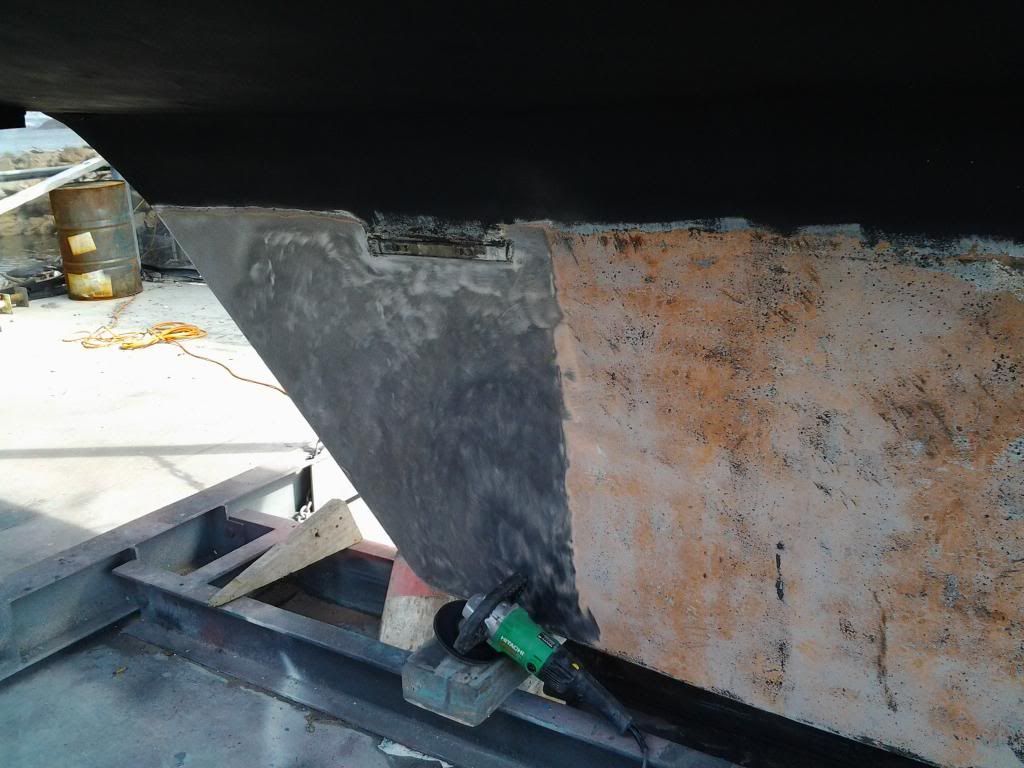

    My zinc problem has gone away. I had a scuba dive a couple of weeks ago to have a look and cleaned the hull up as well.
    The old keel had large areas of mild steel exposed to the seawater, and this is the only thing that I changed so must have been the problem.

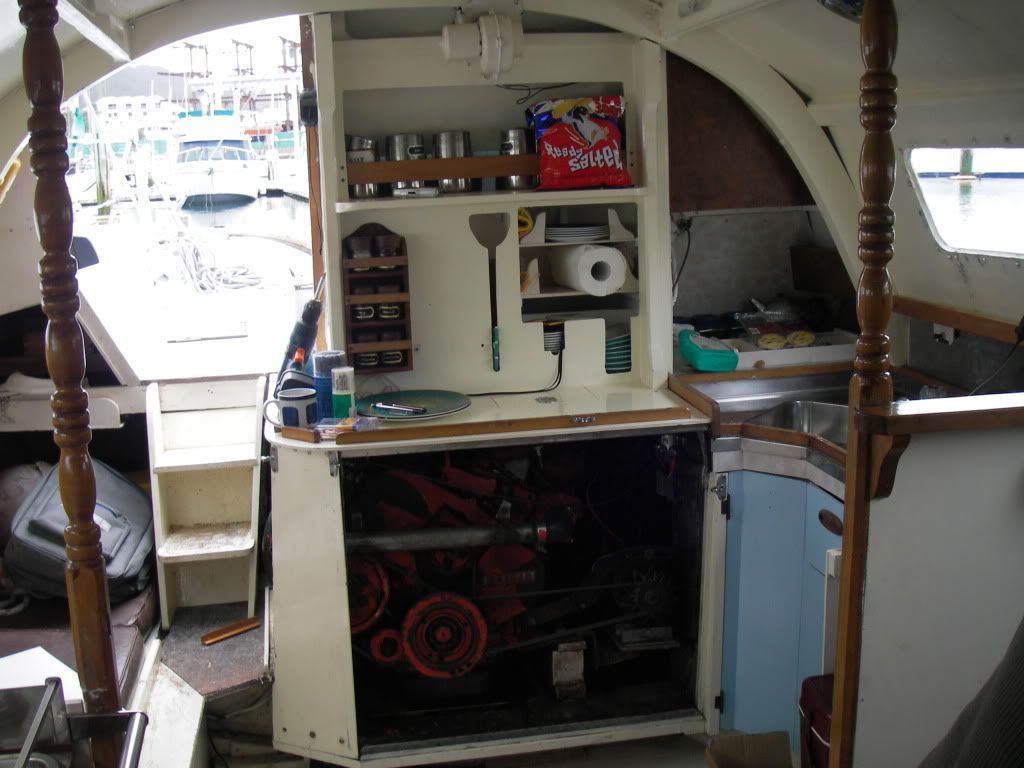

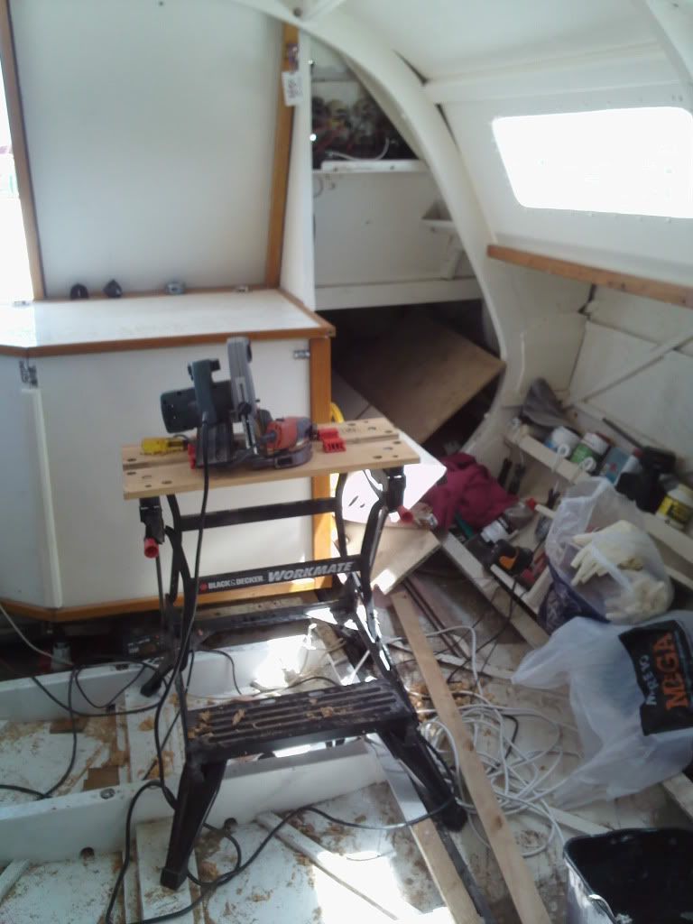

    As shown in previous photo's the main cabin interior had to be removed to facilitate the installation of the new floors.
    May Father built a new galley from recycled Kauri, which we installed on the starboard side.
    This had already been done prior to the keel work so had to be removed again.
    The original galley was on the portside as you entered the cabin.
    There was no access behind it to the acres of space under the deck. Also the top of the engine had no access for service, so all of this got ripped out as well.
    A new engine cover was constructed with plenty of noise insulation and nice access was constructed.
    The engine noise from the original engine box was 60 db in the cabin at idle! Starting the engine made a friends baby cry once.
    I've not measured it again since, but in conjunction with the waterlock muffler is significantly quieter.

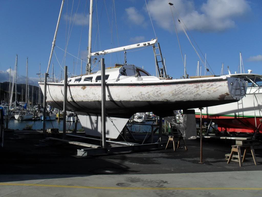

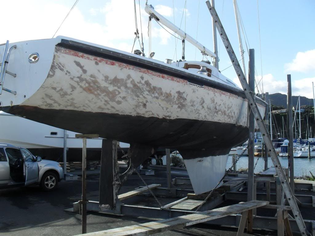

    The biggest criticism from everyone was the state of my topside paint.
    I was avoiding it because it was 2 pack that was flaking badly and needed to be stripped right back before proceeding. She is a total of 90 feet counting both sides, luckily low freeboard so not as bad as it could be.
    In Feb each year is the 3 day club regatta, with the 2013 one doubling up as the IRC and PHRF nationals for Keelboats. It is always a good regatta, so I thought I would enter.
    I formed a list of jobs to do to get her up to scratch.
    November is a quiet month, so I had her lifted out for bottom paint and tackling of the list of jobs, altering the waterline and installing the lifelines being the 2 major jobs.
    Again, everyone who strolled past commented how I must be doing the topsides as well.
    OK, so I bit.
    Looking pretty good here.

    This was after 4 days of hard out sanding.
    After the first day I went to the tool shop and got a new sander. Cost was not the issue at this stage.
    "Give me the best one you have" was the call.
    My throbbing arms carried the Festool ETS150 5 mm out to the car with a pile of 40 grit pads stacked on top.
    It got the job done, but the paint was seriously tough to get through even though flaky.

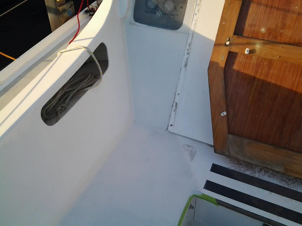

    A patch of rot has appeared in the cockpit seat that is now needing urgent attention.
    I will take the opportunity to install a cockpit locker to access the space underneath that isn't useable from the cabin.
    I've been looking on the forum and scouring everywhere I can to try to find the best design and avoid the pitfalls.
    I will take photo's of this and a couple of other jobs coming up, as I like looking at them as much as the rest of you.

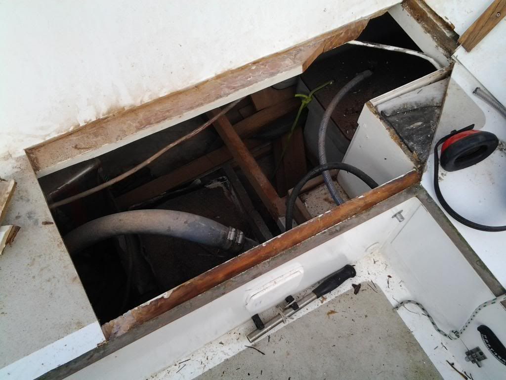

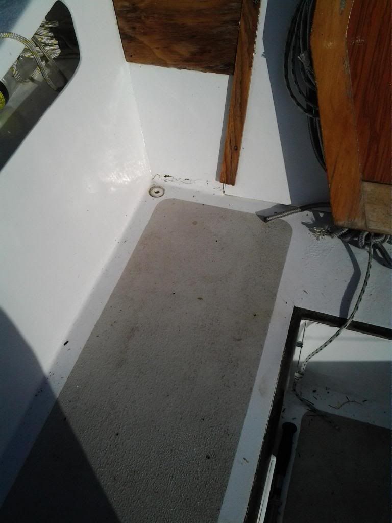

    The punky bit in the corner of the cockpit was leaking badly, and the race crew were getting worried about stepping through it.
    We screwed a pit of 6 mm ply over it for the last race but I decided it was time.
    The construction of multimillion dollar apartments on the wharf next to the marina is annoying lots of boaties, as you can see from all the crap on the paintwork. It will clean off, but normally the boat is self cleaning.
    Grr, our revenge will be setting our halyards up to ring on the mast until the end of time.
    This area appeared fine when I painted the yacht 2-3 years ago during the extended haulout.
    I'm hoping that I don't keep finding bits like this, but am sure it won't be the last of it.
    There are two spots on the toerail that need attention, but can they can wait until the next trip to the yard.
    This is being done on the water.
    On inspection I found a join in the ply deck, so that became the cut point regardless of how far the rot extended.
    The deck had felt a bit soft underfoot for a while, but there was no evidence to be seen as it was travelling in the inner layers.
    An hour later.
    The Fein multitool earned it's keep separating the Teak trim from the ply without disturbing the trim.
    The supporting timber was sound apart from one end in the corner, so this was cut back with a scarf. A new bit was planed down to size ready to be installed.
    I was planning to get it cut out, new timber cut and glued back in on the same day.
    The support timber was too wet for epoxy, so I had to screw the ply down and tape up to give it time to dry.
    There is now a massive yellow duct tape patch covering the whole thing, and I will get back to it next weekend after being away for work for the week.
    Racing next Sunday again, so a quick inspection on Saturday week will tell me if it has dried out enough to epoxy the panel down. Some fast hardener will be OK for the next day racing!
    I'm thinking it will need a bit more time though.
    I've heard you can use solvents or something to pull the moisture out. I hope someone can give me a process for this.
    I was going to put a nice wooden hatch in this hole to access some storage and the bilge pump from the cockpit. After looking at the space the pump and hose take up, I'm going to fit a hinged access hatch for servicing the pump only.
    We've got 35 gusting 45 knot winds tonight so the 2 handed racing tomorrow has already been cancelled.
    The forecast is for more of the same.

    I removed the plywood repair piece that had been screwed down and taped up to keep it dry a couple of days ago.
    Big fail with the tape, antiskid doesn't play nicely with adhesive tape so it was pretty wet under there.
    The panel went into the boatshed that has a dehumidifier running 24/7, so that was nice and dry yesterday.
    Shame I can't get the whole yacht in there, things would be a lot simpler.
    I sprayed some 70% ethanol on the wood a few times and wiped it up yesterday, and left it overnight with a tarpaulin over it to keep the dew off it.
    This morning it didn't look too much different, so I set up a small heater underneath with the tarp sitting over the outside to keep it warm.
    I used up the last of the ethanol spraying it around and leaving it to evaporate a couple of times. Slow progress.
    I spent the time mounting a double clutch on a piece of 316 SS screwed to the boom for the outhaul and 1st reefing line. The race crew will appreciate this I think.
    The single I took off I am thinking about mounting on the cabintop for the heavy end of the double ended mainsheet. The mainsheet trimmer is struggling to get it out of the cleat when loaded up. The other end is connected to a second multiple purchase system to give easy fine adjustment which works great.
    I escalated the drying regime to using epoxy thinners, and this with the sun coming out hitting the wet spots seemed to do the trick.
    So I wet the panel and everything that it was going to be glued to with resin, and then thickened another batch up with the West 406 powder and got it glued in.
    1/2 a dozen screws to hold it down until it goes off, and then painted the ply panel with resin to seal it all up. Hopefully next week I can get it sanded back, get some fibreglass cloth onto it and get it ready for some paint.
    I would rather have got the cloth on immediately, but I ran out of time. Getting it watertight was the key thing today.
    I still have to replace the upright panel that joins in that corner FWD before painting, but that will be easier to keep dry during the process.

    I hauled out for the annual spruce up a couple of weeks ago now.
    I noticed the last time I Scuba dived for an antifoul wipe that the keel had a few rough patches so I knew that I was in for a strip back (again). The steel tank sat too long after construction with a couple of coats of 2 pot primer after being grit blasted and I been having pinhole rust issues pushing the antifoul off.
    As you can see the rest of the hull could have gone a bit longer in the water.
    So, I sanded it back with the Hitachi and 32 grit paper. It only took an hour each side, stopping to get some Epoxy primer over the bare steel before it started rusting.
  31. #66
