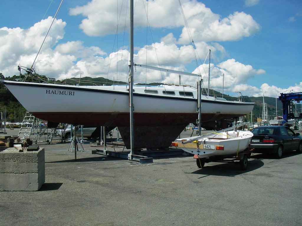

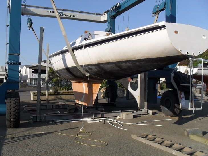

    As the heading suggests, I hauled my yacht for annual antifoul and a few other jobs. A couple of weeks max!
    We all know how badly that statement can go from reading each others topics here.
    This hopefully is a picture of Haumuri.

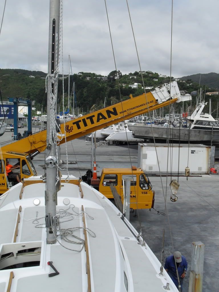

    I was planning to go to the Marlborough Sounds for Christmas holiday, so got a rigger to check the rigging out.
    He went up mast after first replacing the wire/rope halyard.
    He didn't stay long up there and told me that I wasn't going out in Cook Strait with the state of the rigging as it was.
    After a large bill that I was pleased to say didn't creep on the quote other than small bits of extra work, I used her around Wellington harbour over the next year.

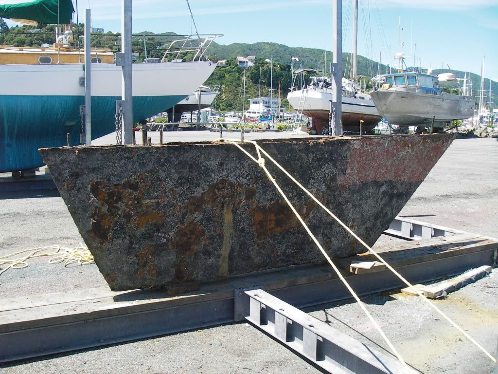

    On exit from the water, the waterblaster was ripping off piles of filler in sheets to reveal the true nature of what I had.
    Ugly to say the least.

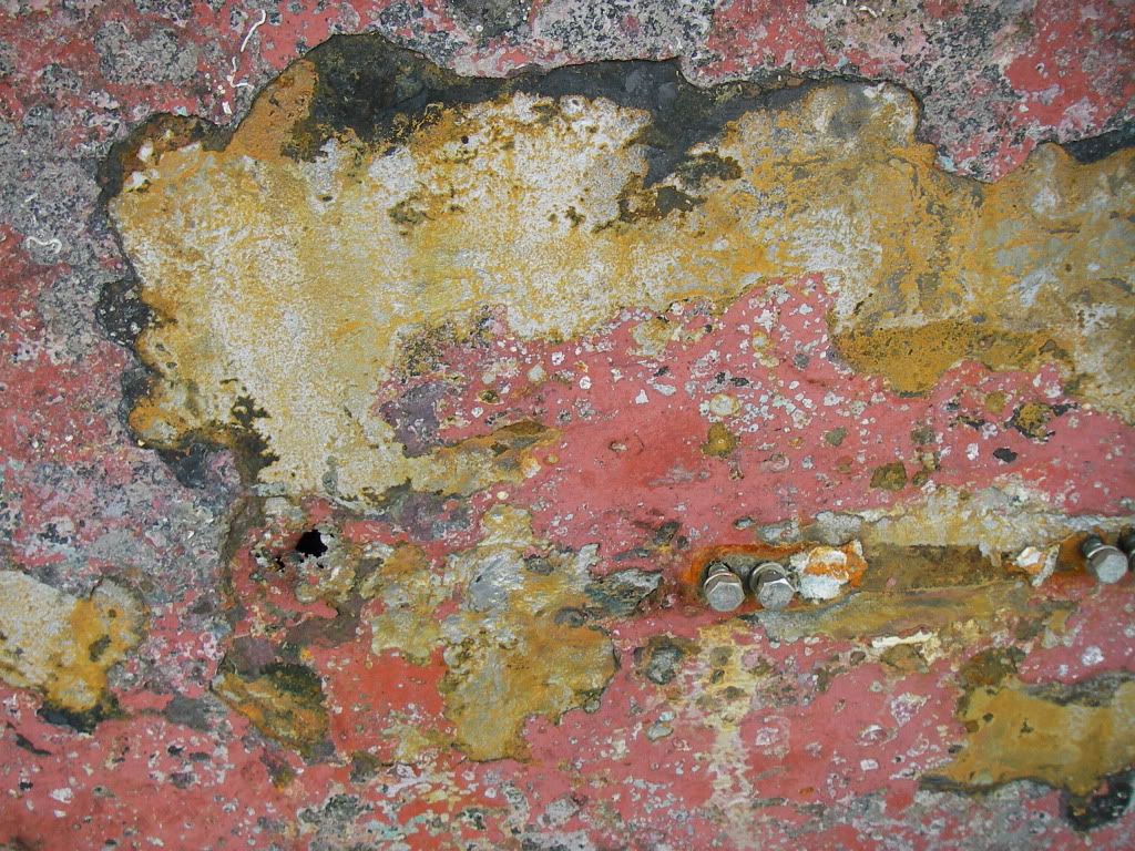

    Anyone passing, some with experience to support their comments said it was knackered. Lots of sucking through teeth etc.
    Quickly coming to the realisation that a lick of paint wasn't going to fix the old girl up, I carried on with the other work as a distraction.
    Yes, that is a hole!!
    OK, so I need a new keel.

    Looks like it needed more anode as well. What is inside the fabrication? Is it worth thinking of casting a lead keel under a wood skeg?

    If you go w/ another steel fin, it may be wise to haul every year to check it.
    I wonder if Cor10 steel would survive better. A wood fin and lead ballast bulb, as Peerie suggested, would be sweet.
    Really pretty boat, BTW, even if she's become that hole into which one pours cash.

    The hole into wich you pour cash is CLEARLY visible in that closeup of the keel. Sorry she's out of sorts. But a few bucks and she'll be right as rain!

    She was eating anodes alright. The prop one especially. I think there was so much exposed steel that the anodes couldn't cope or something.

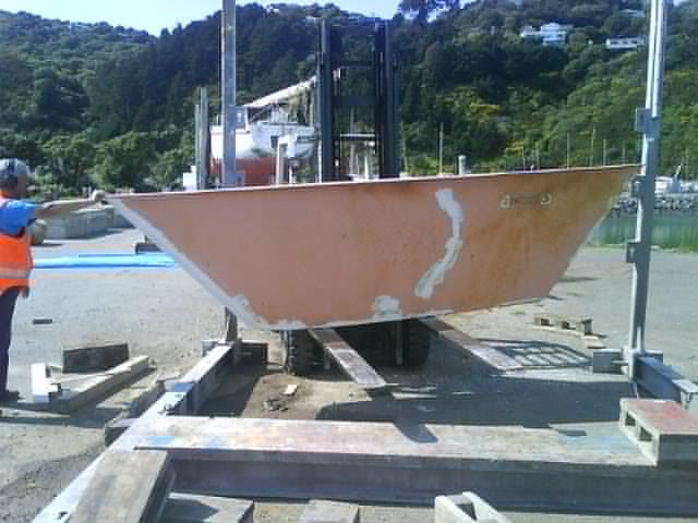

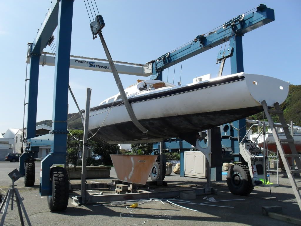

    Peerie - The old tank contained the lead/steel shot/concrete ballast and on top of that was a black water tank that flushed itself when you moved (via a hole at the front top and one at the rear bottom). Not legal these days, although there are still plenty of yachts/launches in NZ with no holding tanks.

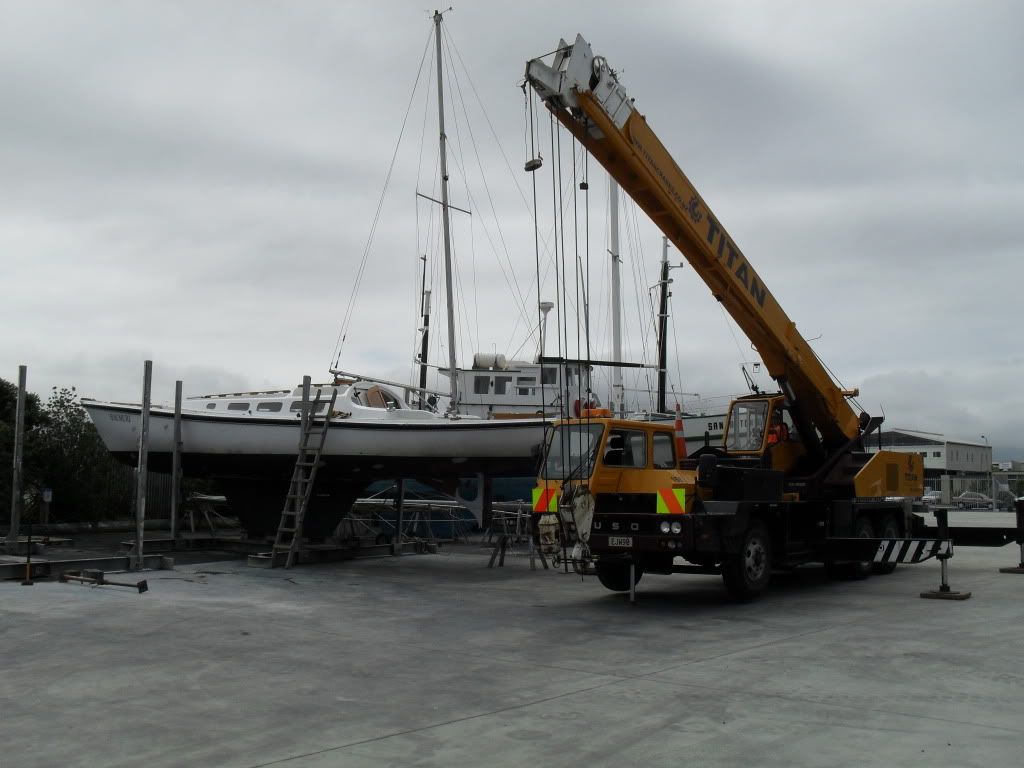

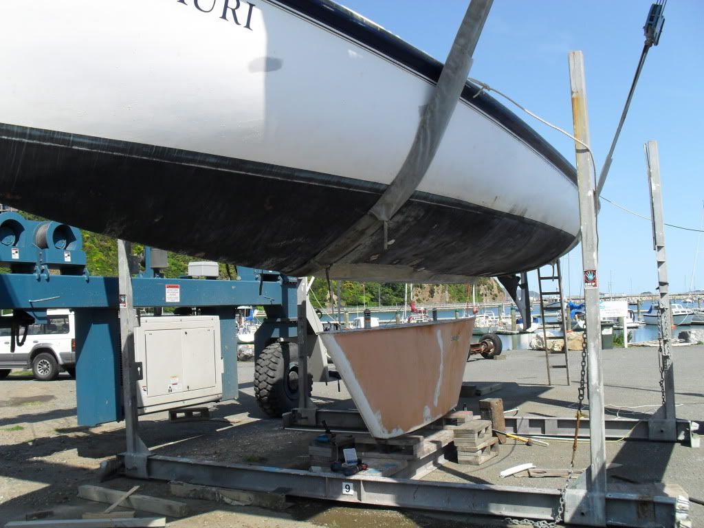

    I got Bruces drawings, some quotes for a fabricator and in a fit of energy lifted her out again.
    At the end of the day travel lift operator lifted her up an inch off the cradle so I could drop the keel.
    A bit of a daunting job was in front of me.
    I undid the keelbolt nuts inside one by one, and down it went onto the cradle.
    The yard boys said I should buy a lottery ticket that night.

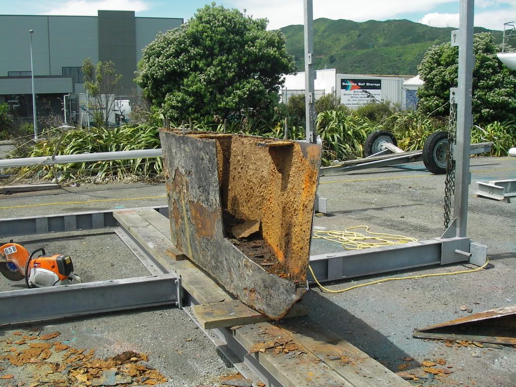

    The offending article.
    As you might see, there is no top plate on the tank. The bolts were still shiny SS even though from inside, it looked a real mess with rusted mild steel floors and rusty nuts.

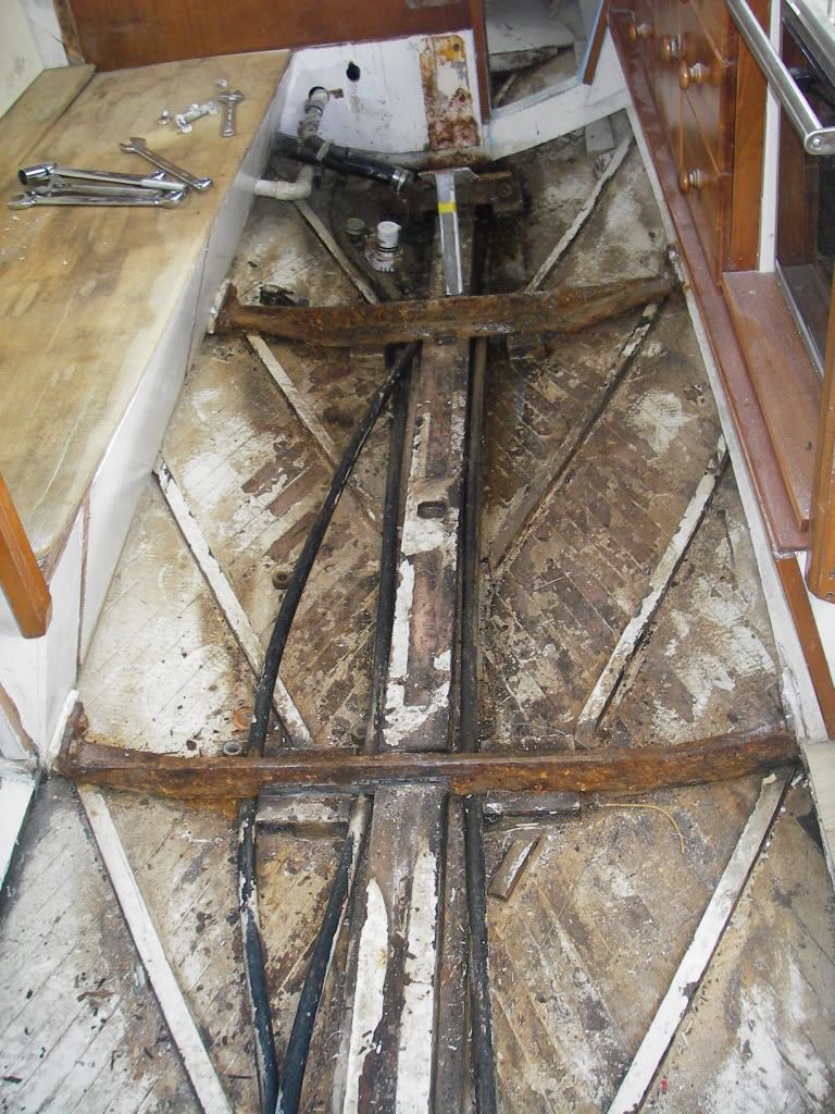

    Well, now's the time to get those steel floors out and galvanised. Have a professional design the sacrificial anode fit for you, or contact your equivalent of these for a package: http://www.mgduff.co.uk/

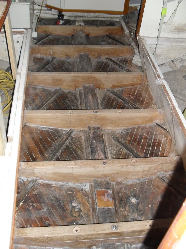

    Your last pic is really very interesting. I can not remember seeing planks ona diagonal before. I know thsat they were done that way on the build-up done on the Constellation here in Baltimore, but I doubt having seen it on a yacht.

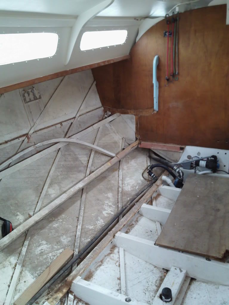

    Yep, those steel floors definitely came out.
    The diagonal planking is a bit more common here, but not so common in the configuration I've got. There is only one layer 1 inch thick, glassed over the outside.
    The designer for the new keel, Bruce was scratching his head looking at how she was constructed, which made me sit up. He said that Jack (the designer/builder) was a canny bugger.
    As part of the new keel design, he asked what I planned to use her for. I mentioned that I wanted to go down the West Coast around Fiordland for an extended cruise. The drawings that I got therefore reflected sailing in the roaring 40's with hundreds of miles of prevailing lee shore with no shelter.
    The photo showing the steel floors shows all of them except one the other side of the bulkhead up front, that connected the keel to the mast support post and bulkhead. The new design uses 10 oak floors, so it got beefed up just a little!
    Every boatbuilder who comes on board has a good look around as well with regard to construction.

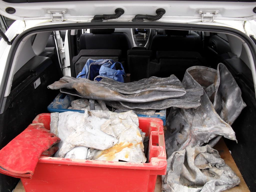

    The next job was getting the lead out of the old keel and getting rid of the remains of the steel. Some sweat was given up on this. I also sacrificed quite a bit of cutting equipment in this operation.
    The Stihl 012 with cutting disk made short work of the steel, easy.
    The lead proved harder to break up. I quickly confirmed that metal cutting gear doesn't work too good. The wood cutting gear with plenty of lubricant was the answer. Putting the skillsaw across it for the first cut was a leap of faith, successful but ultimately futile as the block was 400 mm wide so I couldn't get a deep enough cut. Sabresaw wasn't manly enough (too slow).
    The chainsaw came out to play!! The small McCulloch that I had for sawing firewood gave up it's life in a brave, stubborn way with moment of hilarity. It stopped once when I lifted the throttle for a moment. On inspection it was clear what the problem was. The vibration had caused the carburetor to fall off. Phew, that was lucky!
    At this moment I would like to apologise to anyone here that was trying to relax on their vessel in Seaview Marina, Wellington on Boxing day 2009. That little saw had a particularly tough exhaust pitch to put up with.
    Anyway, it eventually completely fell apart, but still ran!
    I went to the local hardware store, and with the neighbours in mind bought an electric chainsaw. Wow, nice and quiet. The new blade went through the block like a hot knife for the first cut. Part way through the 2nd cut the internal clutch gave up the ghost, damn!
    I took it home, stripped it and gave it a good clean to get rid of the lead chips. I got it run enough to cut some wood, and took it back to the store. They decided to send it away for repair, so I was without saw again.
    I bit the bullet and bought myself a petrol chainsaw. Using this hurt a little coz it was now my new firewood saw.
    Now at least after short work, I had lumps of lead I could carry (just).

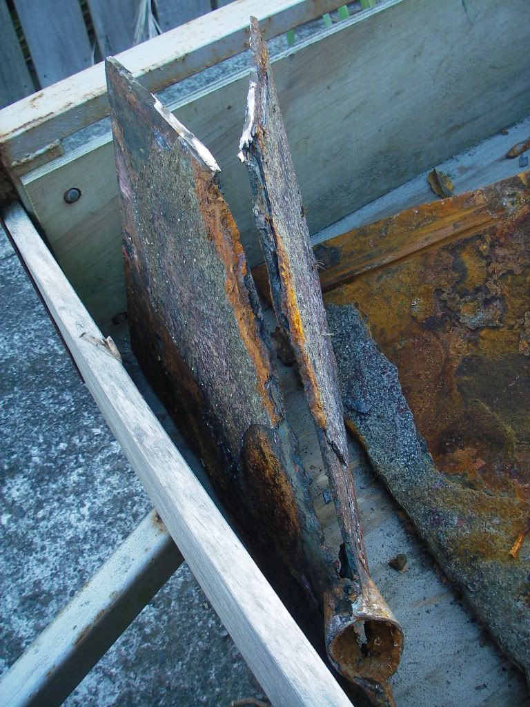

    This photo shows just how bad the keel was once all the fill that someone put in fell out. Scary to say the least.
    I couldn't do this and be able to sleep at night. Imagine seeing a yacht you once patched up, upside down on the news with no keel and missing crew!
    This is the leading edge of the keel showing the side plates not connected except by a bit of epoxy.

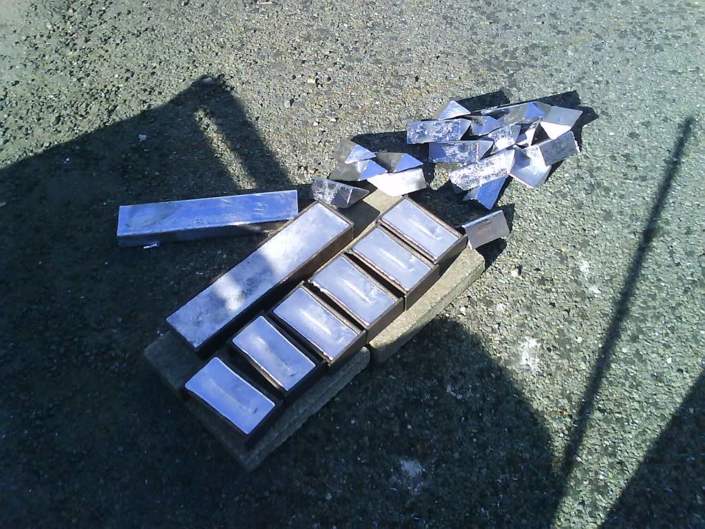

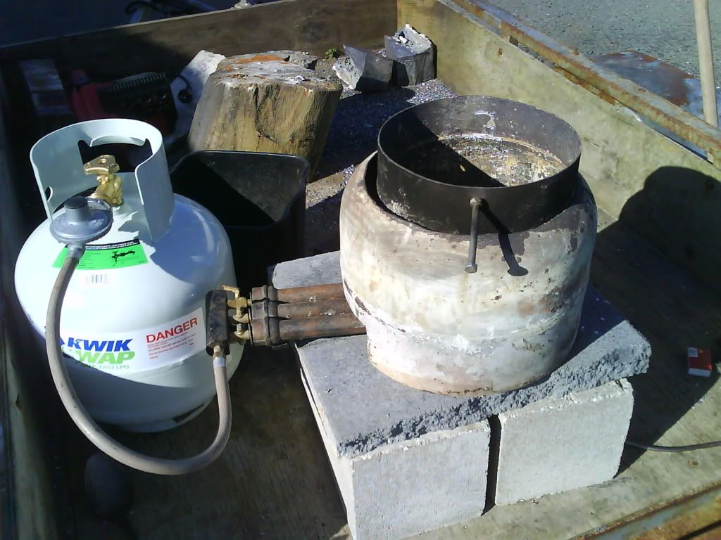

    One of the other guys in the yard was melting ingots for ballast, so I offered to buy his kit after he finished as it worked pretty well.
    The pot is made out of a 6 kg gas bottle with the top cut off, and the heatshield is a 9 kg bottle cut to suit. Typical Kiwi use what you've got attitude. The burner is a concentric ring unit available from any Asian cooking suppy shop.
    All I needed to supply was the regulator and bottle which I took off the yacht BBQ.
    Here it is assembled on my mobile smelting rig with pavers for a bit of insulation. The trailer got it up to a nice height to work.
    The raw lumps are in the top right corner. The electric chainsaw had obviously come back from repair by this stage and was being used to knock the lumps down a bit more for melting.
    I got 2 sizes of moulds with my kit. The bigger one was about 12 kg on average and the smaller triangular are about 1.5 kg.
    I melted from memory about 1500 kg this way over a few sessions, with no serious problems. I needed quite a bit of extra lead, so had to buy it from the local scrap metal guy.

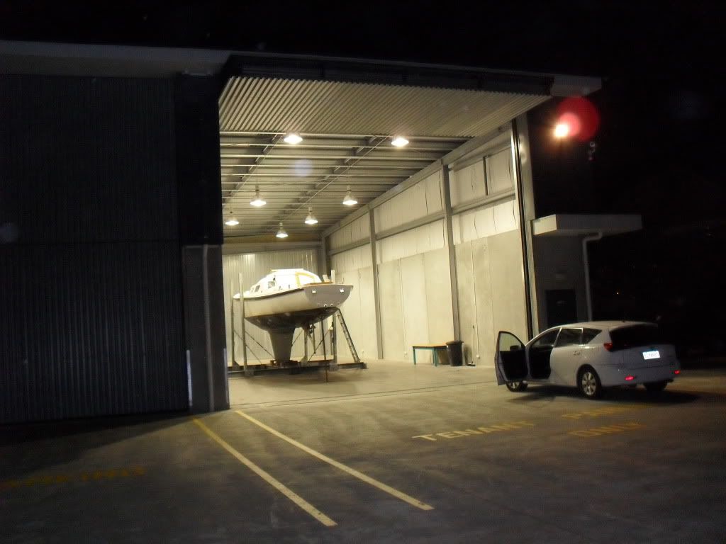

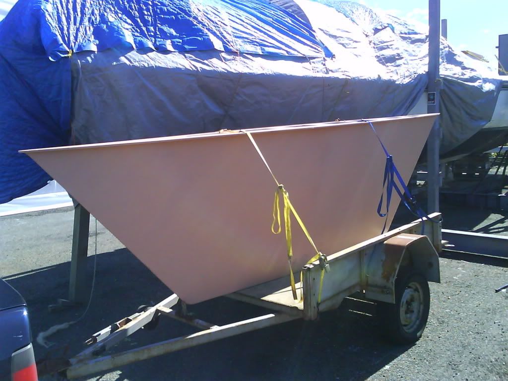

    Here is a shot of the keel after picking up from the sandblasters with 2 coat primer on it.
    It was fabricated within view of the yacht and blasted about a km down the road, so the topheavy loading wasn't a problem for transport.
    I lifted it off the trailer with a mobile engine hoist, and it was ballasted sitting beside the yacht.

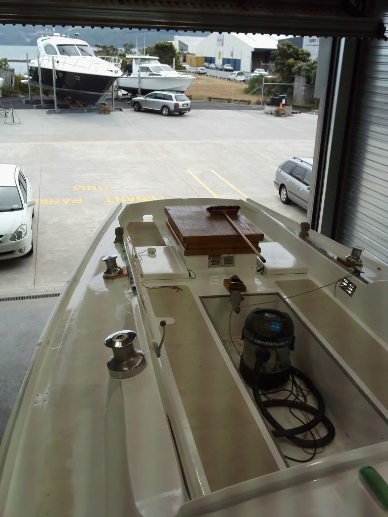

    While this was happening there were also a couple of other issues to sort out.
    The new wooded floors needed to be installed.

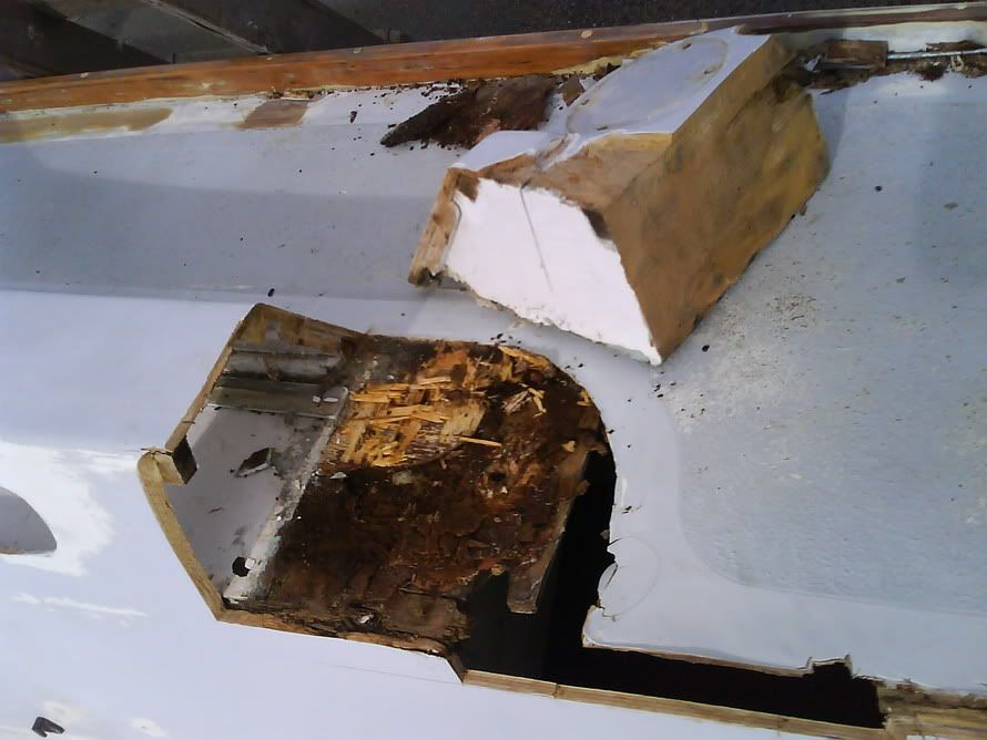

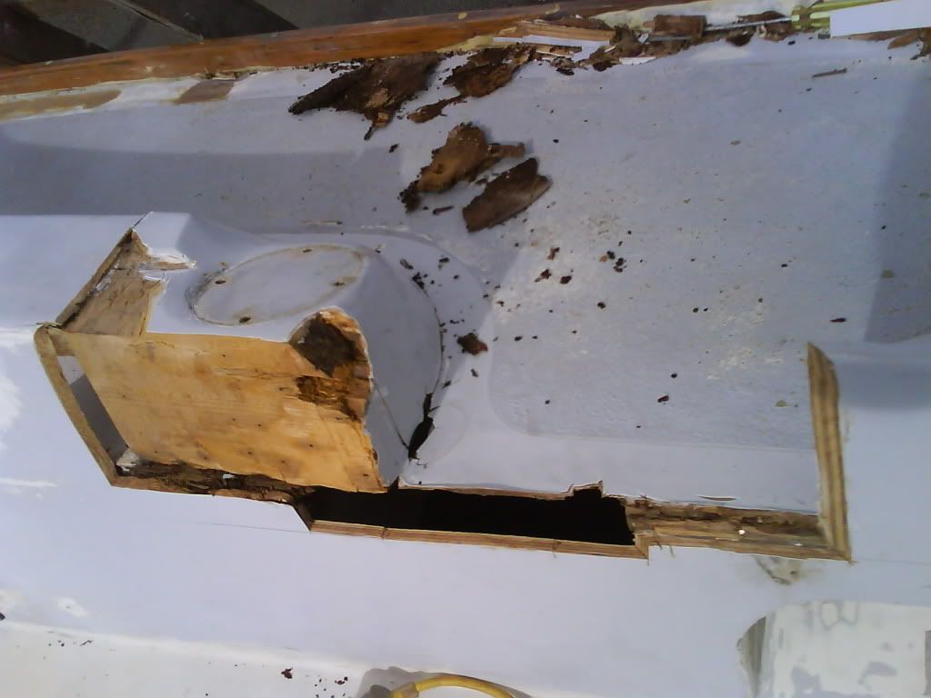

    There was also the Samson post that snapped off with rot in a storm. I was looking at it dubiously, so one of the bow lines was always on the winch.
    The cockpit floor was straining any water that got in there at best.
    There were many other little leaks about the place and the stanchion mountings were decidedly dodgy.

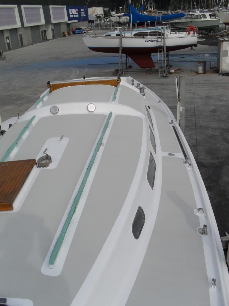

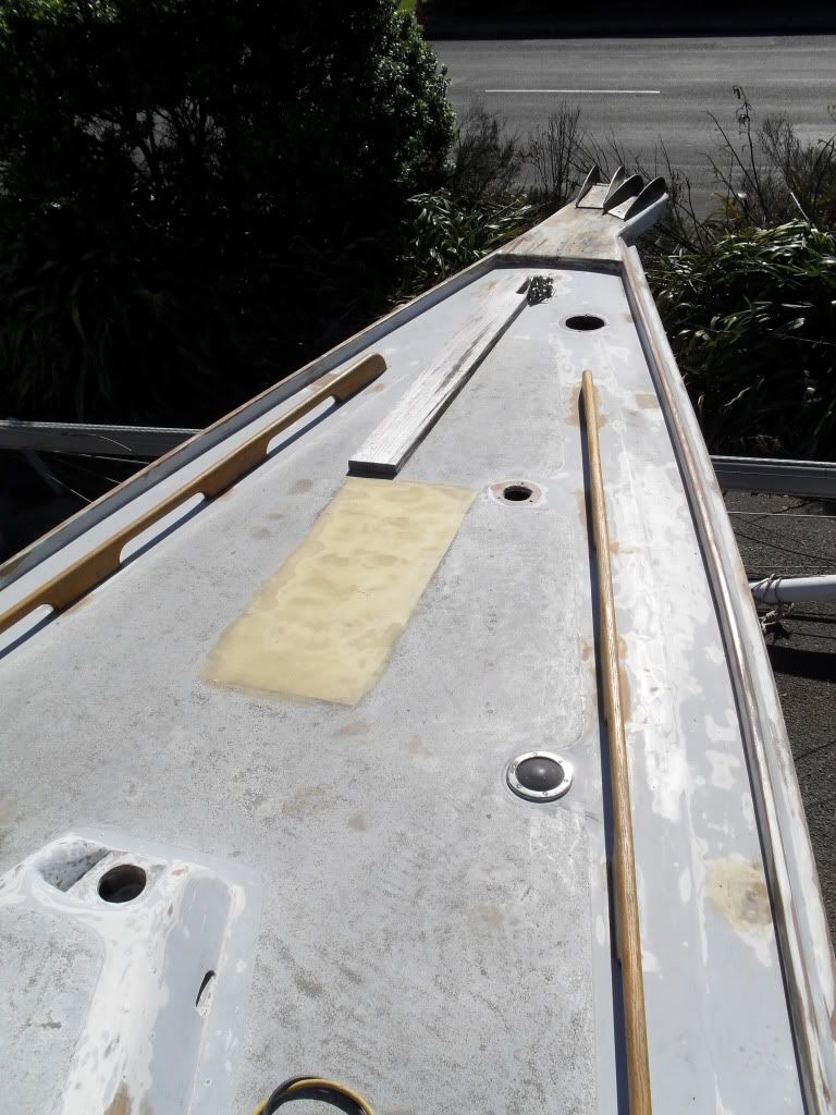

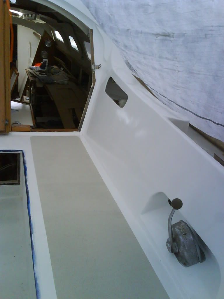

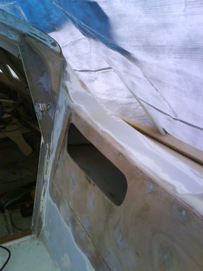

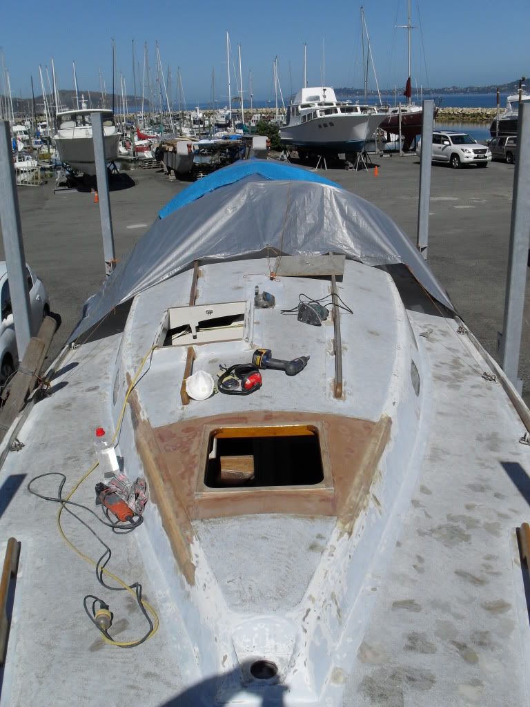

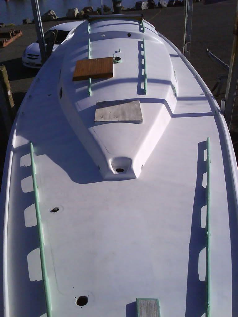

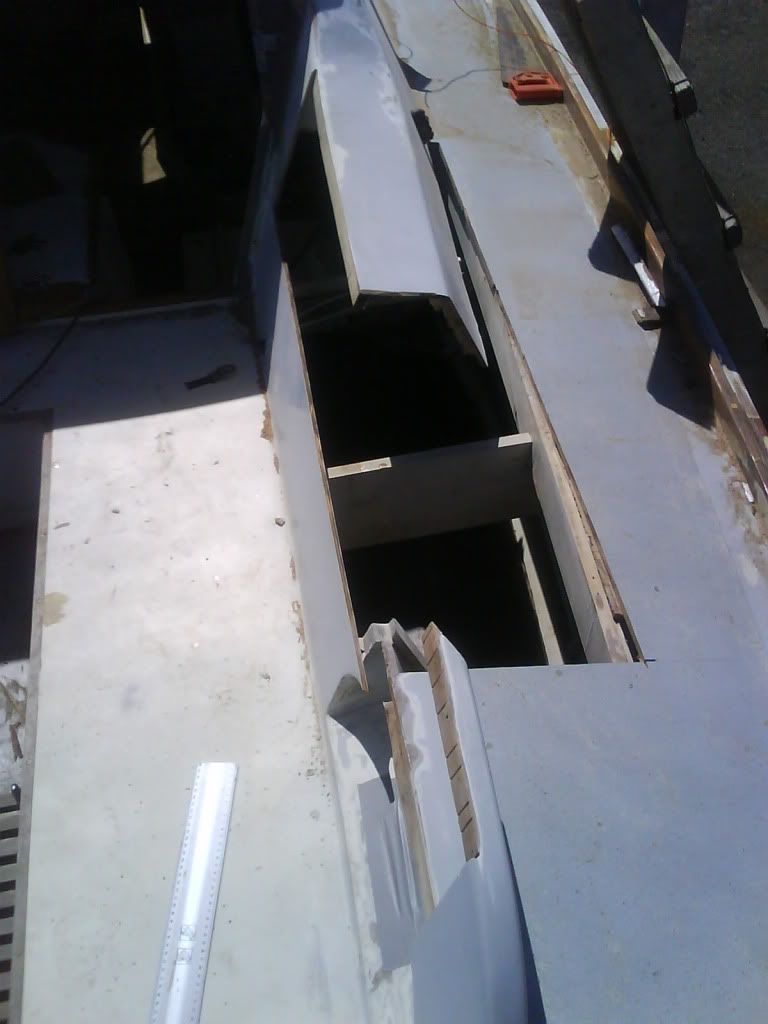

    I started by getting the skilsaw out and started cutting the glass over ply deck around the hole left by the Samson post looking for solid structure.
    I ended up standing in the hole, with rotted deck beam removed, and king plank arrangement also cut back to good material.
    No photo's of the process, but the wood butchery had started!

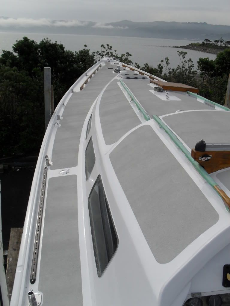

    This shows the finished repair with 2 layers of 12 mm ply and plenty of glass and West over the top.
    This also shows the beginnings of sanding the antiskid. It was sand, set down with epoxy. Great non-skid surface but it had at some stage it had suffered a repaint with 2 pack paint that was a bit flaky (no prep at all by the look).
    So I had to sand it all off. The sanding quickly escalated from a beltsander, to a 10" variable speed grinder with a rubber pad and 25 grit paper. The paper was only just rougher than the deck, and any heat caused the paper to lose all bite. If I didn't keep it reasonably flat the sander would bite through and the plywood would disappear. I was getting about a metre of side deck done per hour on average. The Chiropractor was the winner from this operation. I could only really do an hour of this a day with out serious downside for my back (and sanity).
    My wife was also sanding the inside of the cabin. She is able to keep at this far longer than I can, sanding for hours overhead with a mouse style unit.

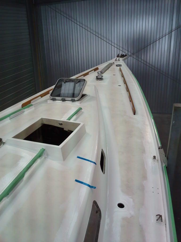

    I turned up one afternoon after work and was shown an area over the Forepeak. After sanding the paint off there was a couple of plys completely missing underneath. The fixed ports in the deck had been leaking, with the water staying inside the ply and running along the end of the ply for awhile before dropping out over the sail locker further back.
    The skillsaw came back out and it became clear it was easiest to take it back to the cabin upright side and insert fresh ply right across. The curve of the cabintop is pretty severe here with 2 layers of 12 mm ply again. I cut the top layer of the existing cabin top back 50 mm extra front and back for the top layer of ply to land on.
    I also had to make the timber moulding that formed the curved edge and for the plywood to land on either side of the cabin for one side.
    The first layer got glued and screwed to these timbers with the middle being held up by the kingplank that runs the length of the cabin roof.
    This was obviously how it had been done from new because the curve was perfect. The second layer was glued and screwed down over the top and fitted nicely as well.
    I liked the extra light and air the big hole allowed into the area, so an opening hatch was purchased and cut into the plywood I had just glued in.
    An oak frame was made up and glued/screwed into place.
    The tarp is over the cockpit because by the time this photo was taken I must have attacked the cockpit also.
    The lump of square plywood in shot was screwed down to the hatch frame for quite some time after this to keep the water out.
    I had also removed all the deck fittings and stanchions and drilled the screwholes out with a cone cutter big enough to see that there was no rot.
    There were a few small patches of ply that needed to be replaced, and in a couple of spots the Sheer clamp had have new material scarfed in due to the leaking stanchions. Boatbuilders love Stanchions, they are the source of most of their income where repairs are concerned.
    The Fein really came into it's own here, cutting scarfs inside small lockers was heaps of fun.
    All these holes were then filled with Epoxy and glue powder.
    I ended up with virtually no penetrations in the deck. It would be nice if it could stay that way!
    The backstays mountings were actually in the worst state.
    I spent many hours upside down 1/2 sticking out of small deck hatches learning how to block out the pain.
    I also learned to ignore the fact that I was stuck, and calmly extricate myself without freaking out.
    I didn't document this to the usual standard here sorry, but I did lose a camera at one stage.
    It could have been built in somewhere maybe!!

    The next job was the cockpit. I managed to get a tarpaulin cover to stay on this for the duration of the work back here as there were some pretty big holes for the rain to get in otherwise.
    I replaced the cockpit floor and part of one side of the floorwell, but have no photo's of this work at all. This must have been when I lost the camera.
    I then had an area of rot that I had found by poking behind the winch base.
    I cut the side of the cockpit off to reveal some pretty ugly stuff. I'm glad I had started at the bow because this was looking pretty daunting even after the work I had already done.
    After cutting the outside and top of the coaming away from the winchbase it was removed easily to show the remains of the deck underneath. Ouch!!
    This was a solid block of Kauri that was too far gone at the bottom to be useable again.
    The side deck was removed forward to a sheet join and sideways to over the stringer up underneath.
    The inside coaming was also removed, I think to get at the cleat underneath that was rotten. I was able to use it as a pattern to replicate the opening shape. The cleat was replaced, and a new piece of ply slid in under the coamings. Butt blocks were used under the deck where the ply was joined to the original. The decks are single layer 12 mm with 200 boat cloth over the top which is minimal.
    I took the rotten winch block home and laminated a block out of Kauri.
    This was then shaped to match the old one, but I made it level with the coaming to correct the poor lead from the genoa car that constantly caused overides. I was surprised how quickly I got it to the shape i needed, as I was learning at every step what to do.
    I think I used a belt sander quite a bit which doesn't quite meet the usual methods here.
    New block snugly in position with plenty of Epoxy. The winch is bolted through as well, so I was happy with the attachment.
    New Inner coaming fitted, and also shows the new knee that went into the doorway.
    Mmmm Shiny with two topcoats on.

    I had taken a pattern from the old keel shape to compare with the new top plate to see how it was going to fit.
    Once the new keel shape was lofted out it came clear that the new top plate was longer and wider at the front. I was going to have to add to the shoe that it sits on.
    A few phone calls later I had someone who knows what they are doing on the job. The pro boatbuilder did this and bound it all together with 2 layers of triaxial cloth and pox that ended up about 5 mm thick in total.
    He then moved on to the Oak floors. These were shaped and prepared for installation.
    The plans called for coachbolts in each end of the floors through the stringers, bolts through the floors and into the deadwood.
    They also to be screwed to each plank and glued down.
    After a bit of discusion, it was decided to drill the floors for the keel bolts prior to installation, then use these holes to mark the top platte of the keel for drilling. This allowed the holes to be drilled in a bench press and get them nice and straight.
    So the interior needed to come out to access the stringers.
    Visitors to the old girl now freaked out about how much work I had in front of me putting her back together.
    Tony wasn't adverse to advising me how to progress with the other jobs that I was doing so I got boatbuilding lessons included in the hourly rate. This gave me a heap of confidence that I wasn't making a complete hash of things.
    He even didn't charge me for the time we spent gas bagging about all and sundry.
    So now I had a keel sitting beside a yacht with all the goodies required to make the one. Gulp!!

    The rest of the deck/ cabin had a couple of coats of epoxy primer, then final fill of all the bits you don't see until it is all the same colour. A couple more coats of primer got me to this point.
    I now drilled a couple of hundred holes in this nice surface to mount all the deck hardware. All the holes were drilled oversize and countersunk on the deck side. This gives the deck sealant a place to make a nice gasket. The hole was then reamed with a small bottle brush to coat the holes with unthickened epoxy. The holes then got redrilled with the correct size for the screws/bolts.
    I then put 2 coats of 2 pot undercoat over this.
    Ohh, and sanded lightly between each coat just for fun. I stuck to the min/max coating times as well, just make it more fun.
    The 2 topcoats were then applied to the areas that wern't going to get antiskid.
    The first one went well and looked pretty nice. Another bit of sanding then the final coat.
    This was all being done out in the open, and the weather had been playing nicely as well.
    I had to go away for work at this point, so the wife (who had been involved in this from the start) put this coat on.
    When I got back the final result was really disappointing. All the horizontal surface that were painted from half way down the boat were flat and a bit rough.
    I was confused because nothing had changed other than it taking a bit longer with only 1 of us working on it.
    We sanded it back again and gave it another coat. I was using about 1 litre per coat, so while expensive it wasn't too bad.
    Same result!

    So, to fit the keel I needed to get the yacht out of the cradle, put the keel in the cradle.
    This cost a box of beer to the courier company across the road.
    Then lower the yacht over the keel, got her lined up with where they are supposed to meet.
    Plumb bob and lines marked on the bow and front of keel with plenty of eyometer squinting from anyone interested later it was decided that we were ok.
    Next trick was using a loooong drill, mark the top plate of keel with a scratch.
    Yacht then back out of the way to drill the holes for the top plate. Crikey they were where they should have been!
    Yacht back down and double check all the bolts fit, wahoo!
    Yacht back up, smother the top plate with 5 litres of epoxy and glue powder like a big birthday cake.
    Finally the two are joined together, bolted up and left in the slings overnight to harden off without moving.
    Rental for the day of the travel lift, Ouch! I did also get the services of the operator (who happened to be a boatbuilder), who was awesome and helped me get it done before the goop went off. That was alot of epoxy setting off by the minute!!
    That was one tough long trip into the unknown with the potential for trouble giving some loss of sleep in advance.
    In the end it went swimmingly, with only a couple of things that needed a bit of attention as I went.
    The lift operator got to leave on time at 5 pm, so everyone was happy! I went home and slept well that night.

    It was great see her travelling down the road in one piece heading for the shed, no photo's as I was directing traffic. Some people shouldn't have a driving licence, seriously.
    Once in the shed I got another coat of 2 pot undercoat on and 2 more topcoats on, with plenty of sanding and cleaning in between. All this paint was applied with 100 mm foam rollers cutting in with disposable brushes. Everything goes in the bin at the end of each coat.
    I started mounting some of the bling that had been sitting in boxes in the forepeak for quite some time. This was the most satifying part of the whole job I think.
    The toerail stripe also got touched up at this point.
    In between coats, I etch primed the keel to kill off any residual rust from sitting around for awhile then a couple of Epoxy primer coats over the top.
    The first coat of antifoul went on to the touch dry primer to give them a chemical bond.
    Late finish, but looking good tucked up for the night! This is all cleaned up ready to come back out the next morning.
    Wickedly expensive way to work on your boat, but you can kill off a heap of work when it's not weather and daylight dependent.
    After a week or so to harden off nicely I then spent most of a day masking the top coat and scuffing anything exposed for the antiskid paint. I traced around cans of various sizes to give nice radius for the corners, then cut the masking tape away.
    The antiskid is rolled on with a high solids roller, and it was pretty tricky stuff to get right. The first 2 coats looked a bit of a dogs breakfast, but the 3rd one came up pretty good. In hindsight breaking the antiskid up into smaller panel would have made this easier but I don't like the look of that.
    If you are real fussy it wouldn't suit, but it is excellent at doing what you want an antiskid to do, ie stopping you from falling over on a pitching foredeck.
    Some of the other products that look nicer are really crap at the basic reason for putting it there, I've spent enough time doing foredeck on racing yachts to be able to tell from the dock.
    Masking tape off, final bits still to do.

    The next step was getting the mast dropped back in.
    I had fitted a new masthead combined trilight and anchor light, and put the VHF aerial up there as well.
    The old one had been rail mounted, which I kept as well just in case the worst happens and I lose the mast somehow.
    I also ran spinnaker halyard and topping lift for the spin pole internally as she had a fixed topping lift previously.
    Big crane for the job, but the crane company is a kilometre down the road and their small rig was out on another job.
    I only had to pay for the small one as this unit was idle at the time.

    I spent the next couple of days doing the final rig up for sailing and taking some of the gear off from the rebuild.
    As you can see the waterline changed a little, but I've since moved the anchor chain further back in the boat to suit the new hawse from the anchor winch and it lifted an inch or so.
    At this point I told my sailing buddies that she was floating, and ready to go home to her mooring at Clyde Quay Boat harbour, so we sailed her home. Going down the fairway of the marina we had the wind on the nose, so the main went up. We turned the corner into the main channel so she heeled over, the genoa got unfurled and we sailed out of the marina. Happy Days!!
