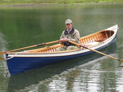

    Here are two lovely boats that have been made by Grapeviewpoint Boatworks.
    A 16' Rangeley Lake Boat:
    and a 21' St Lawrence River Skiff:

    Wow, those are really pretty boats. I need to look more closely at the St. Lawrence River skiff. . .
    lyle

    This guideboat weighs 70lbs. I have found this rig to be the easiest and
    most stabile way to transport my boat other than a trailer.
