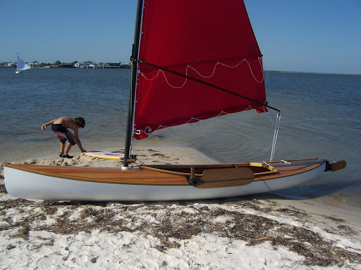

    I have been sailing a decked 15'7" Macgreggor canoe, an Ian Oughtred design,
    http://www.sailing-new-england.com/m...ing_canoe.html
    for over 10 years. Single mast balanced lug sail. A bit tender I think for a first timer, but quite fast. I have seen a carvel Macgreggor at a local show and it seemed no different to sail.
