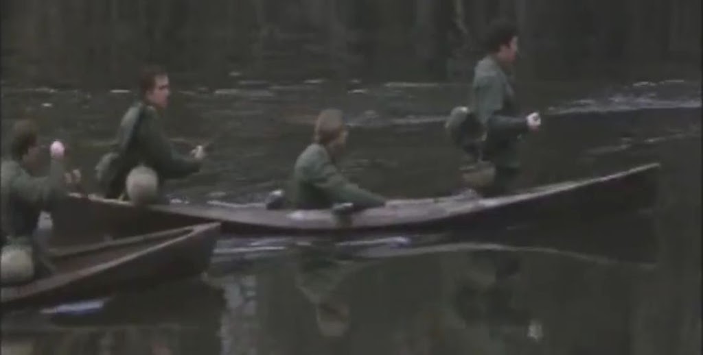

    In the movie Southern Comfort there are some pirogues which having an interesting feature, something that I hesitate to call a reverse top strake which give the canoe a bit of tumblehome, maximum amidships tapering out for and aft. This feature would seems to make paddling easier.
    It can be seen in this clip briefly at 2:34 and again on the water from 4:50 onwards.

    For those not wanting to potentially get sucked in to watching an online movie , here are two pics of the pirogues with tumbleome (or just an interesting inwale?) amidships that I mentioned in post #15:
