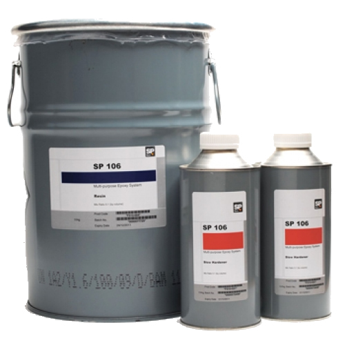

    Can anyone tell me how much kg of epoxy i need if im to use 3.5 gallons. It says in teh plans that i need 3.5 gallons but here in ireland and the uk they sell it in kgs. I honestly dont know how to work this out.
    Ive been looking at getting this what i have on the link.http://www.mbfg.co.uk/user/products/...kg_500x500.jpg , http://www.mbfg.co.uk/epoxy-resins/s...oxy-resin.html .Im wondering will the 11.8kg be enough or will i have to go for the larger product at 23.6kg.

    A quick google search will tell you that 1 gallon weighs around 8 to 9 lb (depending which site you look at) so 3.65kg to 4kg per gallon.
    I just double checked my list of materials and its 3gallons that i need, not the 3.5 i previously mentioned . I think ill get away with ordering the 11.8kg because ive about 1 pint of epoxy left over from my canoe build and ill use this for the stems and joining the transom together. I hope im not scraping the epoxy tin at the end of the build because ill prob have to buy another 3kg at £50 and if this is what happens then i should have bought the 23kg to start of with and been left with 10kg more epoxy for an extra £40. Im now sitting here wondering will i just go ahead and buy the 23.6kg incase i do run out with buying the 11.8kg.
    It also says in the list of materials that i need 18 yrds peel ply and 14 yrds of 6oz fiberglass cloth. Ive just googled peel ply and seen a video on youtube and it looks to me that its a type of fiberglass but anywhere else ive seen a cedar strip build ive only seen fiberglass get used. Im thinking will i just go ahead and use the fiberglass on its on. My boat will be 12ft long and im near sure ill get away with using 5mtrs of 1mx1.5m cloth thou ill have to double check my forms. If i can get away with using this, ill buy 10mtrs of cloth at £110( without P&P) instead of buying 20mtrs of the 1mx1m which will set me back £130(without P&P).
