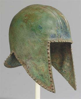

    Feb 2001
    Seattle, WA USA
    8,921
    Default Re: Does bronze go bad in time ?
    Quote Originally Posted by MN Dave View Post
    No, I don't think bronze goes bad.
    Correct!
    Holding up pretty good after c. 2,600 years...
    A GREEK BRONZE HELMET OF ILLYRIAN TYPE
    ARCHAIC PERIOD, CIRCA 600-550 B.C.
    Lot Description
    Of hammered sheet, with a flaring neck-guard, two parallel double ridges running across the crown front to back, a perforation between the ridges at the front, one on each ridge at the crown, and two at the back, all for attachment of a crest, a raised horizontal ridge above the brow, the perimeter with evenly-spaced gilt-bronze rivets, the proper left cheek-guard with a perforation at the forward tip
    11 in. (27.9 cm.) high

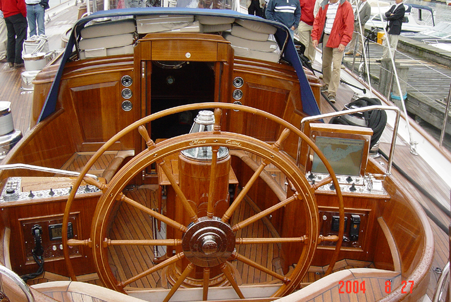

    Oct 2001
    Flattop Islands
    1,473
    This is perhaps a bit more elaborate that the one Ed posted above. Obviously you'll want something smaller and lighter looking, the steering box is the determining factor.
    Aboard Maria Cattiva.......

    Today I made some bronze washers , after doing some milling , then some drilling , I'm almost convinced that the base is red brass . The bronze I cut today would leave a nice long chip , no sign of that rippy sound that brass gives , and my pedestal made . I think in the next few days I'm going to chuck that monster back up and try to remove the weld , and try to get it apart , reface the joint , then retry , as brass with TIG again . If no luck , I'll get some 1/4'' silica bronze plate , and roll my own pipe with material I can trust . I appreciate the info , before this problem , I always thought brass and bronze could be welded in the same way . Bob
    And Thanks guys for those pictures of steering pedestals , that got my design juices going

    Just an aside, ramillett. You have some lovely pix of a wonderful boat. One day you must make a site that gives us a virtual tour inside and out, including close ups of your meticulously maintained systems and ever so well varnished surfaces.

    Quote Originally Posted by Ian McColgin View Post
    Someday it would be fun , maybe after I get her back sailing again , or better yet come and go sailing

    Bronze can definitely go bad in time...
  43. #43
    Jul 2011
    Lindstrom, MN
    362
    Ouch.
    Hey, bronze can get bronze disease.
    http://www.classicalcoins.com/bronze_disease.html

    CJ, that is truly disturbing. True, but disturbing nonetheless. Rick
