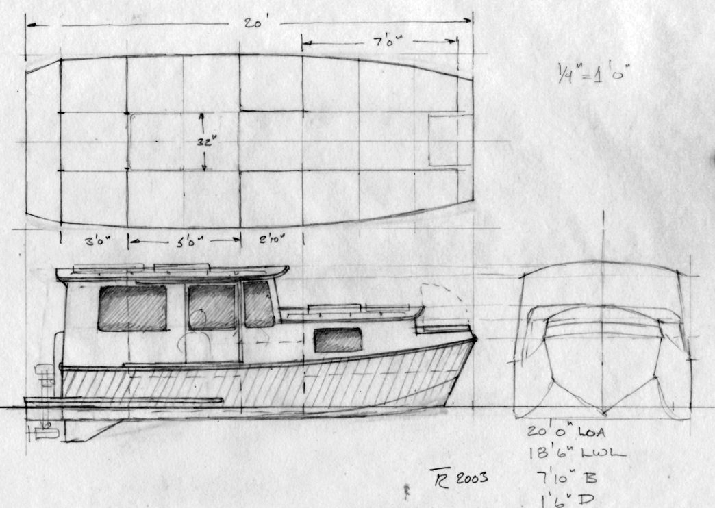

    Actually I called it a "Cruising Shanty", and it was drawn in reaction to Harry Bryan's WoodenBoat #224 cover boat.
    I believe Phil Bolger wrote rather wisely about "cheap" boats.......He said something like "If you build a boat that looks cheap, it better be cheap." This is my attitude to the shanty boat controversy. In WB #225 Harry defends the $75,000 finished price of his 20' shanty boat. That's without any propulsion by the way. I am concerned that Joe B wheels his $75k shanty home only to find she will fetch $15k on the open market! Harry mentions 2000 man hours to build his shanty, no question she's a beautiful thing nicely made. But I think one could, using plywood and stitch and glue techniques, create something that looks at least vaguely like a boat (my cruising shanty) in about 1/4 the man hours. And it's something you could clamp an old outboard to and go someplace(protected waters). True it will be worth less than Harry's boat, but the investment will be far less.
    The cruising shanty's bottom is flat athwartships with rocker fore and aft. Topsides are vertical. The bulkheads and transom are sawn out and set up upside down. Bottom goes on in two layers, then lower topsides. Roll her upright and add upperworks, deck and cabintop are only curved in one direction. Flower boxes can be added, along with a satellite dish on the roof.......

    Quote Originally Posted by TR View Post
    ...The cruising shanty's bottom is flat athwartships with rocker fore and aft...
    I didn't realize the bottom was rockered. In that case its already more of a real boat that some other designs that make little mention of their questionable hydrodynamics, such as the Berkley offerings that appear to be dead flat through out.

    Line drawing of TR's Cruising Shanty. The rocker seems quite evenly distributed. I think you could expect quite efficient performance. Wish I had seen this view before I made a couple less than complementary assumptions.

    I think I like Cruising Shanty arrangement B. "A" has the advantage of a good porch, while "B" has more "interior"
    I suppose it depends on whether you'd spend time sitting on the porch or not. may the best would be to put a "Tenner Dancefloor" hinged rear deck. Keep it up when you'd be charged by length, drop it down for calm anchorages...

    A sharp entry like the Atkin or Elver above does not need any rocker forward (IMO). A very blunt bow, as the cruising shanty, will be better with some rocker. Think of the bow as a wedge being forced through the water, smaller (shallower) and finer is easier (less resistance). As the boat passes the water just wants to return to it's starting level, thus the gentle rise of bottom aft with little transom immersed and dragging up a stern wave. I believe the maximum waterplane (blunt ends) is a requirement for a small boat that folks will spend time aboard. The waterplane area and displacement are key to decent stability and reduction of motion with every passing ripple. I see people trying to live aboard small boats (like a Catalina 27) and they are exhausted by the constant motion more than anything.
    With her small waterplane, large deck, and high sides the Elver in particular is a very tiddly boat, not conducive to relaxation IMO. But she will slip along at low speed with almost no effort.
    I certainly wouldn't want an Elver for a cruising shanty. I meant only to point out the possibility of a vessel much like your design only double ended, with a wide bottom and straight vertical sides. Of course the only value in doing so would be to permit a perfectly flat bottom. That might have some convenience but the disadvantages could outweigh.

    Quote Originally Posted by essaunders View Post
    I prefer A. Its nice to feel like you're stepping out of inside of a boat.

    I, too, would be tempted to stay with TR's design. If you need more boat than that then a shanty isn't appropriate. Get a real boat with the biggest possible cabin.

    Something like this from Mertens, perhaps. But the more you need a real boat the less you can call it a shanty
    Bb
    Be careful if you are considering this plan. There have been multiple reports that the design trims down by the bow due poor weight distribution.
    Oldad

    Quote Originally Posted by Oldad View Post
    Bb
    Oldad
    I seem to recall hearing that before. Perhaps the problems stem from this being a planing hull
    The planing hull bottom and the wide and strong transom allows her to take fairly large engines but she will be very happy to move at displacement speed with a 25 HP.
    Probably trims better with twin 100s on the transom.

    The problem stems from the cabin being located far ahead of the lateral center of bouyancy and yes, a couple of 100s (4 strokes) on the transom would help a lot
