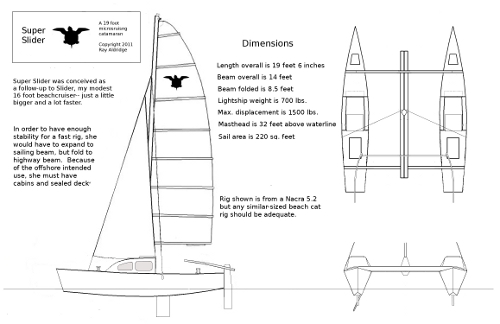

    I'm going to advocate a multihull. Ideas that have intrigued me are the ECO Motorboat http://ikarus342000.com/ECOmotorboat.htm , Richard Woods, Skoota http://www.sailingcatamarans.com and this 21' version of a Shellboats catamaran. http://www.thebeachcats.com/classifi...catanaran.html A simple sailrig, perhaps optimized for offwind sailing, would be a nice add-on. Something that is more conservative like a Wharram or Ray Aldridge's Slider would be my idea of a rig set up that at least could sail to windward should the spirit move.
    In this size range, a trimaran might make more sense but I prefer a catamaran (more boaty, less like a spider... it's my problem okay?) (and I've had both and the tri sailed better)
    A cuddy/berth flat works well with potential headroom in the hulls are quite doable with this setup. Richard Woods has a pretty good way of making this size cat trailerable AND easy to build in sections in said garage. However, I really believe that trailerability is waaay over emphasized in these small boats. Nice theoretically, but in practice it restricts the actual use the boat will get if it's not kept in a slip or on a mooring. I 'use' my boats a lot even though I don't always get underway. Trailering also imposes limitations of weight and dimensions that tend to work against a lot of other design goals. Granted, not being readily trailered has financial implications and in the brief, finances appear to be an issue.
    I've really tinkered for a long time with trying to find the catamaran substitute for a Rozinante classic. Haven't done it yet but in part, that's because my interior requirements tend to creep. ( I really like an enclosed head and even a shower space for a pressurized sprayer type shower), Then I have this thing about still being 'young' enough to want that double bunk.....
    I'd give up the permanent berth for a convertable settee but the Admiral wouldn't really be enthusiastic. This probably means I'm really more of a better candidate for a bigger boat than what we're talking about here, still many ideas are transferable.
    I also want a boat that I can take to wooden boat festivals and gatherings and messabouts and raids with pride.

    You know,, there's a way to get enough space for exercise and even walking around a bit on a 20 foot boat. Make it a catamaran with open bridgedeck.
    This boat's individual hulls are a little under 4 feet wide, so both hulls would fit in half a garage.
    The problem with a multihull for this purpose is that the amount of supplies you can carry, since limited load-carrying capacity is the major drawback of mulihulls. But maybe for a coastal cruise, this wouldn't be a huge drawback-- and you can still carry enough supplies for modest blue water passages-- across the Gulf maybe, or down through the Caribbean, where passages of more than a few days are unlikely.
    To me, the biggest factor in a boat of this approximate size is comfort, and in my opinion a cat wins in every aspect except internal volume. There is certainly comfort in the longer sightlines and less claustrophobic interiors of monohulls... but are these comforts enough to compensate for the kind of black and blue cruising that a small monohull at sea delivers?
