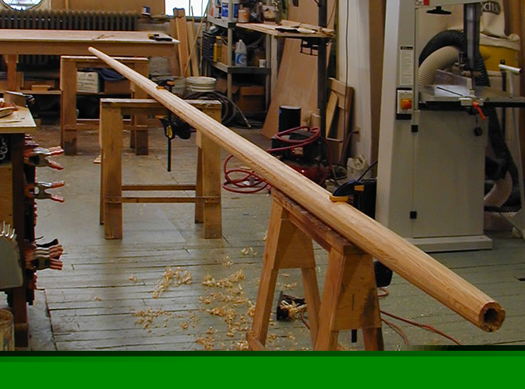

    I have made dozens of bird's mouth spars over the years, and my standard method for cutting the taper is to mark offsets on one stave, and then run a spline and mark for the cut. The problem here is that you need to be absolutely certain that the whippy stave is straight, or the marked curve will be corrupted.
    Given that the curve of the cut is SO gentle, you can easily get by with straight lines drawn from offset to offset, and this really simplifies the whole process. My straight-edge is an eight foot-long aluminium box-section of about 4" x 1" section. I position it securely on the bench top and then use spring clamps to hold the stave bird's mouth side against the straight-edge. Then I simply rule a straight line from each offset to the next, moving the stave along and re-clamping as required. In my plans, I usually provide offsets and cross-sectional dimensions for bird's mouth staves, and typically the offsets are spaced about 600mm so the process is easy. Below is the sheet showing the Little Egret mast dimensions, with the corresponding staves drawn in blue.
    After marking one stave, I cut the taper on a bandsaw by eye. I'm so familiar with my old machine that it only takes a minute or so to clean up the cut with a sharp low-angle block plane, and then I use that stave as a template to mark the remaining seven, using the big box-section straight-edge to hold both the master stave and the one being marked. Once again, it is only necessary to have the staves straight where the marking is taking place. After that it is simply a case of making the remaining seven cuts and cleaning them up with the plane.
    The process sounds cumbersome the way I've put it into words, but it works extremely well.
    Having said all that, rough cuts with a tablesaw or a jigsaw are fine - it just takes a bit longer when finishing off with the plane. There are all sorts of other options I've thought of, such as making a template and then using a router with a following bit, but by the time it was set up, I'd have finished the lot working through the bandsaw by eye.

    Ross's method sounds good to me, but I've used a router and template to good effect. On my crab skiff Cricket, I screwed a stop down to a long piece of ply on the bench. The bottom piece of ply has the taper cut (and I use a slightly curved taper) and the backstop holds the stave in the proper relationship to the template edge. Then a bottom bearing router bit cuts the taper. It may be necessary to rough cut the stave before routing, depending on how splintery the material is. Like Ross's method, it sounds more laborious than it actually is. But there's no plane work as the router cut is square and clean.

    For those who are interested in seeing photos of what I have described, here are links to a series of illustrated articles from my blog showing various elements on bird's mouth mast construction. This is just my method, and there are many other ways of doing the job.
    http://rosslillistonewoodenboat.blog...proach-to.html
    http://rosslillistonewoodenboat.blog...n-shaping.html
    http://rosslillistonewoodenboat.blog...llow-mast.html
    http://rosslillistonewoodenboat.blog...uth-spars.html
    http://rosslillistonewoodenboat.blog...aditional.html
    I hope these may help to de-mystify the process - it is easier than it sounds in print!

    Thanks guys, but it ain't over till the fat lady sings..it's the glue up which is giving me the willies...why can't I live in a climate where slow epoxy takes an hour or so to go off! Actually, I take that back...

    Quote Originally Posted by johnno View Post
    If on the other hand, you are asking about the wall thickness, no, that stays constant at 16mm.
    That's what I was hitting at. Thanks.
    Additionally, you may not need to make octagons depending on your drill bit sizes. Drill a hole, put in a dowel section in there with some thickened epoxy, and you're good to go. The one octagon you'll need to make is the one at the partners.

    What brand of epoxy are you using John? I use Bote Cote and in temperatures of around 20 I can still be using the glue for hours. In your case, I think I'd make up two mixes. A neat mix of resin that I'd then brush onto the gluing surfaces. Then I'd make up a glue mix and do the gluing. I've had a lot of trouble with West epoxy - it goes off too quickly and once it starts to gel, it then stiffens up even more quickly. Apparently there are various West hardeners but I couldn't be bothered chasing stuff like that when the locally available product is so much better to work with.
    Ross has a lovely method for this where he screws one set of stave ends to an oversized plywood octagon at one end, but I know me and screws in thin soft timber, and in the end I didn't want to risk splitting a stave or two.
    Simply drill the holes slightly oversized and use a small gauge dome head screw with a washer to clamp the stave in place.
    Nice work John!
    I may be coming up your way toward the end of next week, so I'll drop by if I do... Gluing up party?
    West is okay in the current temperature range but I only ever mix up three pumps worth at a time. If you have a bunch of gluers, like Gary did for his mast, all the better.
    Ship Happens!

    Thanks Dan, good advice on the plug.
    Rick, I'm using West, and have heard some negatives about 'the other' brand. You're right, the temp is about 5 degrees lower now so I should have more time. And yes I agree, I always coat with plain epoxy, and then mix up and apply the thickened. I use the slow hardener anyway, and I like the West thickener. I tried the 'other brand' thickener and I needed to add so much it weakened the mix..almost no glue left, so I abandoned using that one.
    Any takers for a bunch of gluers, but any time between Saturday and Tuesday????
    Sorry Dunc, thanks for the offer, but later next week will be too late for me, unless I can't raise any other help. When do you think you'll be up here?

    I guessed from your description of the short curing times that you must be using West. I find the West additives are very good but I don't like their resin at all. I've used a lot of Bote Cote and a lot of West. I've never had any problems with Bote Cote but always had issues with West going off very quickly, becoming hot and stinking. I also much prefer a 2:1 mixing regime as it's so much more forgiving and very easy to make small mixes without those stupid pumps. Anyway, good luck with the glue up.

    John I am absolutely amazed that you managed to get straight cuts through that thickness with the jigsaw!!!
    It is clearly impossible. The man's a god. How did he let is slip that he is capable of such things? Now everyone knows that he's more than human.
    John, oh how I wish!
    So a little closer..made up the octagonal plugs for each mast today. I needed 2 1/2" x 2 1/2" and had nothing close to that. I found some old timber under the house, the remains of a bed I made when I first bought my house some 30 years ago, and the deposit left me no money for furniture, so I started making it all myself. First priority was the bed, chairs and sofas came later.
    I'm often surprised lately when I scour through these old piles that all the timber I bought then was clear hoop pine, and it was very cheap. Nowadays you have to work hard to find it.
    So after a bit of a late start to the morning I cut some of this bed up to size and epoxied two 2 1/2" x 1 1/4" pieces together, and put them out in the sun, then set about making some moulds to sit the mast in for glue up, and getting that all aligned. The epoxy was on;y a few hours old when I ripped the square timber into an octagonal profile, but it held okay.
    I've talked the neighbour into giving me a hand with the first glue-up tomorrow morning, so tonight I need to string together pairs of cable ties, and we'll be set to go, bar rain.
    Fingers crossed!!
