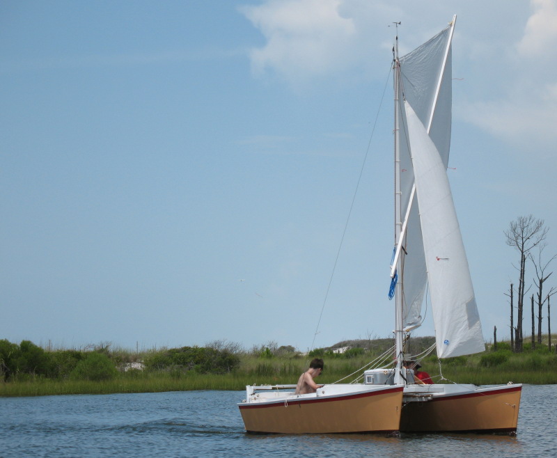

    Maybe this isn't the sort of thing you had in mind, but this was my solution to a fast home-built sailboat.
    This little cat is just under 16 feet. She's an open boat, and while she is not as fast as a beach cat, or even a planing dinghy, she's surprisingly fast for a small inexpensive home-built boat, while not requiring any great athletic effort to sail. I built Slider for about $2000. I've never lifted a hull in her, even sailing in winds of 30 knots plus. I've hit 10 knots in flat water on a number of occasions now, despite her low-tech rig. In fact, I sailed her for the first year with a home-made mainsail.
    Her greatest virtues are her comfort under sail and her unbelievably good behavior in every circumstance.

    Slider Cat,
    You have had your 16 going for quite a while, and seem very confident with it. 30 knots without lifting the hull ( I assume you mean with all sail up) seems pretty conservative. How about taking that Nacra 5.2 (around 16') rig and sticking it on. I would like to see a test sail report on how it works with a more mainstream sail area. After all Slider is 2+ times the weight of the Nacra, you should still have plenty of stability in 20 knots - limited just to keep you safe and feeling confident. Basically its just 3 pins for the shrouds and forestay (I'm ignoring the lengths to make this seem easy).
    Marc

    That catamaran looks like a lot of fun for cruising southern waters.

    Well, it is, but I think it would be a good boat for colder waters, as long as you remember it's an open boat. It's actually a much drier boat to sail than any small open monohull I've been aboard. We very rarely take any spray aboard, and I've never had green water make it into the cockpits. She has plenty of freeboard, flared dory-like hulls, and she doesn't heel more than 5 degrees.
    Marc, the Nacra rig would be too much, at least for the sort of peaceful, worry-free cruising I had in mind when I drew her. When we were out in 30 knots, I had the main scandalized and no jib. Surprisingly, she still went to windward well, even scandalized, with the peak wrapped around the mast and the peak line taken back to the end of the boom. In the video below, toward the end of the video, we're sailing in 25 knots with jib and reefed main. This starts at about the 6 minute mark.
