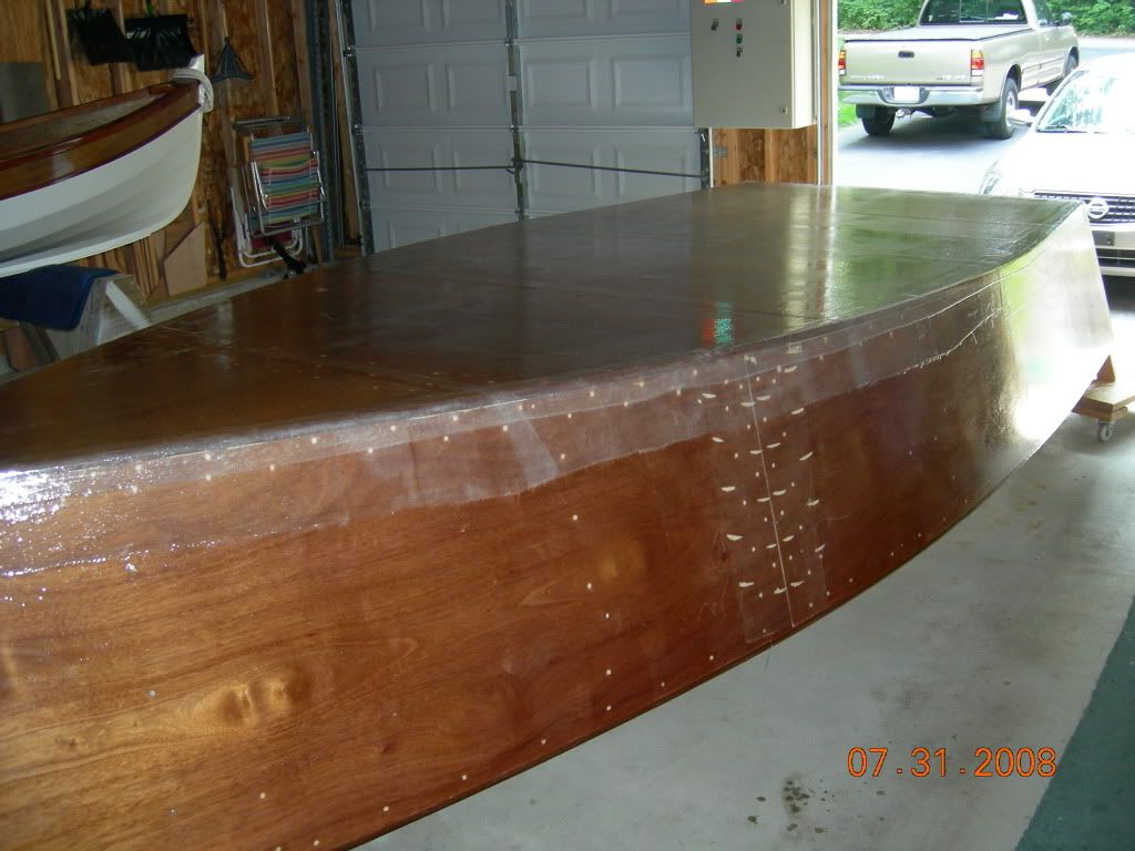

    Built a LYS, but interpolated between the 16' & 20' to build this 18 footer. Very happy with the boat, fun to build and goes wicked pissah with a 40 hp 4-stroke. In fact, I haven't achieved WOT yet... The side rails, or gunwales, add a significant amount of rigidity to the hull as well as a nice place to mount stuff. Have fun and enjoy the project!

    CJ who's plans did you build? Was it Walter's with modifications to make it an 18 footer?
    Quote Originally Posted by CJ View Post

    CJ
    I'm noticing in your picture from the placement of your butt blocks that the short piece of plywood in towards the stern of the boat. Walter Barron places his at the bow. I always thought the stern would be better since there is less bending in shaping the hull. Was that your reason?
    Mar 2004
    Buzzards Bay, MA
    377
    Default Re: lumber yard skiff
    jclays:
    In my LYS, since it's 18 feet long, there are actually two butt blocks per side; one about amidships and one two feet forward of the transom. So, yes the shorter side piece is at the transom. I think with the 20 footer with it's higher sides, having the shorter piece at the bow makes better use of the plywood, I'm not sure. But, with the 5/8" sides and 5/8" butt blocks screwed & glued in place, they took the strain of bending with no problems. Sure, if you could avoid them or move the butt blocks further aft, the factor of safety would increase, but you'd have to use 10' long sheets of plywood...
    Incidentally, I'm glad I fiberglassed the bottom of mine. I don't worry as much when I beach it on gravelly sand, haul it onto the trailer or bump into other obstructions. The LYS is ideal for skinny water and 'glassing it just made sense to me. I used 10 yds of 10 oz glass which was the perfect amount for the 18 footer - bought it from fiberglasssite.com, a good source. Good luck!
    CJ

    Ive the got the plans for walters lumberyard skiff and i had a question, how did you trim the butt blocks down after you screwed and glued it to install the chines
    Mar 2004
    Buzzards Bay, MA
    377
    Yeah, trimming off the excess butt blocks to fit the chines and the sheer strake was a minor PITA. You could cut the chines and sheer strake first and then make the butt blocks smaller by those dimensions before you glue the butt blocks, or, what I did was a little more barbaric, I glued and screwed full sized butt blocks to the side panels and after the 5200 cured I used an angle grinder with a cutting wheel to cut off the top and bottom and a chisel to pry off the excess.
    I also feel that Walters suggestion of using screws which are longer than the combined thickness of the side panels and butt block is worth the effort of grinding off the screw tips later on - ensures good thread contact all the way through.
