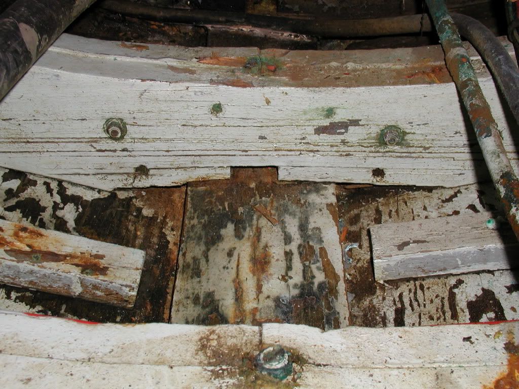

    My situation is far easier... My keelbolts sit on top of the stringers. A picture shows it best... This was taken from under the floor boards in my 'cellar' (area under the galley, forward of the engine room):

    Figured I post a few pics of my recent activities... I cut the nuts off the keel bolts with a grinder and punched the bolts out from the inside.
    I had to cut a few new holes in my floor boards:
    And the water tank is now history... This is where it 'used' to live:
    I reefed-out all the seams and the keel came down pretty easily. Keelson looks pretty good after all the years:
    I'm thinking I should clean-up all surfaces and prep with a sealer such as CPES. Please let me know if you've had any experience with doing this.
    Once I dropped the keel it became apparent that I need to replace a couple of my garboard planks... Ugh... My job just got a good bit harder.

    Thought I'd give you an update of my recent progress... I bought myself another big ole hunk of white oak from another sawmill in the area. My friends at Pike & Sons had nothing for me, but I managed to find a good tree at Copeland Sawmill in Marshfield, MA... Good place, nice folks. Got it home, planed it (ugh, not fun), and trimed it to size. And the result...
    It maintained its shape... Yeah!!! I sealed it up with CPES and test-fitted the 3 sections of the keel on my driveway the other day:
    It all fit together pretty well. Meanwhile, down at the boat, I've been working on prepping the inner hull and keelson. As discussed earlier, I impregnated the inner hull, keelson & stringers with about 3 gallons of CPES. I then bedded the plywood to the keelson with 5200. 'Many' hours were spent plugging all the old screw holes with hardwood dowels (also impregnated with CPES). I glued these in place with West System:
    I surface-coated the plywood with a thin layer of thickened West System, to fill in places where the old wood had checked, split, or incurred other damage. Finally, I finished up the prep work with a coat of paint:
    I think I'm finally ready to start replanking. I have the new mahogany lumber sitting in my garage, alongside the old planks (removed intact). I spent about $400 on SB screws the other day... Anyone have any advice for a newbie boat restorer attempting to replace his garboard planks? I'm a bit nervous about this task...
    Thanks as always,
    Dave

    Pre-soaking the planks would be tough, especially since they've been sealed with CPES. I'm planning to caulk with Interlux seaming compound. Thanks for the reference to the wood database site.. Great info there. Given that my planks are 7" wide, I figure:
    7" = 56/8"
    56 * .037 = 2.072
    So I figure I'll leave about 1/8" gap on each side of my new garboard. This roughly matches the gaps I see between my existing planks.
    Dave
