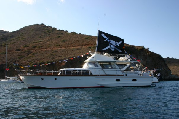

    Murphischia is a sometimes poster here on the WBF. A few years back he entered his in the Long Beach Classic Boat Show.
    Here are a few pics of it.
    I've got some more pics, if anybody wants to see them.
    BTW, he got best of show!

    Hi Bob,
    All the pictures posted are of my Ischia 16M "Arrivederci".
    I assume the boat your friend purchased is Maestra serial number #82. Very interesting story of it's trip from the West Coast via the Panama Canal.
    There were 14 of these 16Ms imported into the U.S.. At one time I had located each one but a few of them are no longer around.
    All of the Ischia 16M boats imported to the US were fitted with GM 8v71s. The Italian versions got the 12v71s.
    With the 8v71s her fuel consumption is not outrageous and her speed still rivals new boats of her size.
    There were 95 of the Ischia 16Ms built from 1959 until 1967 (I'm one of the later models #89)
    These were semi custom yachts so each boat has some unique running changes that make them each different.
    An easy way to tell an early from a late model Ischia is the absence of the outside exhaust sponsons on the early boats.
    The craftsmanship put into these boats was outstanding. The attention to detail created a beautiful and strong boat inside and out. Not surprising when you realize that Cantiere Baglietto has been around since the 1800s.
    But even more impressive than her looks are her manners underway. With her long length to beam (something newer boat designers seem to ignore) she will handle a rough seaway with poise.
    We've been on cruises with fellow tupperware boats that looked like fish bobbers as we cruised along as smooth as could be with not a drop spilled from our guests martinis.
    One Catalina Island run had us in 12 foot swells with wind wave spray dosing us on the flybridge, aside from my wife vowing never to speak to me again, the boat handled smooth and predictable.
    The bigger boat Lew refers to up in Seattle is a 22 meter Baglietto Maiorca, the big sister to the 16Ms. Only 3 Maiorcas were produced.
    That boat has quite a unique story as well having been restored in Italy only to hit a log at speed and be sunk. Then raised and shipped to Seattle for a complete restoration that will include a set of Italy sourced original Issotta Fraschinni's engines.
    I have quite a collection of Baglietto factory information such as fuel, electrical, plumbing blueprints, serial numbers/production sequences, sales brochures etc... along with a few years of Baglietto ownership under my belt that I would be more than willing to share with your friend about his new Baglietto.
    P.S. The pirate flag has not been photoshopped. It is the huge flag we fly each year at the Two Harbors Buccanner Days weekend.

    Murphischia,
    Glad you happened by and caught this thread. I remembered your telling of many interesting facts about your boat and the other Ischias, but the details long ago leaked out through the swiss cheese in my noggin.
    It takes a lot of power boat to impress this old raghauler. Arrivederci did it with spades. She was a beauty to start with, and has been maintained impeccably.
    Hope you don't mind me reposting a couple more pics of her.

    Here are a couple more photos to keep you psyched up through the winter.
    This is a vintage boat show picture of a 16M very close to your serial number
    And a good side shot of my boat to show you some differences between my boat and yours.
