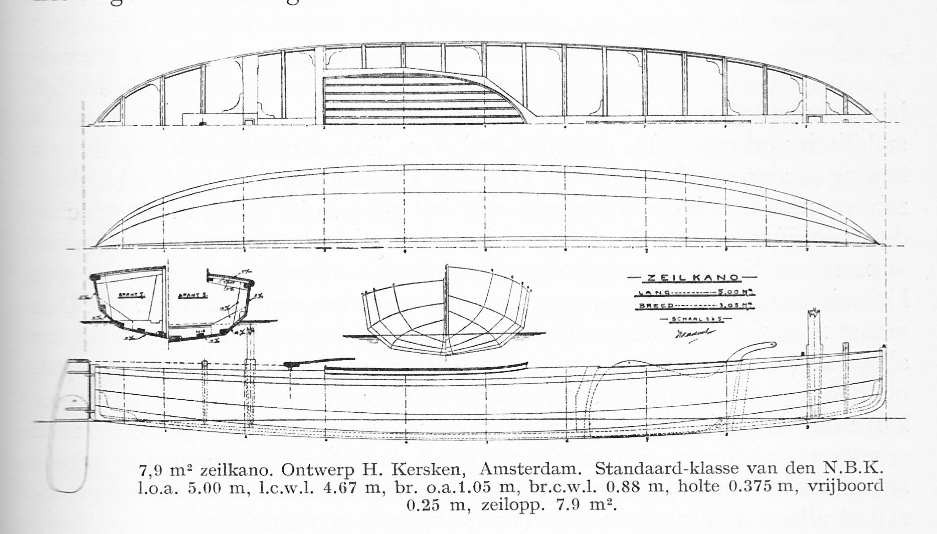

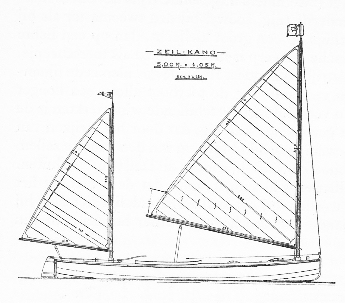

    http://heid0251.home.xs4all.nl/image...eilkanoNBK.jpg / http://heid0251.home.xs4all.nl/image...oNBK_small.jpg
  19. #169
    Mar 2009
    Leiden, the Netherlands
    13
    Default Re: New Welsford Design - Nautilus sailing Canoe
    Let me just give it one more go.
    The lines:
    The sail plan:
    (The Netherlands, approx. 1935)
