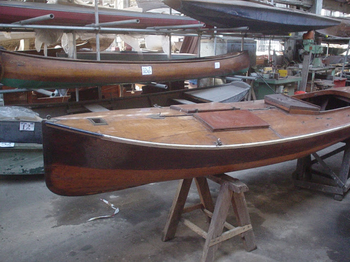

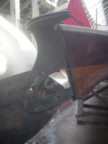

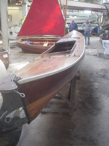

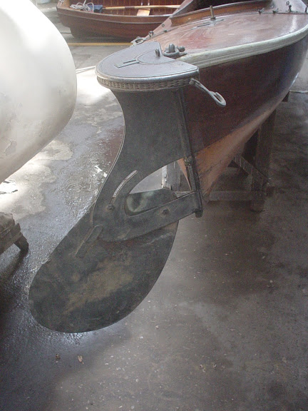

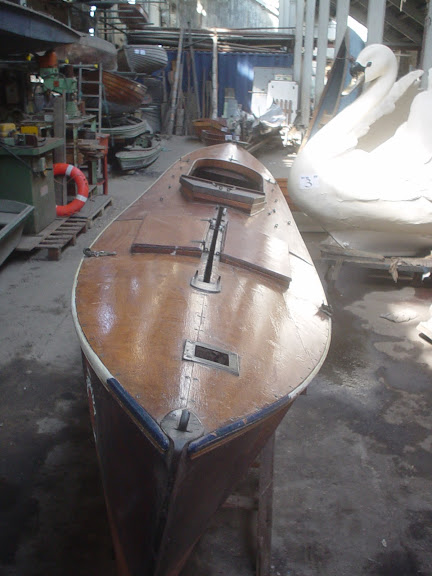

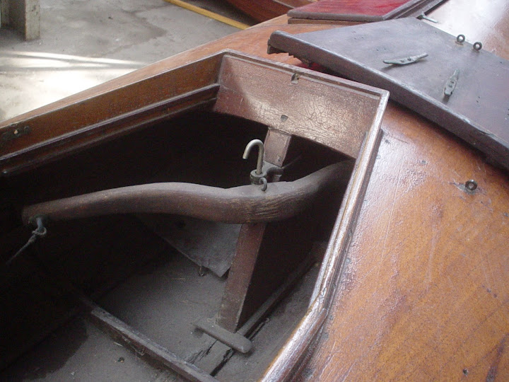

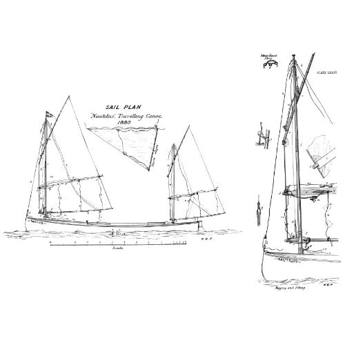

    Here's the original Nautilus

    John,
    That mizzen rig - a sprit-boomed leg-o-mutton?
    I agree - it's a mighty pretty boat.

    Default Re: New Welsford Design - Nautilus sailing Canoe
    Thats right David, one of the issues in this type of boat is keeping the sheet loadings low, another is reduction of twist. That latter is very important as twist in either sail rolls the boat when running off, and in a relatively narrow boat thats an issue when the wind gets up.
    So, the balance lug main and sprit boomed l.o.m. mizzen are both good choices in that respect, plus Brian is very familiar with the balance lug.
    John Welsford
    John,

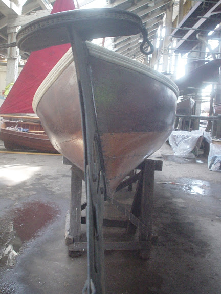

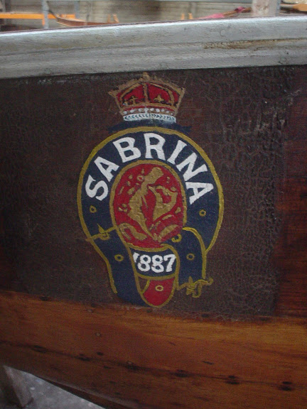

    Before the internal combustion engine, before the great wars, a man found himself some adventure, in those times, with his sailing canoe. They ventured all over Europe in them, taking advantage of the industrial revolution's great powerhouse, the steam engine (they put them in the luggage compartment) and cruised far and wide. No marinas, no powerboats, little shipping. The cruising was typically along shore and offshore in good conditions. This neccessitated a more powerful and commodious hull form.
    Gareth posted an original picture of Warrington Baden Powell with his Nautilus in black and white above, luckily a recent auction at Turks, UK (they sold off there collection used as film props) had an original Nautilus (there were several, as they were developed). Dad was outbid in the end, but he took some pictures of her. She was built in 1887. I'll post the pictures, so people can familiarise themselves with not just the original type, but an original boat's shape, rigging and construction details.
    Edward (Brian's son).

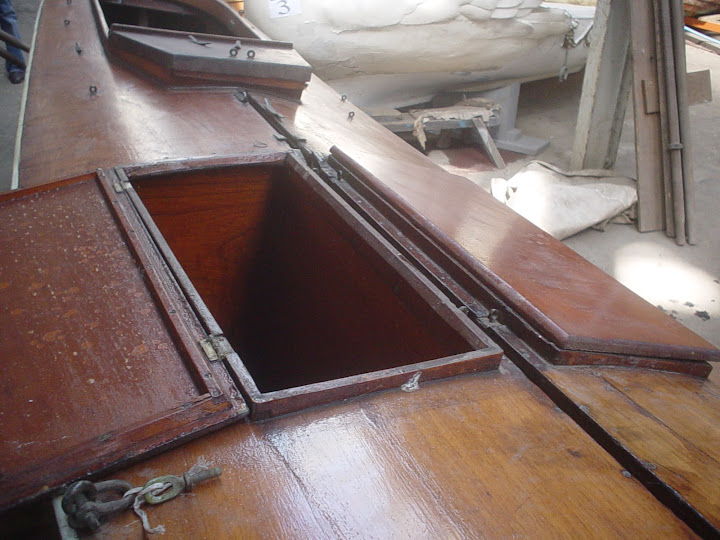

  36. #36
    Nov 2007
    2,302
    (She sold for £6000/ $10000. She didn't have her rig, so dad couldn't see that).
    1. There's a pin on the rear deck just aft the cockpit, that takes a second yoke - the front yoke connected to the aft yoke, which moves to move the rudder blade.
    2. Offset mast, so the lug sails on the midline!
    3. The planks are not lapped but butted, sitting on longitudinal stringers. The planks are very shaped - to give almost a carvel hull shape - possibly oversized planks planed concave/ convex, like someone might do for modern carvel at the turn of the bilges?
    4. Interesting rudder - not just one bolt, but three attachment points on the lifting bronze rudder for strength, small shackle on aft rudder taking the line up through rudder head to a pivot point in line with the turning axis forward.
    5. Hull form - her beam is carried well 'into the ends', for carriage over waves. This should also reduce pitchning when rowing her with a sliding thwart? With the beam carried well into the ends, there's a good amount of sheer at the ends, to keep her fry but also prevent the powderhorn affect when healed.
    6. Two bilge stringers.
    7. Centreboard pennant looks like it attaches to hook on the front yoke. There's two adjustable runners either side of the front cockpit sides?
    8. Forward small cockpit spray hatch is removable and takes some rigging attachments.
    9. On that last photo in b&w, the yard is very fine and tapered, but has a second shorter yard attached to it. Would this be to have an adjustable yard stiffness, for appropriate gust response? Aft sail is rolled up around mizzen mast.
    For these boats modern materials and adhesives, should improve the type, allowing the hulls to be especially light and tight.
    John Welsford's Nautilus will be a terrific rebirth for the Nautilus sailing canoe, with added more powerful oar propulsion with space to lie down on her among the reeds on a summers afternoon.

    Great pictures, I noticed the offset mast too. That rudder looks complicated, in fact the rudder may be the bugbear. I see John has drawn a lifting rudder, would the lifting be accomplished by lines to the cockpit, kayak style, Should such a large rudder be semi balanced.

    This fascinates me:
    What a madly intricate bit of work. The original steered with lines, I reckon. Easy to build a hybrid system that could steer with lines or a push-pull stick.

    Fabulous engineering and materials.
    The rudder head pivots on pintails/ gudgeons, but the upper and lower rudder head gudgeons, are tube crafted into the forward part of the bronze rudder head. The lines snap shack on, then they go forward to a yoke that pivots on that pin that you can see sticking up, just aft the cockpit (that yoke is missing on the boat). From there, there is a line of sight to the forward yoke, to be controlled by the helmsman (knees or feet).
    The rudder blade boasts more than the usual pivot point, the aft bolt is allowing the rudder blade to pivot and still slide up and down, but also further resists any lateral movement of the rudder blade with respect to the head. Further there are those open tangs on the rudder blade's aft surface which also allow the blade to slide up and down the head, whilst simultaneously also resisting lateral movement. Rudder uphaul, attaches to that small shackle on the aft rudder blade, up through a slot in the rudder head, forward to an eye above the pivot point, so the blade doesn't move as the rudder turns. Nice shape blade, even by modern standards, for a boat built over a hundred years ago.
    It would now be seen as overkill perhaps, especially on a small sailing canoe, but these were Victorian pioneers and engineering (especially metal) was a big deal in Victorian times: this was the height of the industrial revolution, building trains, iron bridges etc. These were the wealthy gentry's adventure boats who could afford the bronze materials and engineering and construction work: these "new" centreboards and lifting rudders were a departure from typical small boat construction at the time which was mostly all workboat, straight keel, solid rudder affairs. With a modern sailing canoe one could chose to replicate period details.
    You can just make out the aft yoke pivots behind the helmsan's head
    And just forward of the mizzen mast. The details look so much the same, the Nautilus in the auction I think must be the Nautilus in these old black and white photographs.
