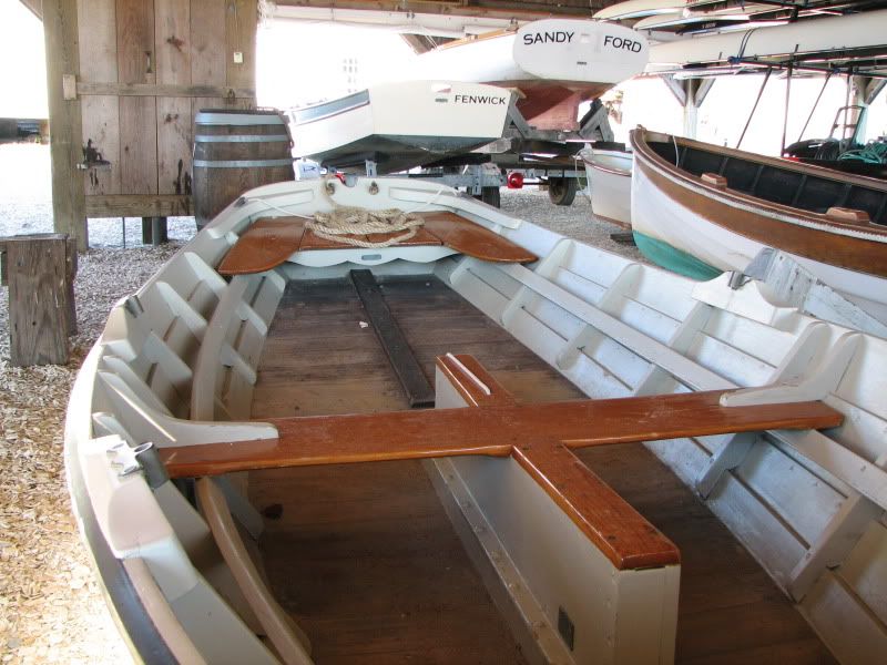

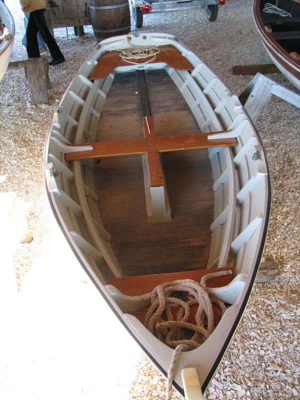

    Apr 2000
    Babylon, N.Y. USA
    1,618
    Default Re: Pete Culler's 13' 6" Good Little Skiff
    It's one of the Good Little Skiffs at Mystic Seaport. Just culled from some random shots I've taken while visiting there.

    Jan 2000
    Cushing, Maine
    4,404
    These boats were rigged out to pretty match mine ( I was working down there when the boats were built.) You will note the forward rowlock sockets which use a removable seat on the riser. The only difference was that my board sticks up a couple of inches at the very back so that there is a slot in the board there. I have a plug for it when sailing. I don't think that area is critical to the balance. I don't use a traveler; sheet is dead ended to one cleat on a quarter knee then up through the clew grommet then through a small block on a pennant made fast to the other cleat then to your hand. The friction in the clew does not give you racing boat fine adjustment, nothing that a little luff can't handle.

    May 2009
    Bournemouth UK
    2,331
    Ben
    Thanks for that. Yes, the use of a slip thwart for the forward rowing position is a neat idea as is the simple sheeting.
