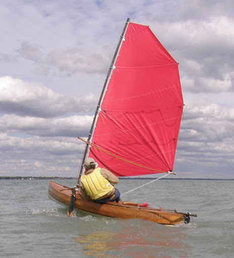

    Here are some photo's of Sylph, Howard's sailing canoe. There are has been some tremendous 50/50 sailing canoe development in the US by the Horton/Rice/Gougeon team.
    We are struggling a bit with Picasa web access for some reason so Howard sent me these wonderful pics to get the thread started.
    and Bufflehead having fun

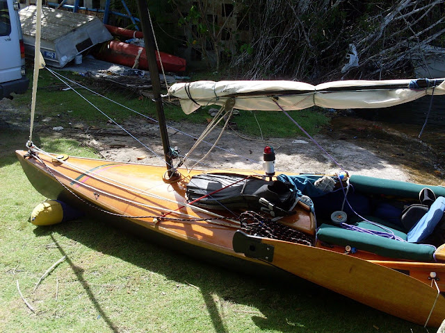

    Here's one

    Default Re: Sylph - Prof Howard Rice's sailing canoe
    Ooh, I wanna know more! What do you use for dry storage? Can the shelter be rigged while sitting in the boat? How hard is it to strike the rig for paddling? What's the all-up weight? Do you have just the one leeboard? Why do you use 2 push-pull tillers instead of just one?
    Rob
    I use dry bags. Yes the shelter can be rigged while sitting in the boat. I usually don't though as it is easier to step out in a foot of water, move things around, set up the tent, bedding etc. On a few occasions I have pulled into a mangrove or marsh area and have either anchored, tied off to a nearby bush or tree and without getting out of the boat set up for sleeping. I sailed down the Hudson River one May a few years ago and slept aboard at anchor almost every night in spite of the cold temperatures. Inside a canoe tent is a small space and easy to heat up using a tiny stove like a whisperlight.
    Striking the rig is quite easy. I roller furl the jib, release the tack and bring it back to the cockpit. I then lift up the boom lifting the mast with sail up out of the step and partners. I lay it down across my lap, release the halyards, pull the sail down, flake it and partially roll it around the boom after taking the boom apart. The mast then pulls apart into three tube sections with internal halyards keeping the parts in the right order. I stow the mast below and after a little more sorting away I paddle away. I carry three sails. Main (w deep reef), jib on roller furler (my first reef is the jib) and I carry a 2sq ft storm sail, yes 2 sq ft. I can hoist this on one mast section and if in hard times in very heavy air can sail down wind.
    Sylph has two identical hand built carbon fiber 3 pc ovoid shaped unstayed masts with internal halyards and integral luff groove. Sylph can be rigged in several different configurations from cat rig to yawl. The 3 mast step locations are at the bow, at the forward end of the cockpit and just aft of the cockpit. Here booms are light wall aluminum with carbon over. I sail with a vang and traveler set up.
    The all up weight with sliding decks, sail rig but no buoyancy bags, paddle, safety gear or anchor is about 70 pounds (guessing here but close).
    I use nly one leeboard because one is all that is needed. Like most small boats canoes should be sailed flat. Given her narrow (I wish she was 31") beam of 34" keeping the blade in water is quite easy. One blade is simpler.
    I like two tillers for a number of reasons. The #1 reason is I sail Sylph long distances and like to have as many sitting steering positions as possible. When I am sailing upwind in heavy air I sometimes use the leeward tiller and then switch to the weather tiller to spell my hands. I rarely cleat the main or jib sheets, my hands can get tired and so I like the option of switching tillers and sheets from hand to hand.
    My tillers are a bit different than other canoe set ups I have seen. I have two BMW motorcycle cables (sheathed) that run through holes in the back of the coaming back to the rudder yoke. Inside the cockpit these cables run forward to a pedal steering set up. I often steer by feet alone and often using leverage against one pedal while steering with a tiller. Steering by foot is where it is at in a canoe. This frees my hands up for many tasks ranging from meal preparation while sailing, to navigating, repair, rigging, catnapping, etc.
    Sylph is fully buoyant with airbags forward, aft and under the side decks. I have also lined her hull in removable cellular foam sheets. Makes for a cushy ride and makes her very safe. I often sail in open ocean here in Pohnpei and on occasion sail across the blue to Pakin or Ant atolls so buoyancy is important to me. I have actually just shipped Sylph back to the US.

    That seat is clever -- what looks like "arm rest/pads" are the hiking pads I guess, but I imagine that in a longer cruise of a few days, having a paddled gunwale to rest and protect the elbows a little is not a bad idea. Sailing that athletically on a longer cruise would be a quite a challenge though, it would seem.

    Ready for the 25 miler across open ocean to Pakin Atoll. Running lights, aft deck pack with tent.

    One more time. Ready for my December cruise to Pakin Atoll. Boat cart is collapsible. After I roll her in I take it apart and strap it on top of the aft deck pack. When I reach shore I take it off in knee deep water, strap it on and roll Sylph across rocks, through sand, coral etc. A very nice tool for the pocket cruiser.

    Test sailing the new Bufflehead design on a cold Michigan October day. I had flown in from Micronesia and Hugh Horton and I couldn't wait to give Bufflehead a go. It was a cold but exhilarating day and Bufflehead sailed very well, a fine canoe hull/deck design.

    A good photo of my leeboard bracket set up and the self steering arrangement. On each tiller I have two shock cords rigged and a tennis ball. I simply get on my desired course and begin adjusting the shock cords on each tiller against the placement of the tennis balls. IN a moment I have her dialed in and tracking straight enough that I can navigate, cook, read a book, etc. The photo also shows the construction of her spanish cedar deck (a fairing labor of love as spanish cedar is itchy stuff). Her deck is strip planked over a mold then covered in s glass with kevlar underneath. Kevlar was used in the construction of the cockpit coaming. Looks a little rudimentary I know but this is a work finish sailing boat in spite of her epoxy/varnished deck. I sail her hard so she has to be strong and a little bit elegant. I often sail her in Pohnpei in winds over 28 knots sometimes reefed down I have experimented in 30+ knots. That is a wild mistake free ride for certain and not for the faint hearted. Sylph goes very fast. In heavy air sailing canoes can be a hand full. Concentration is everything so I often sail with my ipod tuned in to Beethoven or Mozart. Take away the sound and the scene becomes, well quite pleasant without the noise. This helps me concentrate, fun stuff.
    Howard Rice- Lookfar International, Pohnpei Micronesia and Kanazawa Shi, Ishikawa, Japan www.smallcraftacademy.com
    The poor mans tropical bimini. Very effective.

    Quote Originally Posted by Howard Rice View Post
    ...This is the day I tested the new theory of capsizing before being hit by a squall. .
    --- Interesting. Some Polynesian outrigger sailors have used a version of this method -- swamping their proa purposely before or during a big blow, and as part of the water, the proa suffers far less stress. -- Wade
