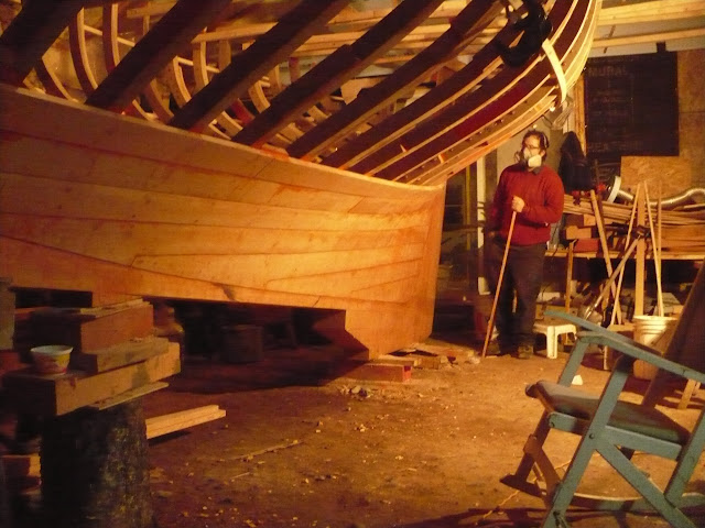

    Beautiful just beautiful!! Capt. Z.
  7. #107
    Sep 2011
    191
    Default Re: Gartside 116A
    Stunning, Stephane, truly inspiring. How do you make that hull look so warm?
    P
  8. #108
    Apr 2009
    New Plymouth New Zealand
    204
    Great work Peaceful,nice shot of the stern post/transom,very arty !!
    Savor every moment ,you maybe only doing this once in your lifetime ,none of us really know.
    Thanks guys!
    Euro:
    It's because it's a temporary building, we salvage a few windows but there isn't much to really have light, so I work with a big spot all the time, which give that color to the pictures.
    Trango: To make a long story short ... no! We been cruising for almost 10 years without engine, we stop to build a new home that suit more our kind of cruise. Also one a bit bigger to have a place for a kid, which is underway (My wife pregnant).
    Thanks again for the nice comments!

    Hi,
    so the weather is too bad to drive and work (Snowstorm), so I've uploaded some pictures...
    So...
    Me in my thinking chair... the most important tool in the shop!
    And the other side of the boat:
    I am working on finishing a few things to install the bilge stringer. There is also that bronze floor at the last pair of frame that I am building and would be done by tomorrow. Then, as we received the Iroko for the transom, will finish that and after resume planking.
    http://www.peacefuljourney.ca/
    BEWARE: I am a native french speaker

    All of the photos are great Stephane but clearly you are not the photographer in the family!
    I'm enjoying this thread a lot.
    When I showed the pics to my partner, these two were chosen as the most important.
    Apparently a good "thinking chair" is as important as a good bandsaw!
    At least that's what I've been told!
    You look like you are enjoying the job.
    Sophie

    So true Sophie, LF Herreshoff advocates a good "moaning chair" as an essential item in any good workshop.

    Thanks Guys (& girl)... Yes the chair was the first tool to enter the shed and probably the last to leave!
    Sophie, nannn I am not a good photographer at all... Actually before I've meet my wife I was a bit against pictures, proof is 8 years cruising alone I have about 15 pictures 2 years cruising with my wife about 500 of them
    It's all good, specially since she is in vacation for a while (Pregnant) it give her more time to enjoy doing it.
    These days I would say the wood stove is the second most important tools... It was -20Celcius in the last few days... Believe me it's hard to work well with frozen fingers
