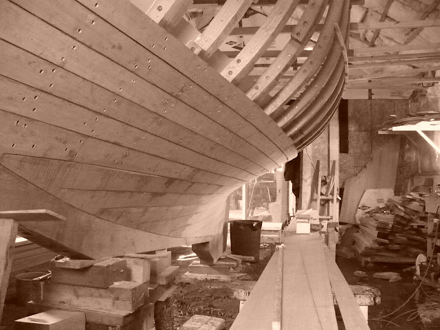

    Thanks john that give some ideas... Hung under plank today it's nice to see the shape!
    Looking forward to see yours getting build... Any thought of when it's gonna start?

    Thanks steve nice tricks.. I actually never plane small stock, this board was about 23 inches long I plane before cutting for the reason that you've said(But it's nice you've said it for preventing it!). It's really the cutter digging in, I will try to take a picture next time i go to the shop, the grain really curve 75 degres in the last 1" of the board right the same angle the cutter enter in the wood(Old blade probably didn't help that either!).
    I've open the thickness planer and found oak that went between the blade and under, bending the whole thing...
    The planer is fixed now... Just waiting as I do have 3 more planks ready to cut and looking forward to put them in! Why you don't come here giving me a hand, I sure would need one more

    As I have plenty of spare time today, I've made some research about end-grain planing and found this:
    http://www.thewoodwhisperer.com/arti...comment-161461
    Ok mine was not what I wanted but I did make several cutting board with end grain on top... After this incident and reading about it(Look also all the comments filled with horror story)... I think it's worth it to share the warning...

    Ok here a picture of the bad end which give me trouble... I should have noticed that curve, but you know was just working fast to get it done...
    As you see the blade enter right in the angle of the grain curving, you can see that the blade dig in and not cut it.
    (For those that wonder, I've cut the end off for the picture)
