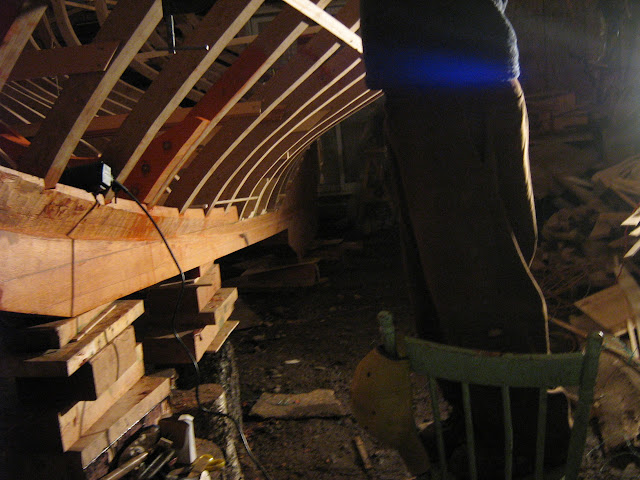

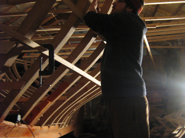

    This one is playing a bit with the camera to get the whole boat, it didn't worked perfectly but it give a interesting shot.

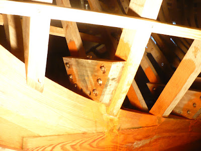

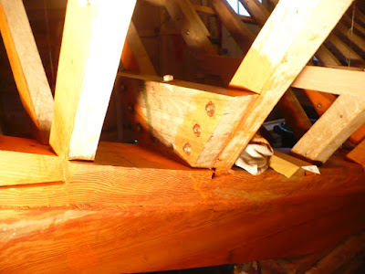

    Here the floors bolted. The bilge gonna be painted so I do not care much about the look for now.
    The red is red lead painted everywhere before fitting pieces together, the green is poison that I pour down the hole before putting a bolt in.
    Bolts are 3/8" Silicon bronze for frames/floors and 1/2" floors/backbone, the fits are perfect even a cigarette paper won't pass anywhere. 3 floors bolted, 2 more will be tomorrow (Red lead drying).
    The big laminated floor is not bolted yet, the mast step will be notched on it with 2 others. All floors above the ballast will be like this one.

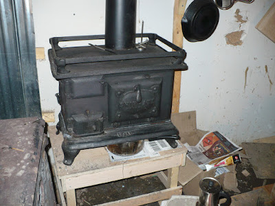

    Our shipmate stove in the corner to heat up some drink when working
    Oh yeah.. The limber hole are higher then the backbone on some of the floors. This side of the curve will be filled with tar, the other side is ok. The reason was the bolt going to the backbone is right in the middle and the framing space was too tied at the backbone level.

    Hey Capt. Z.
    Good idea about the mix for the cast iron, will try this mix for sure! Maybe we will end up with descent tools on board
    Mallet on a lath, I didn't know that fancy side of you Sure would love picture of it!
