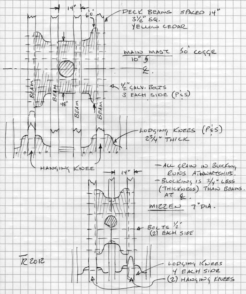

    Hey Cap.....sorry if I'm a bit late with this, I had to go out to the boat and use a measuring tape to make sure I got it right. The partners can be a complex structure, lots going on.....
    Our boat is of a similar size to yours and built of a mix of PNW softwood (Yellow cedar sawn frames, beams, stringers) and South American Hardwoods (the deck is planked with 1.75" Ishpingo). The partners seem to be hardwood similar in grain to mahogany, dense, fine, and clear. The drawing might explain it best but the grain in the partners runs across the boat so side loads from the mast are taken by the end grain for minimum wood crushing. The blocking is let into the beams slightly to lock it all in place. The blocking is all flat on the bottom and shaped to the deck crown on top. I know she is massively overbuilt by today's engineering standards but this allows for rot which we have plenty of......
    Around the mast the deck planking is replaced by a boss that swells the thickness to about 2.5", so at the main mast there is about 6" of solid wood taking the loads, this is necessary for softwood spars.

    What Tad said
    If your boat originally had a plywood deck and you are sticking to the same dim on everything I would think real hard about switching to a laid deck, you might consider t&g with ply glued over it then a faux layer glued on the ply of you want the wood top.

    In the sketch you show Tad, do you think this arrangement is prone to possible trapped water issues and rot, lots of joints and holes in the beams all under the deck.
    Schooner Sassafrass Rebuild Blog Web Album
    Hi Jake......Do I wish my boat was built differently? No....well maybe, but anything will rot if you let fresh water get in. This partner layout is pretty traditional, I can find versions of it on LF Herreshoff and Bill Garden drawings. Just without all the lodging knees and not quite as massive. No, I don't wish the boat was built weaker, I love just sitting and marveling at all the bolts........It could be simpler for sure. But Bob Prothero was running what he termed a "master" school of boatbuilding, I guess a simple solution wouldn't cut it. I had a deck plank over this blocking up last summer, the deck seams had been leaking for years. The Yellow Cedar beam was going soft on top but the blocking around it was sound as a nut. We'll start pulling up sections of deck and changing beams in about 10 years......

    Thanks Tad and pardons Capt Z. for sidetracking, a new deck should happen for us before any serious offshore time and I want to think of any potential structural changes that will happen then, if you go for the big thru bolting Capt Z don't go buy some exp long bits just find a welder to weld some 3/8 steel round stock to the ends of a couple of your bits, the ends of most HSS and other drill bits are not hardened so they are fine to weld a extension on.

    My Internet was out for a couple of days and I could not get on line, I'm back now. Tad, the drawing and explanation is awesome thanks so much. I am working on incorporating in a layer of wood with the grain running athwart ship as it makes sence from both examples. Jake, I am not sticking with the same dem, fact is (for me) plywood belongs in packing crates, not boats that are expected to last years and years. I had two major problems in my hull undersized steam bent ribs, that were all busted to hell and back. And plywood bulkheads and cabins that were petre dishes for rot spores. So the plywood is gone and I have grown frames and beams and will lay a traditional straight plank deck. Lots of changes! Pilot house instead of open cockpit, two steering stations (one inside and one outside), new layout below, losing the raised cabin, new mast heights, raking the mast, new sail plan, you know nothing too drastic or big! So anyway thanks again both of you guys your input has been most appreciated. So now I am off to install some more short beams. Please keep the coments and suggestions coming. I'll have new pictures soon. Capt. Z.

    Every construction style and detail is part of a system, and all the parts of this system must work together. If there's no plywood in the deck supplying the diagonal bracing something else must be added. The diagonal metal strapping by Herreshoff is one solution, massive blocking (as above) and lots of lodging knees is another. We have no plywood in our boat yet but 17 lodging knees (and about 8 hanging knees)each side of the boat. There is a lodging knee each end of every deck opening, forehatch, chart house, galley hatch, and aft skylight, plus those at the partners and two at the deck break. It adds up to a lot of wood and bolts.

    Tad, thanks again for helping out, I agree completely with what your saying.
    I have twenty four knees on order from my wood guy, and hopefully will be getting them soon. I do understand not mixing construction styles and I have chosen to rebuild traditionally from the keel up, so hopefully she'll float when I'm done. I have been getting the lions share of info for this rebuild from the books by Chapelle, McIntosh, and Pardey, and then what I can glein from other sources like this forum. So advise and critiques are always welcome. This morning I got another short beam installed and hopefully will be able to get another one this afternoon. If I get it in today, I will only have 14 more to go!, then I will dive into the blocking and knees. Wish me luck. Capt. Z.

    Always good to hear from you Jake, Did any of your 'run from it' type posters ever come back and say that you did all right after all? I hope mine looks as good as yours some day. Now in an effort to "keep the pics coming!!" here is a couple of shots of me making paper patterns for the knees that I am planning to go next to the partners
    I laid some old bolts and sticks on top to show where it would be through bolted. The inside part against the short beam is 12 inches long and the long out side length is 22 inches long. I am guessing that this is long enough, it would make the combined length 71 inches long athwart ship.
    And the underside view, you cannot see it in this picture but that blue sky is blazing HOT, by nine o'clock in the morning I was soaking wet in sweat. Today, despite the heat, I got the foremast partner in as well as the other main mast short beam that you can see in the picture with the paper patterns.
    Jake, I was under the impression that if I were to install a king plank, in this case about 21 to 24 inches wide with an half inch recess over the beams, that king plank would replace the blocking needed between the mast beams and the carlin beams and the beams in between those two. Tad? Do you want to weight in on this? If it does not replace the blocking I need to make some changes in my plans, quick! Waiting to hear what the crowd thinks. Capt. Z.

    Any reason why you couldn't go belt and braces and do both anyway? It'd reduce any possible risk of twist of the whole thing, within those three frames, for and aft that the king plank might not be thick enough to cope with......probably unlikely but would there be any harm, other than extra work, in being sure while you have the chance?

    I think what you are saying is that you are going to cut into the bottom of the king plank over each beam 1/2"? If it were me I would do the blocking and keep it independent of the deck planking but your plan should work too.

    Thinking about loads........The centerline blocking between beams is there to spread the fore & aft compression and sheer load from the mast. Imagine running off in a gale and you can't get the sail down or you're being chased by pirates....(See J Slocum).......There's a smooth bend in the spar from head to step, in the middle are your partners being pushed both aft and sideways. The strength of wood is different depending on grain direction. You have the end grain (strongest direction) of your longitudinal blocking pressing against the side grain (weaker) of the beam. Thus I would look to maximize that contact area, lowering the load on each square inch of side grain. I guess I don't think 1/2" by 24" is as good as say 2.5" by 24". This is an area where you really do not want any movement ever! Thus overbuild. If the blocking is almost full depth (molding) of the beam it (the beam)cannot roll even though it's mainly fastened on top (deck spikes).
    Maybe one thing you could do without changing too much would be to do the king plank as planned, then add some small (2" by 10") underneath and between the beams? Not sure on the fastening though, perhaps drifts from one end........This blocking should always be let into the beam from the top with a shallow (1/2" max on top) wedge shaped socket.

    Tad. That makes sense. I can visualize the strain on the deck beams causing them to twist from under the 1/2 inch slot of the king plank. So I am taking your advise (as well as Jake and Larks) and will add in blocking under the king plank. If I run the grain for and aft I could cut the blocking from the same wood as the mast partners in the same dimensions so that the visual line runs all the way across the overhead in the saloon, from the entry port to the butter fly hatch and then continue from the fore side of the bfly hatch up to the bow. I will let it into the beam 1/2 inch from the top like you said. But as to the fastening, becuase I can only get at one side, what do you think of drilling a hole all the way through the outside of beam and the block and then halfway through the far side beam, then cut a four inch long piece of 3/8 steal rod and drive it through the hole with a 5/16 steal rod as a nail punch. Then drive a normal 3/8 spike with a head in the hole from the drilled side. This would have both sides nailed with an empty hole in the middle between the two spikes. I could drive a wood dowel into the middle to fill the void if it really made a difference. This would be nailed in place, but it would have no compression as it would if it had been bolted into place. Does that seem strong enough? Thank you again for your help, Capt. Z.

    Your method will work but properly installed "drifts" will be better. I gather this is pretty hard wood you are framing with, thus the holes should be only slightly smaller than the rod diameter. I would do a single rod full length, through the beam, blocking, and 3/4's of the way through the next beam. So for your 3/8" rod try drilling holes at 11/32" or 23/64ths.......Hammer a short point on the drift and slip a washer on it before hammering in, when it's in all the way peen the head over the washer, if done correctly these hold impressively, almost like a bolt. Oh and you can countersink the washer and head out of sight into the side of the beam........Keep hydrated in all that sun!

    Thanks Tad. I am going to do some experiments to see if I can make the right hole and drift diameters in some scrap wood before trying it on the build.
