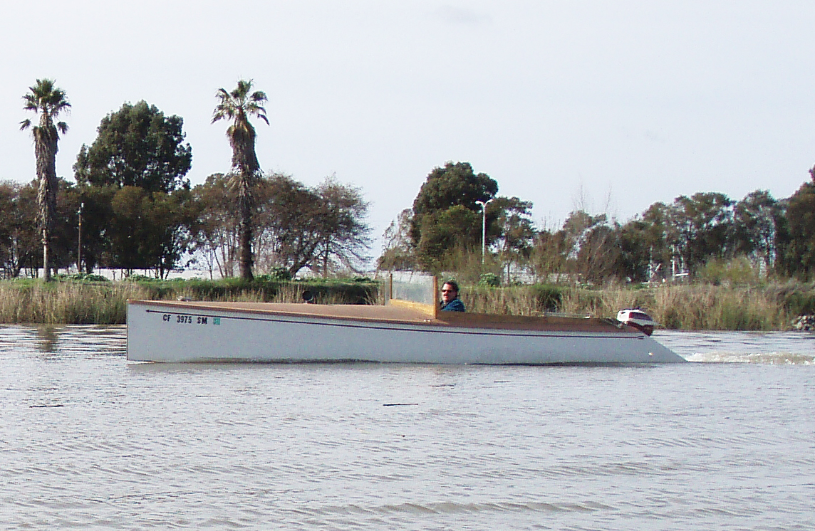

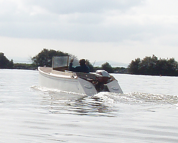

    From the build logs at www.slipperlaunch.net
    As I said, there are lots of great books on hull/boat design. Since you want to learn basic design elements, that will be your best route. Many interesting things go on when wood meets water...
