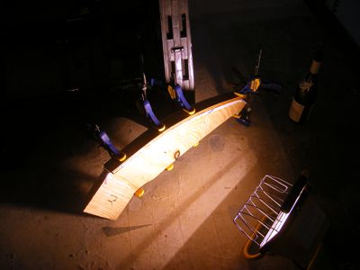

    A rather inauspicious start for my next project, a 16' Barto/Brady Melonseed. With the model done and the temps finally getting above frigid I made it to the shop and got 16 slices of 3/16" black locust cut for the stems. I brought them and the epoxy (West system w/205) into the basement (fairly constant 55) and gooped and clamped them.
    I returned 2 days later and it looked pretty good, I unclamped and began to clean it up. I was feeling pretty happy getting the first part of the boat underway until I was just about done, of course, when the laminations gave up interest and starting going their own way!
    I've never experienced epoxy failure before, and was glad that it happened now, rather than on the boat, would be even better if it never happened! Thinking that maybe the epoxy was cold soaked when I brought it to the basement, even though I gave it hot water bath, I cleaned up the veneers and reglued just the inner stem (6 lams) this time. Clamped it overnight (55 again) and in the morning it looked fine. Until I returned a couple of hours later to find this:
    Can epoxy go bad, it had been cold soaked all winter? Did I not clamp it long enough for the 55 temp? Gougeon says problems can occur below 40 degrees with 205. Well, it was fun to start. Won't be quite as much to restart.

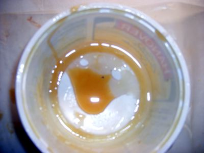

    I have done a lot of epoxy work with BL....and I have had a few failures. I know the late Dave Corcoron of Bullhouse boatworks also made a lot of his hereshoff backbone pieces from epoxy laminated BL. For me, every time it has happened the epoxy and wood it was in contact with took on the deep reddish color tone I see in your picture. It has only happened for me when the I was pushing low temp work and/or when the wood was not fully dry....I simply won't use sub optimal conditions anymore. I think under those conditions the epoxy begins to react chemically with the locust before it cures out...but it is just guess work on my part..I have pushed other woods under the same iffy conditions and not had problems.
    It's a rough image you posted, but to me the cured epoxy looks pretty off color. Sometimes you can get that with old hardener, and I have been told it is harmless. But you can also get that with a bad mix with too much hardener...like when the pumps clog or the resins are too cold/viscous.

    Reddish color! I just opened a new can of 205 and it was obvious that it was a different color from the old can. You might be able to see it here, the old stuff is the middle the new just the right, barely an amber tint.

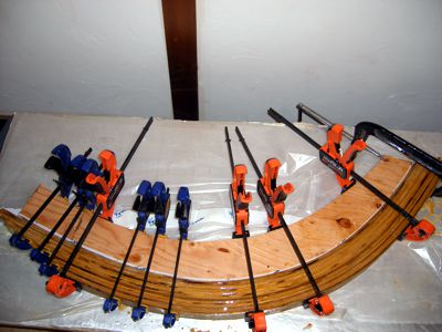

    So I've taken almost everyone's advice, sanded w/80, cleaned the pumps, warmed the epoxy and now I've reclamped just 3 lams around a frame mold and I'm leaving it for a couple of days. I'm hoping it was the discolored 205, which was maybe 2 yrs old, but stored in an unheated shop.

    Is the old can not perhaps a West Systems 207 hardener? It has an amber color ... http://www.westsystem.com/ss/207-spe...lear-hardener/
    The 105/207 mix ratio (3:1) is not the same as for 105/205 (5:1) ...

    >>Is the old can not perhaps a West Systems 207 hardener? It has an amber color <<
    No, it says 205 on the side of the can. Same stuff I used to build the last boat. Plus I've never purchased 207, although I almost used the 207 pump today as a replacement (it comes in the same mini pump package.) I've had epoxy for longer but don't ever recall seeing the color change. And the cap/pump was never removed.

    The orange hardner will work fine, that's just showing age. However, cold viscous epoxy + pumps + trouble! Warm it first and confirm the pumps are delivering the right amount. The pumps are cheap. I replace mine periodicly.
