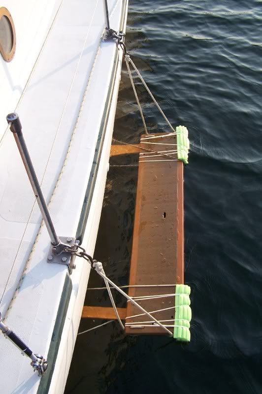

    I thought I'd document some boat details.
    Here's the Swim Stage. It's a wonderful design, and I've never seen another like it. Snap-on, snap-off.
    Since Drake has an overhanging stern, the swim stage is our only way to get back on aboard from the water. It's a wide mahogany plank. Underneath it are 2 stainless steel channels, into which slide the spacers that hold it our from the hull -- so it's a take-apart. These spacers are cushioned with 1 1/2" plastic pipe around the ends against the soft cypress hull planks. The pool-noodle fender bits are not usually on it, but I was using the stage to rig my sailing dinghy that day.
    It's rigged right at water level.

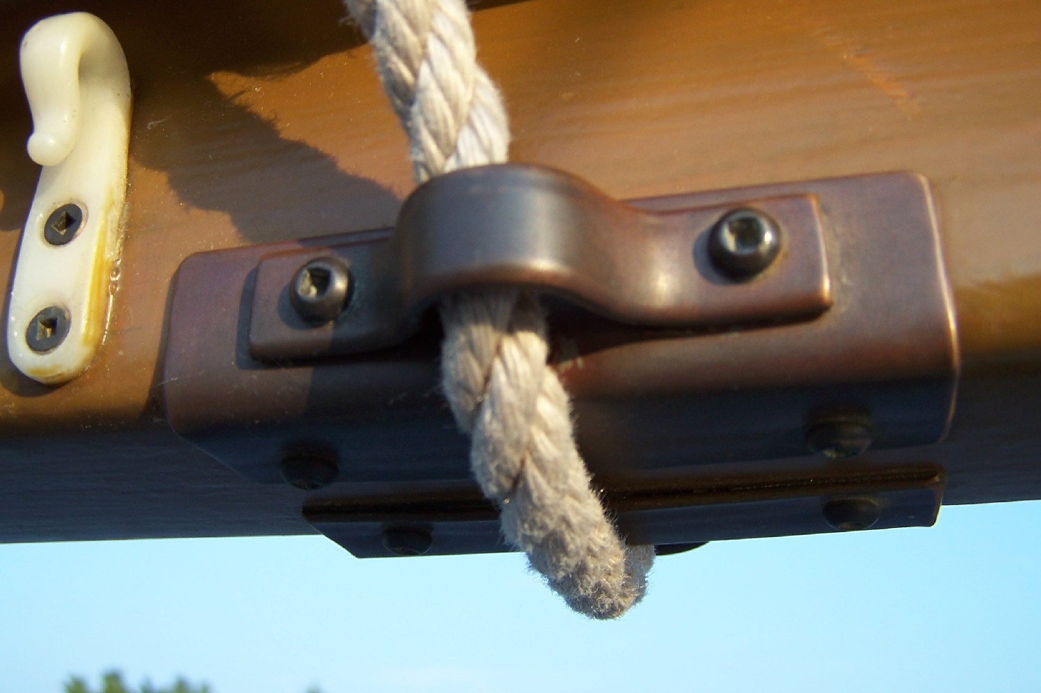

    More beaten copper: lazyjacks; very useful on a ketch, otherwise you tend to drop the mizzen, and sometimes the boom, on the helmsman's head. (I usually take care to hoist them evenly, but apparently I didn't that day.) There are a pair of halyards for it, linked by a large bight which is the part that goes under the boom. Each halyard is separate, leading from the masthead to a cleat on each side of the mast.
    And for the fitting to take the line around the boom, to revent chafe, again I used simple copper pipe or tubing (in this case both), beaten flat and polished. These pieces never got the clear-coat, and thus they take a patina which I don't mind at all.
    I don't like the plastic hooks. As they break I replace them with... hooks made from beaten copper!

    Drake has standing backstays, but I changed them to include these large pelican hooks. The reason is it's handy to be able to set a mizzen spinnaker or a mizzen staysail (obviously forward of the mizzen). Usually the main backstays are in the way. But Drake has 2 separate backstays terminating at the mizzen chainplates, not a single backstay that divides to a bridle. Thus, by using these hooks, I can disengage the slack, leeward one, clear the space, and hoist the new sail.
    The hooks came from Holland Marine. They're of 1/2 in steel. They don't end up as tight as turnbuckles, but so what -- running backstays don't have to be bar-tight. Drake has a triatic stay to keep the forestay taught. These backstays are more like insurance.
