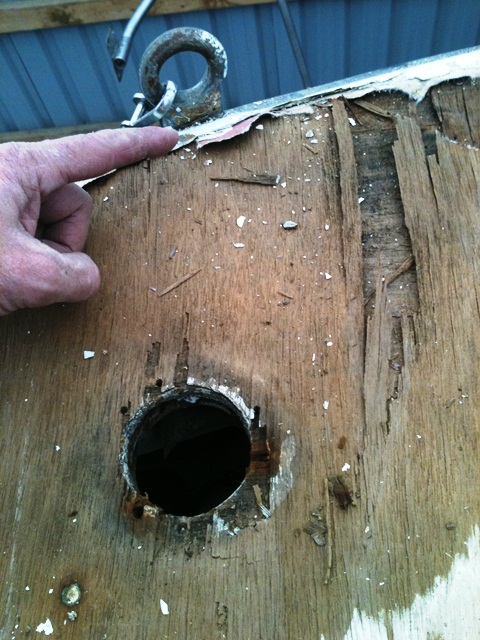

    Well I've been putting it off, but every quarter century you really should re-paint a wooden boat.
    Being planked with cypress, it really is a battle trying to keep the paint from flaking off. For the last 10 years I've been trying to get away with touch-up, but this spring I decided to get back to wood.
    Here's a section of the bow, the Before Picture.
    So I employed my trusty paint stripper -- fire -- and set to work. (For any larger surface I'd recommend a bigger, softer-flame torch. A friend of mine at the boat yard recently used the shrink-wrap propane torch -- perfect.)
    And then attacked the boat in sections, as time permitted.

    Here's the prime culprit. This was the fore chainplate and the pump-out fitting hole. There was no sign on deck that water was getting through that fitting. Water was getting in at the chainplate by running down the shroud, then going through a crack between the chainplate and the deck-covering, and into the edge-grain of the deck plywood. Delamination. And debonding from the deck covering.
    The reason there isn't much rot is that it's open underneath -- only one side of the plywood is sheathed. If it was encapsulated, like a fiberglass boat's deck often is, it would have been muck many years ago.
