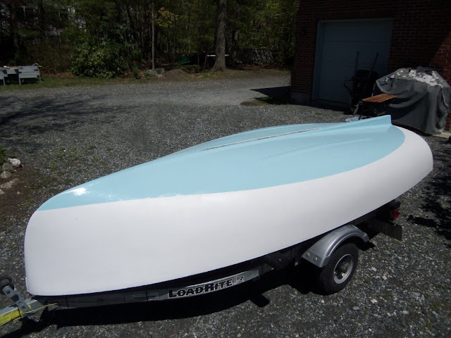

    Ok, first coat of the Brightsides is on. "Sky Blue" or something like that, $10 a quart. I will put on 2, probably 3 coats of this.
    I like it! I like it! Brightsides is awesome. Roll and tip.

    Default Re: Fiberglass dinghy restoration, some advice please.
    Beautiful! Looks brand new. Brightside is very nice to work with indeed. Good price for a quart! Here they go for about 40-50 bucks for a quart.

    Quote Originally Posted by Rik van der Vaart View Post
    36-41 around here, but this is a super-old can that looks straight out of 1986 in a discontinued color.

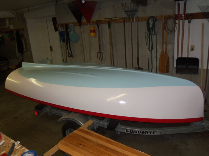

    First coat of Blu-Glo white and Fire Red.
    Centerboard in foreground with last coat of epoxy. Ready to install bronze square and then paint blue.
    Ohhhh baby! That makes my heart pound! Awesome. How long for the dip 'n splash?
    I don't know. Depends on schedule, weather for painting, and my sail, which... reminds me I still haven't heard a peep from the sailmaker. I should call.
    I just picked up some very nice Port Orford Cedar for the thwarts. It is nice and smooth and should weather very nicely.
