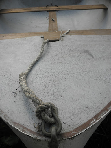

    Now, the rub is that I don't know anything about fiberglass repair/refurbishing. I would like to clean it up and make it nice again. The fiberglass is spider webbed and cracked pretty good, and I'm wondering if it's possible (most likely), and what kind of work is it going to take? The hull is sound, no soft spots, it's just the surface. I'm assuming a good buffing, filling the cracks, some sanding, buffing, and a new paint job, but I really don't know. I have a book on the way about basic plastic boat maintenance. I am on a pretty tight budget this winter, so if in your opinion this is going to take a lot of money and time, I will postpone it for a year or so.

    I'll guess you'll want to wait, save your sheckles and do more learning about fiberglass and gelcoat repairs.
    I **think** you've got a badly cracked / aged gelcoat surface there, and will need to sand and recoat. I've never done full gelcoat coating, just minor repairs, but gelcoat is a polyester resin -- not the standard epoxy resin used for the actual hull construction. From many posts here, it seems that while gelcoat will stick to epoxy to a certain degree, it doesn't stick to a lot of other materials, which is why it's use as a coating over wood was discontinued decades ago when real epoxy resin became more affordable.
    For a quick 'n dirty fix (not recommended) you could try sanding & cleaning, then a high-build primer, then paint. Or even marine bondo to repair the surface cracks - but that is not usually recommended.

    First of all, the entire boat is built with polyester resin - both the gelcoat (polyester resin mixed with pigment and fillers) and the plain resin saturating the laminations of fiberglass cloth and mat underneath it. For widespread areas of old cracked gelcoat, there really isn't any particularly good way to fix the hull just by "crack-filling". Each crack would need to be opened up with something like a small, cone-shaped grinder bit on a Dremel tool to make a trench and then they could be filled with new gelcoat or a filler mixture. This is OK if you only have a couple of cracks to patch, but not worth the hassle when you have a whole boat to do. It's usually less work to grind (sand) the gelcoat off and re-coat the hull - either with fresh polyester gelcoat, polyester resin and paint or with an epoxy resin mixture, also followed by paint. It's a lot of work, but not all that difficult.
    Unfortunately, you can't re-coat or paint over cracks and wind up with what would be considered a sound, lasting repair, even if you can get the new coating to bridge the cracks. They'll probably open back up. Plus, with all that filler in it, gelcoat isn't always particularly well attached to the hull and old gelcoat tends to flake off, taking whatever you happened to apply over it with it. So the first big job is to get out the disk sander or a good random orbit sander, arm it with 60-80 grit disks and sand off the old gelcoat until the cracks are gone and you see solid, smooth fiberglass (most likely kind of green-ish in color, but it depends upon what sort of promoter they used in that particular resin - could also be brown-ish, pink-ish or blue-ish). You will also likely start to see the white-ish weave or fiber pattern of the fiberglass fabric starting to show and that's a good sign that you have gone far enough in that spot. On a boat that size, the gelcoat removal job is probably a couple solid afternoons of sanding.
    Once the gelcoat is gone and the hull is smooth and crack-free, you will need to give it a new "skin". This can be done with new gelcoat, but it's not a very good home-project. Gelcoat needs to be run "hot" (lots of catalyst so that it sets very quickly or it will peel and curl) and for even coverage on big areas, it almost has to be sprayed. It needs to be at least about as thick as a dime - plus enough extra thickness to sand and polish it smooth because it tends to orange-peel pretty badly on the surface. When you combine that with the fire hazard, toxic fumes, messy clean-up, etc. It's not worth fooling with unless you're in the business of re-gelcoating boats - so we'll go to plan B.
    Plan B - Polyester Resin skin, plus paint: This would be adding a new skin by rolling on several coats (3-6 depending on your rolling style, the particular resin used and the temperature) of plain polyester resin. These are done rapid-fire, with the next coat being rolled on as soon as the previous coat is stiff enough to support it. Polyester is air-inhibited. Unless sealed off from the air, its surface will stay a bit tacky to improve the bond of subsequent layers. (this is what's known as "laminating" polyester resin). There is a second type called "surfacing polyester resin" - or "waxed polyester resin". It had a small amount of wax (paraffin dissolved in styrene monomer) added to it. While hardening, the wax floats to the surface, sealing air out and allowing the surface to harden tack-free. You can either make all your coats with unwaxed resin and add a little bit of the wax surfacing agent to the final coat to finish it off - or - you can do them all with waxed resin. In that case though, you want to be sure to do the coats as rapid-fire as possible. That way, the wax from a previous coat will then float up through the fresh coat too, rather than trapping a layer of wax between the various layers of resin. No sanding is done between coats and most of that afternoon is spent watching resin harden. The rolling itself is a pretty quick task. After all the coats are applied and have hardened for a few days, a couple hours of sanding will eliminate any drips, sags or runs, leaving you a nice smooth surface that's ready for the paint of your choice.

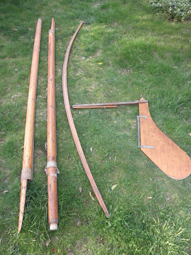

    While taking the sail track off the mast I've broken several screws. I'm not surprised, they are 60yrs old and some are badly corroded. The breaks are deep and the screws small. Even with a 5/64" bit for a #1 extractor, I can't keep the bit from sliding off into the screw into the softer wood, so getting a pilot hole in the screw is a real pain. Anyone have any tricks to removing small broken screws from deep inside a mast? What about pounding them deeper into the mast and filling the hole afterwards?
    Also, would a track from this era be made of copper or bronze? I can't tell the difference on this one. Would silicone bronze screws be the way to go to mitigate corrosion, etc?
    Apr 1999
    West Boothbay Harbor, Maine
    20,324
    Default Re: Fiberglass dinghy restoration, some advice please.
    I'd plug all those holes and shift the track up or down enough to screw into good wood. It won't make that much difference to the rig. Round head bronze screws will be fine. The track is most likely bronze. Copper would bend too easily. Good luck, and please do post photos.

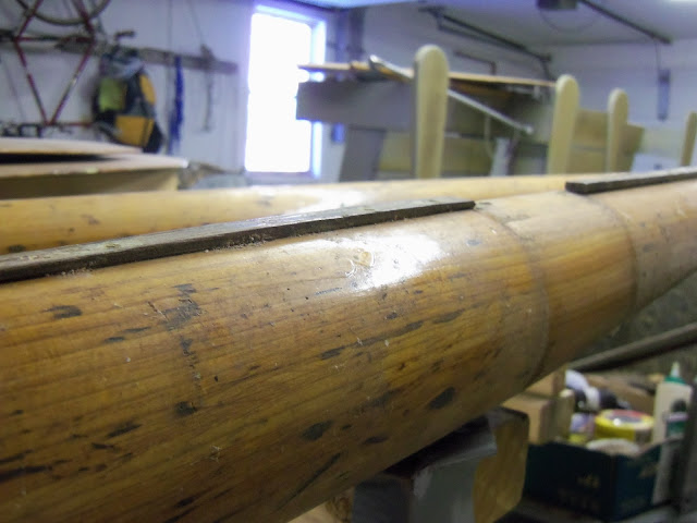

    I'm starting with the masts first. (The mast pictured is my GIS mast, fyi) They are some sort of light softwood, spruce probably, very light. They are two-piece construction glued together. The varnish is in good condition, and the mast has character bruises underneath. I'm not going to strip it, but give it a light sand and put 2 or so coats of new varnish on top. First though, I stripped the hardward off the mast and labeled things. Labeling things is prudent. I usually never label anything and then I'm stuck trying to put things back together. The smaller of the three fiberglass sheaves is the rub collar for the mast partner since the mast is a free standing and rotates with the sail. The two others are the collars for the two part mast to join. As you can see, simple rig with little else to it.
    The masts have these neat little wood shims for the tracks to elevate the track over the fiberglass collars. I left these on since they seem glued on. One is a little loose, but a little bit o' Titebond and varnish and screws will take care of that. This is only one mast, but both pieces have them.

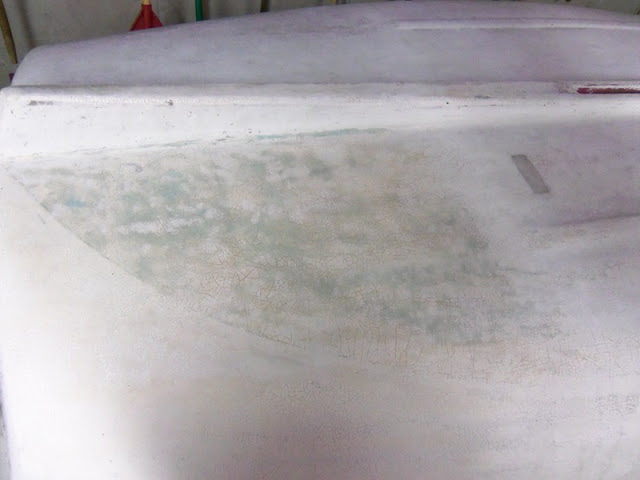

    So, I did some sanding on the hull today with some 60 grit. Not long, about 20 min or so, and I just hummed along in one area seeing what would materialize below the white.
    Apparently, at some point green bottom paint had been applied:
    I had knows that in the past there was red bottom paint but I never knew about the green. The red can still be seen in the cracks in the coat--
    and I must say the surface is all very smooth.
    Why would I not want to sand this boat down to almost smooth, like this section, and then use a high-build primer, like Interlux has, to fill in the cracks? A few coats of that would do the trick, would it not? What would be the cons to do that, as opposed to sanding the whole thing down to glass itself and then applying several coats of barrier-infused epoxy? Seriously.
    Don't sand more than you have to. If the old gelcoat is firmly adhered thats basically all you need to do, but first, areas of exposed glass need to be re-saturated with an unfilled resin that can soak into the fibre. Including the inside of the cracks.Next, fill the irregularities and cracks with epoxy thickened with an easily sandable filler. Sand the hull fair and apply the Interprotect 2000.

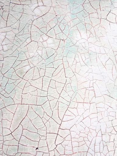

    The cracks are so shallow, it would mean I would be coating the whole boat with epoxy over the gelcoat. Is this something I want to do? I figure if I coat the boat in epoxy I should bring the whole thing down to glass instead of bonding epoxy over the gelcoat, that's why I was thinking going with the high-build primer idea over the gelcoat instead, which would fill the cracks for a smooth finish (in theory).

    Rik, I agree completely and the interprotect 2000 would be that continuous layer, however bearing in mind that this is a VERY early FG Dinghy weighing twice as much as a modern boat and the gelcoat has been on there for half a century it probably isn't going anywhere. It is badly crazed from age, not stress, you can tell by the pattern of the cracks. Stress cracks look like spiders webs, radiating from the point of pressure. This mud flat looking pattern is caused by shrinkage. Stress cracks must be opened up with something like a dremel tool to ensure resin penetration. If stress cracks have been caused by flex, than the structure needs reinforcing on the inside of the hull. This boat will not live in the water nor a museum, and to obsess on perfection in restoring her would be silly, create a considerable amount of toxic waste, require pointless labor, and needless expense. I believe Callsign222s' priority is to go sailing(and maybe for a row or two).
    The barrier coat of Interprotect 2000 will stabilize and bond what remains of the original surface. I have a lot of experience with Interprotect 2000 and have found it to be an excellent product that lives up to its claims. There are other brands that are similar but I have no experience with them.
    And Callsign, before using the Interprotect,I would still try to get some thin resin into the cracks before filling them with epoxy and sandable filler like micro balloons, not the colloidal silica or cabosil some one mentioned above. Filler must be softer than the surrounding gelcoat or it will not sand evenly. I2000 is hard to sand, as it is reinforced with glass particles.

    Some progress. The hull has been sanded once, and it will be sanded again one more time. Today I shaped up the centerboard (NACA shaped to Storer's jigs) and dropped it in the slot just for a look-see.
    I also took apart the old centerboard and freed this bronze piece that the centerboard handle slides into. It has a "14" stamped on it. I will screw it in place instead of pounding bronze rods through it like the original.
    So next up I will glass the centerboard, install this bronze thing.
    The boat needs another sanding and then I will start to apply the barrier coat and the paint. Interior needs a sanding too.

    I have not faired the hull yet. That is coming after the 2nd sanding. I'm going to use Interlux Epoxy Primekote. It will fill these very shallow cracks a bit, and offer a barrier layer of sorts. (and it was the right price!!!)
    The bronze parts-- the square is inlaid into the centerboard, and the centerboard lever-control-arm slides into it and is friction locked in place on the outside of the trunk with hardware that is not shown. I will take a picture.

    Here you go. Male piece, female piece, and there's some stuff to hold it all together.

    It looks like your centerboard is in backwards.. shouldn't the lower edge be parallel to the keel?

    Quote Originally Posted by G.Sherman View Post
    I was wondering if the "naca foil" was laid out and built for vertical , not 45 ish degrees?

    Quote Originally Posted by wizbang 13 View Post
    I think the board foil shape is correct and the bottom edge is also appropriate. The pic shows some slot ahead of the boards leading edge, which makes me think it isn't fully down, which would make the NACA profile correct.
    The pic in post #1 shows the angle of the aft end of the trunk, which seems to correspond with the shape of the centreboard. The leading edge has to be the length it is to fill the slot when raised, and the trailing edge length is dictated by the radius of the boards swing. Any longer and it would contact the aft end of the slot.
    I like the heavy-duty bronze lever fittings. I think I'd make a new handle for it though, that one looks like a replacement anyway. Might be nice if the handle had a ball head to match the casting.

    Full Tilt is correct, the end of the board is shaped such to fit the trunk. Trust me, it's correct.
    The board might actually extend more than shown, I just placed it in the trunk for a visual and taking pictures. The idea that the foil might not be completely in line with relative water direction could definitely be correct, but it will be far better than what used to be there, which for all purposes was a plank of wood. I'm not looking to win races, just to improve low speed handling on a lee shore, for instance... and an excuse to use my hand plane. Not a biggie. It looks sharp.
    The handle is actually in great shape thankfully, I just need to strip it and sand it and give it some varnish.

    Ok, so I've just applied three coats of Epoxy Primekote to the previously unseen and unknown waterline. I will paint this area first, and then work on the rest of the hull. Since I had such a nice waterline available, I didn't want to lose it under the primer and then have to redraw it myself.
    Here she is with the lines taped off.
    Three coats later:
    Tomorrow I will get the first coat of powder-blue Brightside onto this area. At the Maine Boatbuilder Show, Hamilton Marine had a sale going on, and we found some uber-cheap powder blue Brightsides-- perfect! About 10 bucks a quart, if I remember right, and it's almost the same color as what was applied in decades past. A good find.
    Now, the cracks are mostly filled. Some are not, but it's significantly better than what it was. Additionally, everything is definitely sealed tight now, which is a bonus. The Primekote calls for 2 coats, but I went with three, each one thinned slightly less than the one before to get the best coverage possible. I will have to buy a new can, which is not awesome budget wise, but is required, I think, due to the gelcoat cracks.
    The centerboard was glassed last night-- though I still need to cap the ends and fill a little more weave.
    That's all for now. It's been a super-dry spring, perfect for varnishing the spars (done) and I have a new sail on order at Withum Sailmaker in Amesbury, MA.
    Now it's pouring and I have lots of days off but the paint is taking forever to dry. Until next week.
