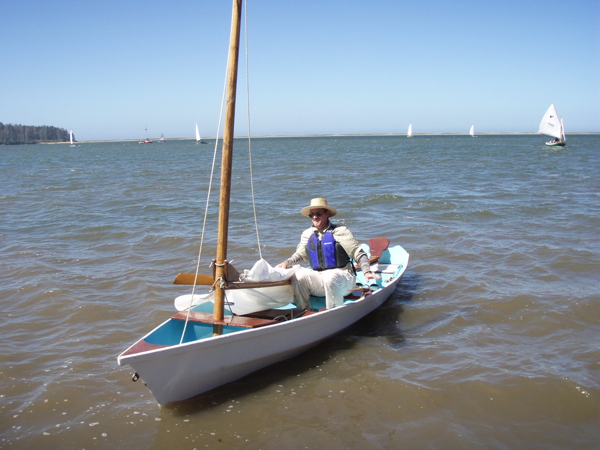

    Something small enough to be towed by your larger boat and still big enough to be a useful 6 hp daytripper in its own right might be the sticking point. Do you like this?
    She can be built as a pure rowing/outboard motor dinghy for fishing or use as a tender or she can be fitted out as a sailing dinghy.
    11.5 feet long, weight under 100# http://www.selway-fisher.com/Other1013.htm
